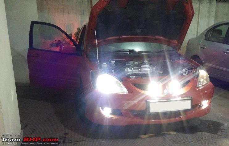

Meanwhile, I replaced the stock foglamp projector with bixenon HID ones. I now have a total of 6 projectors on my car hehe, although only 5 are operation as of now.
Auto Lighting thread : Post all queries about automobile lighting here-img_20170204_190327.jpg
https://www.youtube.com/watch?v=Rgp1JsEPSpY
I had made a silly bet with a friend saying that I can put 8 projectors on my car, simply because I can. I'm just a pair away, pretty soon I will reach my target :p
Holly molly! The saving grace is all of these are HIDs in projectors housing. Else I think you are running a riot on the road! I am crunched on the budget but one sure day, want to put up the extra projector lights as AUX on my XUV too!
