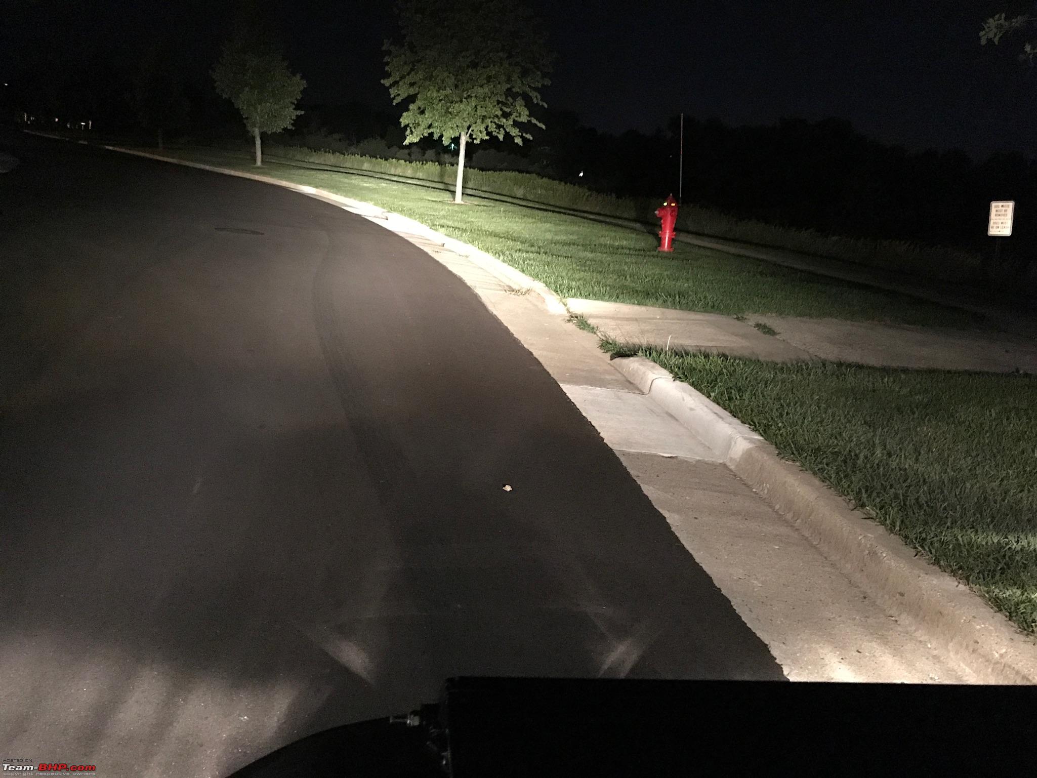

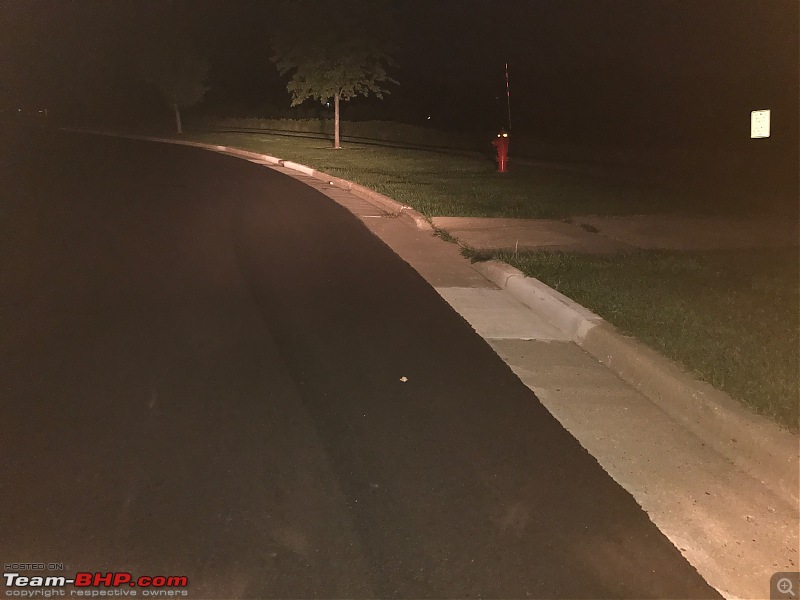

I recently bought Aurora 20" S1 single row 100W led light bar with combo beam pattern. I was supposed to move back to India and wanted it on my next car back home, however, plans are on hold right now so I decided to test them out. The lights are little too white for my liking but that was expected as it was rated at 6000K temperature.
See technical details below along with pictures:

Headlights(Low Beam)+Fog Lamps
Auto Lighting thread : Post all queries about automobile lighting here-01bb345c985c1451c833c5187d08416c23fd0beab6.jpg

LED Bar+Headlights(Low Beam)+Fogs
Auto Lighting thread : Post all queries about automobile lighting here-0177486749452a8bc114301677e0268b41e0c34223.jpg
I dont understand how you could use this on the road. This is better suited for off road applications. That Hotspot in the center will actually make the rest of the road darker which will be a safety hazard for you. These light bars are a perception that the excessively bright illumination will make night drives better. But it is just making things worse since your eyes will adjust to the bright light and whatever is out of the lit area will be unnoticed. Always prefer homogeneous beams which give an even spread of light and doesn't create a strong contrast with the surroundings. In this case even if the overall beam is dim your eyes will adapt to it. I wouldn't buy such a contraption for on the road driving even if I am paid for it.
I do share your concern and I have no intentions of making this a hazard for me or other road users. The first image with hyperspot focus close to the vehicle is not going to be the configuration I will be using, it is only for demonstration. The purpose of hyperspot is to throw light beam at distance and my intended use of this light is only for off road/no traffic situation.
I would also like to see it making a difference to driving in foggy conditions, being from NCR region I have hit that white wall with zero visibility on numerous occasion :Frustrati. I do not want to drive fast but hoping for the drive to be less stressful.
