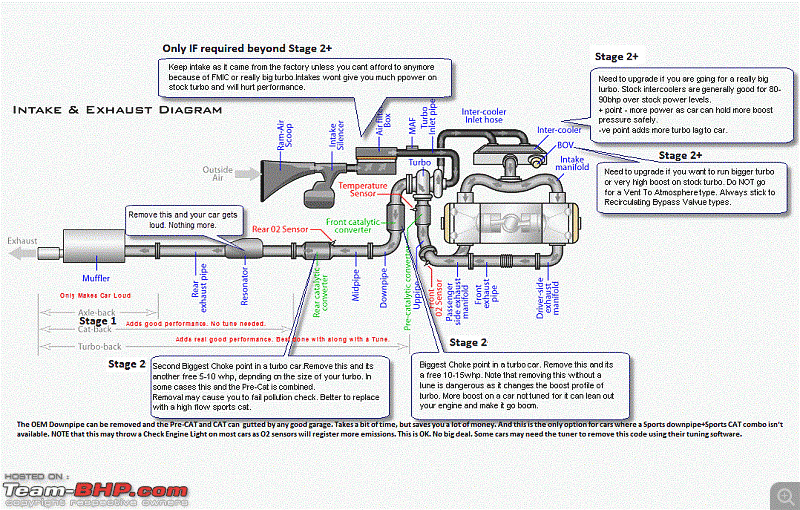

As requested - A detailed diagram on what to modify in the powertrain of a turbo car. The diagram is from the Subaru WRX motor, but applies to all turbo motors.
ARTICLE: How to Modify / Tune your car-exhaust-intake-component.gif
Coming next - Suspension Modification Guide for FWD and RWD cars.
