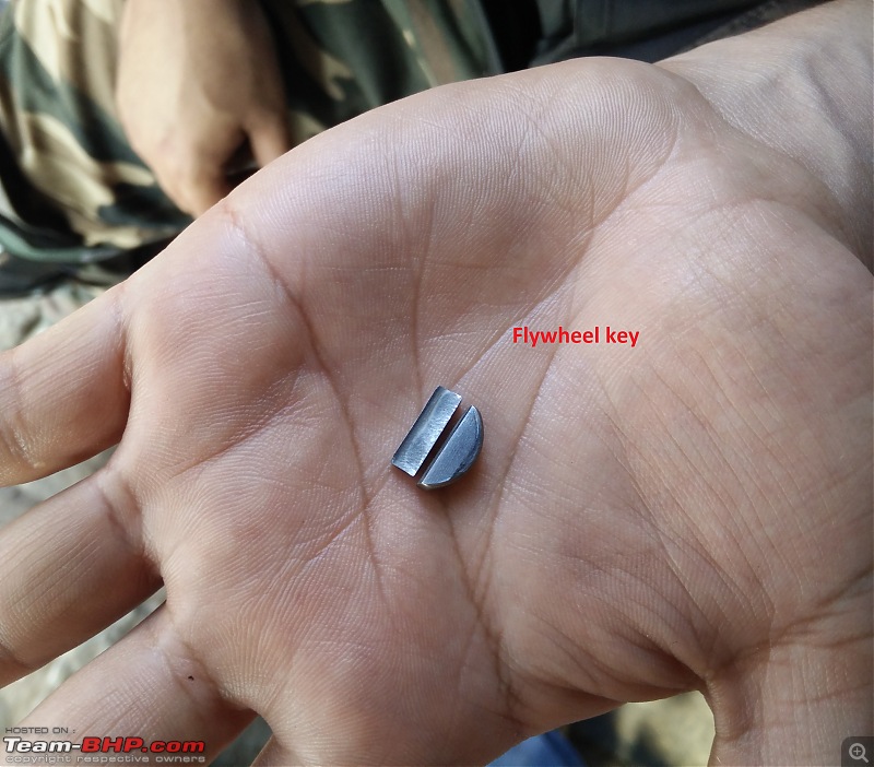

This happened on my friends Himalayan. We were not able to start the engine early morning when temperatures were low at our camping site. The starter motor would run freely but there was no action on the crank. We assumed that some gear between the motor and the crank might have slipped. There was no grinding noise either. Tried to push start the bike but it would not fire and eventually got rich. Couldn't even check the spark because some genius at RE decided to part ways with a kicker, Thanks RE
So we decided to push the bike for 10kms to the nearest mechanic. Identified that the flywheel(freewheel) nut was loose and wasn't turning with the crankshaft. After tightening it the engine fired up without any hesitation.
After another day of riding we checked into a hotel. Next morning the same problem appeared. The motor was spinning freely again with no action on the crank!
Pushed the bike to a local RE expert. He tightened the flywheel bolt but the starter motor was still running freely without cranking the engine. He removed the LHS engine cover, removed the flywheel and was shocked to see that the flywheel key which mates the flywheel to the crankshaft has split in half
Luckily the guy was able to source a key nearby and the issue was fixed.
So, I am assuming that the flywheel nut came loose after a hard day of riding followed by low temperatures at our camping site and when the 1st mechanic tightened the nut it wasn't torqued to spec and somewhere somehow the flywheel key split in half overnight when temperatures went low
Attaching pictures,
