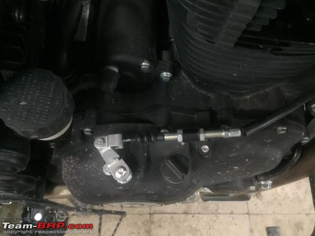

Went in for the first service a week or so back with a long list of complaints.
1. A coarse noise from the engine
2. Extremely hard gear shift, bordering on painful in soft upper shoes actually.
3. Oil leaks from two places on the engine block
Royal Enfield Himalayan - Initial Ownership Report-imageuploadedbyteambhp1468257117.488075.jpg
Royal Enfield Himalayan - Initial Ownership Report-imageuploadedbyteambhp1468257145.461203.jpg
4. Hard clutch
5. Faulty light switch. The dipper switch simply refuses to work
6. High idling note
The service lasted a good four hours which included the rocker arm replacement, my bike being from the first lot. It was sad seeing a brand new bike stripped open like that.

The clutch adjustment was carried out and the standard oil change and air filter cleaning completed the service.
The visiting RE engineer was there to have a look see and confirm the part replacement. He also explained the electric circuit and load capacity when I enquired about auxiliary lights. Post service there was absolutely no change in the effort required for the gear shift. The engineer told me to run it a couple of hundred more kilometres and it will smoothen out. The switch was ordered and a feedback taken on the overall ride experience.
Now for the good part. The bike sounds way more refined than before. The engine note is smooth and that makes the bike feel faster off the block.
