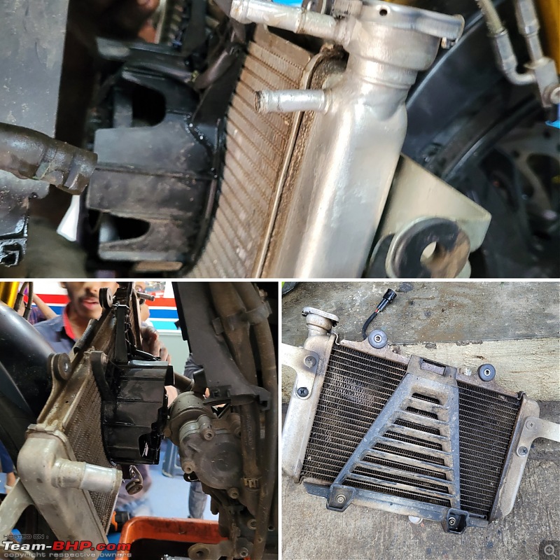

The radiator and throttle body were also removed for a complete cleanup. All these parts were never ever touched throughout the ownership.
Removing a very dirty radiator

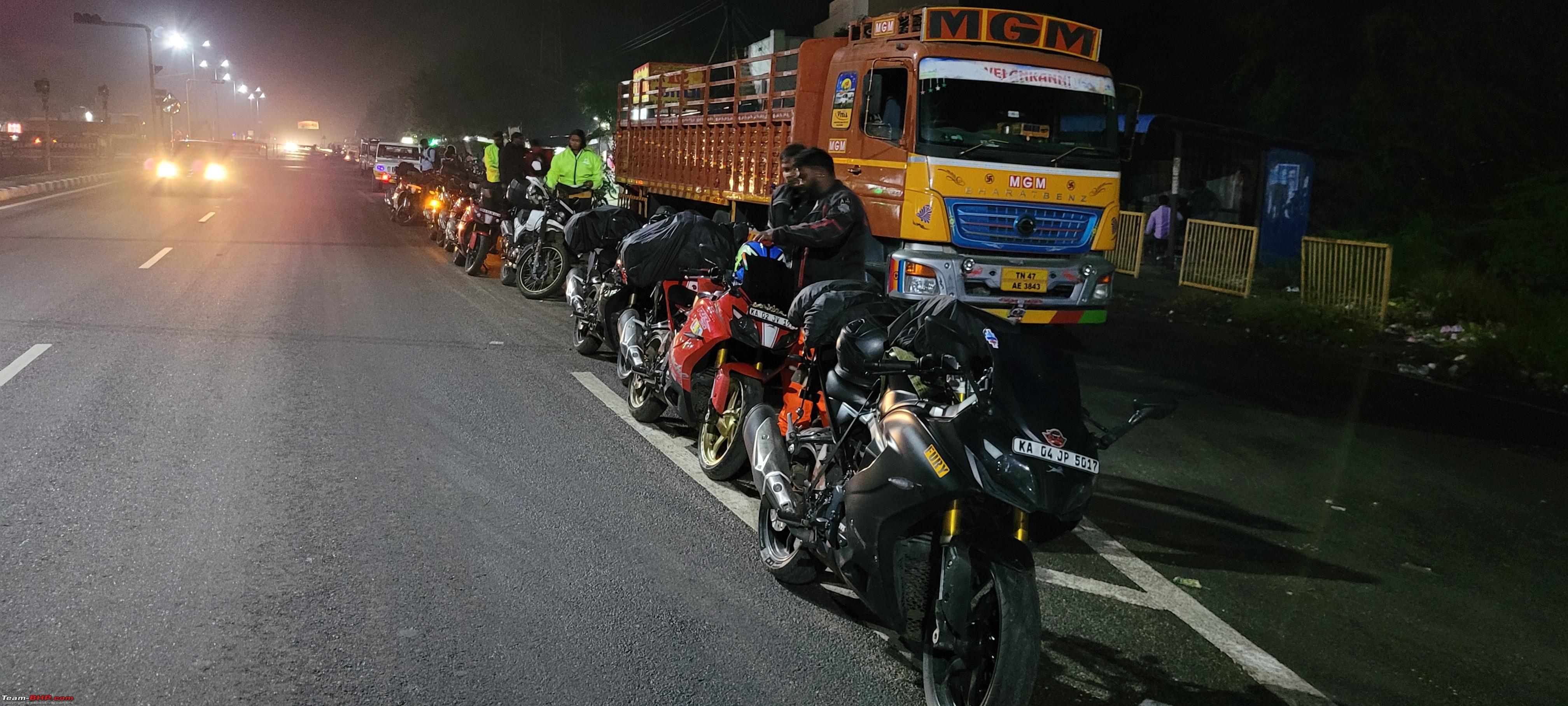

It was 6:30 PM and the darkness had already descended upon us when we set out from the bus stand. As I got onto my bike and started to ride, I realized that there was zero visibility. I had to keep wiping off the visor continuously to see where I was going. In such situations, I usually follow the lane markings, and this time was no different. I was riding just left off the lane marking in the middle. After covering around 3km from the bus stand, there was a slight 30-40 degree right turn sloping downwards. It was then that I noticed a bike on the top left corner of my visor, going slowly or stopped, on the left-most marking on the shoulder of the road. The bike was about 100-150 meters ahead of me, and it took me a while to see it in the darkness.
Suddenly, there was a burst of rain, or perhaps it was water falling down from the trees due to a gust of wind. All this happened in a matter of seconds, and by the time I had covered the distance between that bike and myself, the guys on the bike suddenly decided to cross the road and take shelter from the rain at a bus stop on the opposite side. I could see them clearly as they took a right turn without looking back, and their bike was perpendicular to the road. They stopped only when the last passenger, who was triple-riding, noticed my headlight in the corner of his eye and alerted the rider. Unfortunately, it was too late for me to react, and my left-hand side handlebar made contact with his right-hand side. My LH ring finger bore the brunt of the friction between our handlebars, causing me excruciating pain. I managed to stop the bike slowly in gear, a little ahead of the accident scene and waited for the guys to arrive.
When I looked back, I saw that these guys had fallen on the ground and were trying to make it look like a bigger accident than it was. All three of them were drunk, and they argued that we, being out-of-towners, were automatically the offenders. After making a few phone calls to their "supreme leader" or someone, we eventually agreed to pay Rs.1500/- towards their night party and left the place.
In the meantime, I had lost all sensation in my LH ring finger and couldn't pull in the clutch lever as I normally would. I had to resort to clutchless upshifts, and by using my thumb and index finger, I could downshift somewhat. It was a grim scene once we reached our room, with a lot of thoughts running through my head. We still had a couple of days of travel left and another marriage to attend, and we didn't want to ride the bike again that night, or rather, I couldn't. We ended up booking a mini-bus for the drive to the event location.
We kept the news of the accident from the groom, who although very influential in the town. We didn't want to spoil his reception mood and setting. Returning to the room after the party, I decided to consult a doctor before deciding my next course of action. I had two options - to park the bike at the groom's house and take a train to return back home or ship the bike back to Bangalore and travel back by train or bus. Both options would mean the end of my biking career, considering how my mom would react. The doctor examined my finger and gave me some medication for the night. He also remarked that there might be a cracked bone since I couldn't fold my finger all the way in. He suggested we take an X-ray in the morning if the swelling hadn't gone down.
