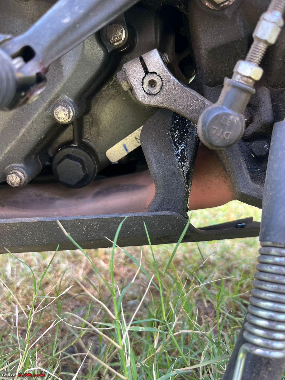

The bike was leaking oil around the 2200kms mark. Took it to KTM svc yesterday and got the front sprocket oil seal changed. The right hand guard had to be changed since it had broken during a fall, and they had a matte black one in stock which I got installed (the left one is gloss black). Also checked the air filter which was completely clogged and got the throttle body cleaned, post which a new software update was done. I’m getting anything between 17-25 kmpl per tankful depending on how I ride. Adding some pictures:

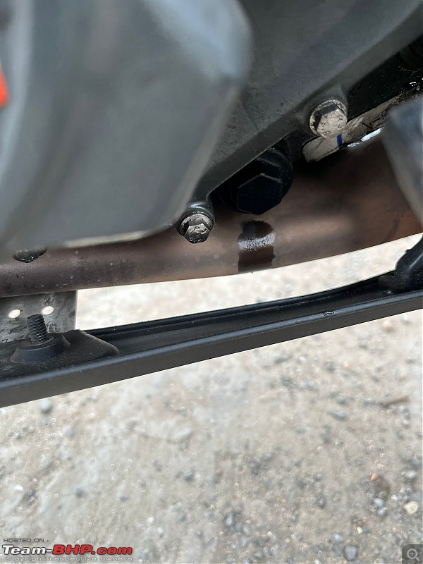

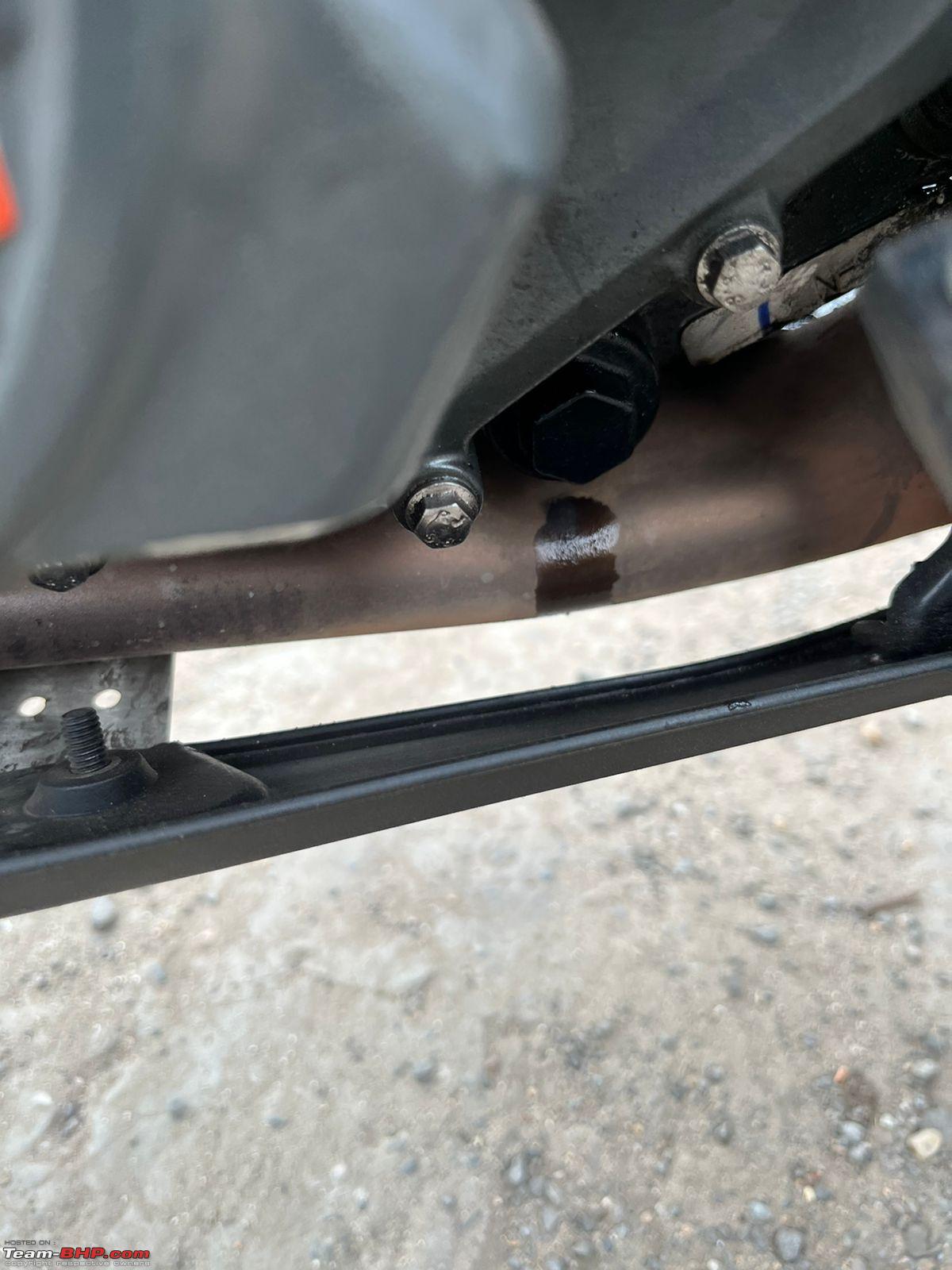

The bike is leaking oil for the 3rd time this month. After my previous update which was about the service centre visit on 8th May, I parked the bike for the rest of the week and took it out only on Sunday morning (13th May), which is when I noticed it leaking again, whenever the bike was kept on the side stand.
Took it to the service centre immediately and the following part was changed, and the oil was topped up. I had to pay the cost of the part, while labour and the cost of the oil were waived off. I would've attached a photo of the bill but I've left it back home in Kolkata.
Post this, I moved to Gurgaon last week and have ridden 500 kms since. Yesterday morning, I noticed oil leaking yet again, from the very same area. Will be taking it to the Sohna Road service centre tomorrow morning and see what the issue is. Oil leaking on a 4 month old, 3000 km run bike isn't a good thing, and while I don't mind the charges to fix it, I greatly value my time and mental peace and absolutely shouldn't have to run to the service centre thrice in a month for the same issue. Hopefully, this gets fixed tomorrow morning, and this time I will insist that whatever is done is done completely free of cost. Of course, if they don't agree then I will pay up to ensure that the bike is fixed, but this is not the ownership experience I had signed up for.

By any chance did you lube your chain recently? This is because if overlubed, the extra oil in the chain that gets splashed in the front sprocket drips via the same area.
If it's not, then it's definitely an issue that KTM has to look into it seriously

From what I can make of the picture, it definitely looks like a little oil leak. This is actually a very common problem on ktm engines. I spent a lot of time fixing oil leaks on my college SAE club’s ktm powered car. I’d suggest removing the exhaust pipe and taking a closer look to spot the source of the leak. Judging by the amount of residue, it might just be a sealing ring that’s damaged. Ensure your mechanic doesn’t over tighten the drain plug as that can damage the ring.
