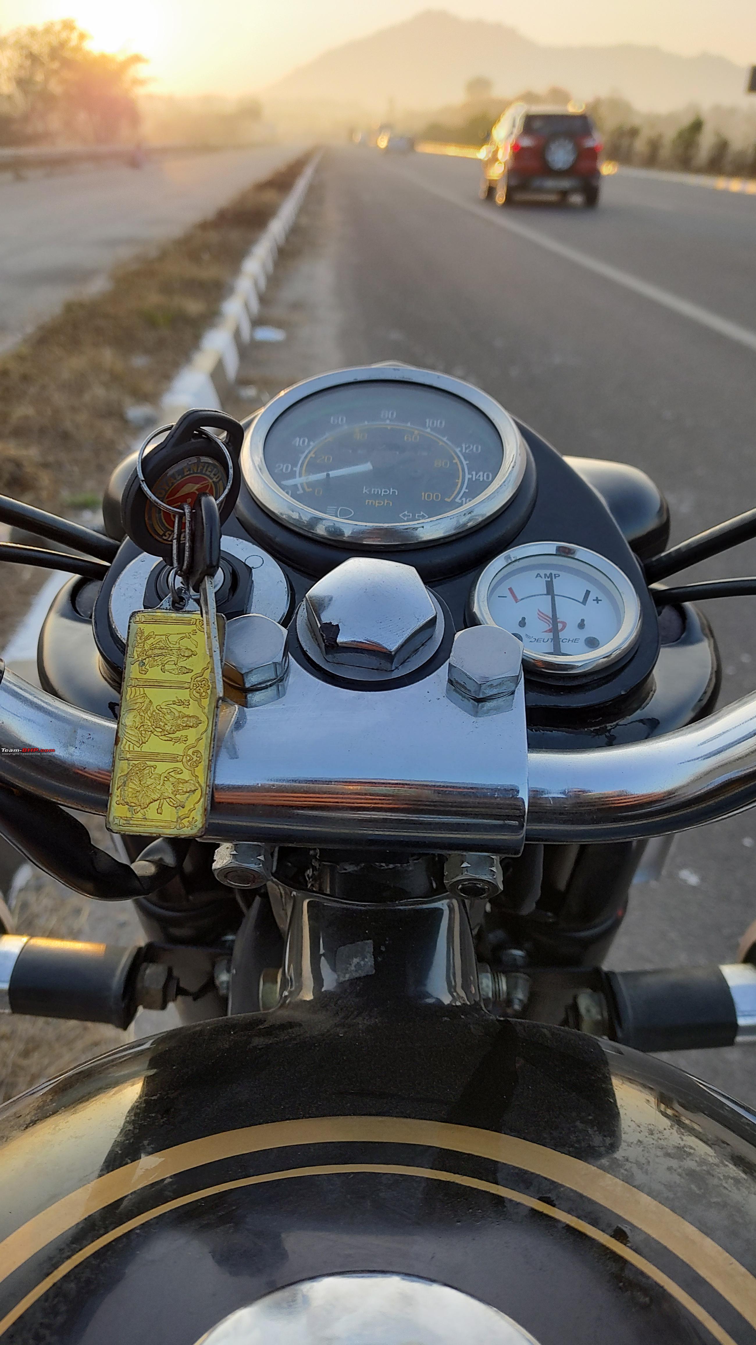

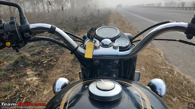

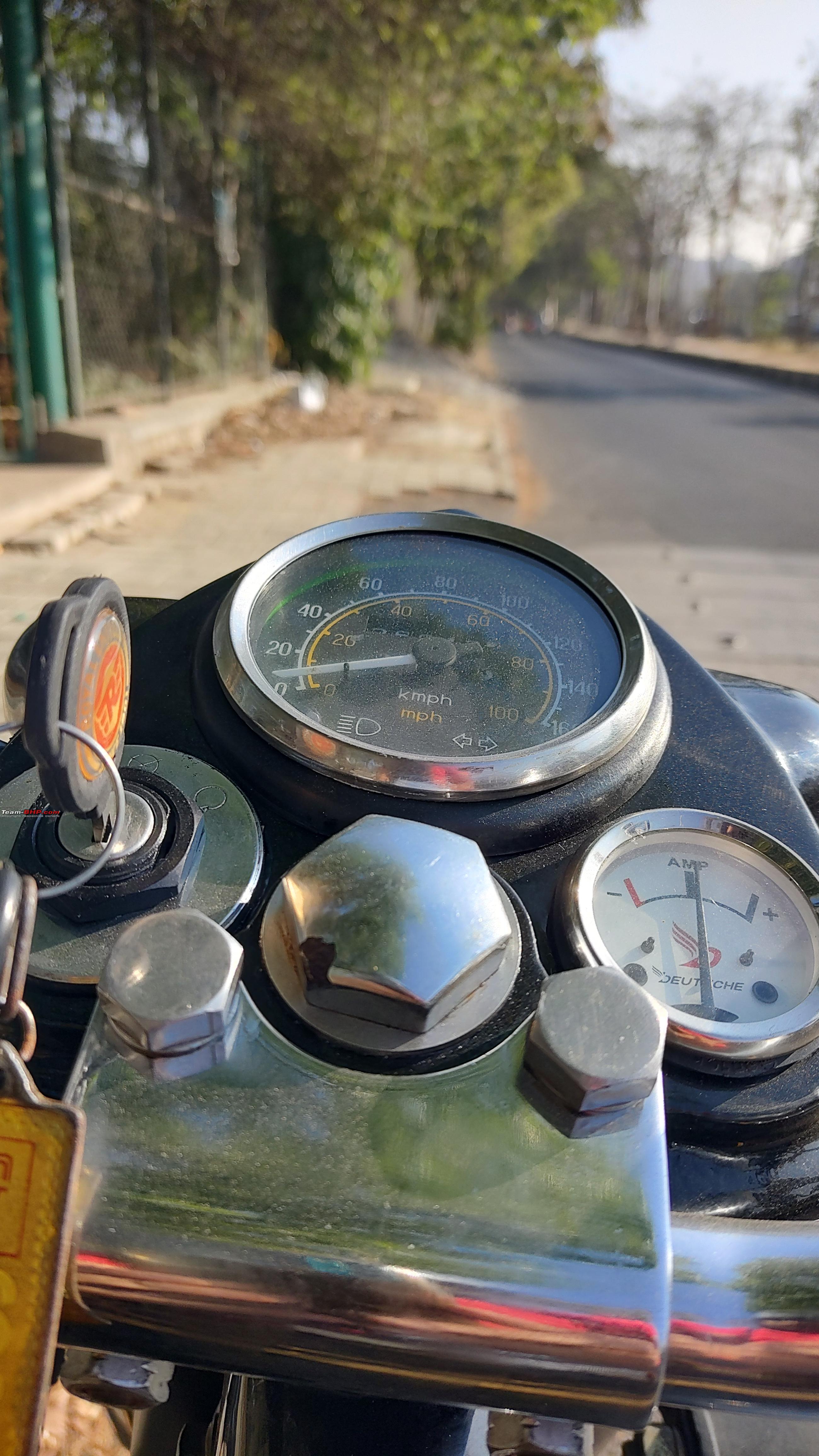

Finally headed out on the highway on the beauty. Did a solo 180 km roundtrip BLR-Mulbagal-BLR (Ok I admit that I had decided to do a 100km round trip while in the trial phase after the restore, but just couldn't resist !!). This boosts confidence on the machine that at a slower pace she will do the distance. So will get her new shoes next week Michelin Siracs 3.25 X 19 in front and 3.5 X 19 rear.
Started off at ~5.30 am and with ample stops here and there returned home by 10 am. This was my first highway ride after the engine seizure incident in 2014. So intentionally I kept the bike @70-75 kph so not to get it a heart attack after so many years. Near Mulbagal I took a random left through some village roads which spit me out on the highway again after 10-15 kms.
Just before Mulbagal I encountered dense fog with mist forming and a faulty speedometer the needle getting stuck at a fixed value even when engine is off or speed is higher than what is indicated (the odometer was working fine though, suspecting issue with the magnet/electrical component of the speedometer due to encountering wet mist?). Due to this I just made a U turn as I suspected some sort of electrical issues, and didnt want to take risk in dense fog with electrical issues.
Notable observations:
- Bike engine is stable at 70-75 kmph, at 80 kmph it is not giving much confidence (maybe psychological due to the history of engine siezure), either way I dont need that extra 10 kmph for now. So will jhave to wait for longer rides ~500 km till I plan my second bike (KTM 390 Adv/Himalayan 450/Interceptor 650), the CI is good to do 350 - 400 km trips for now
- Rynox gears are excellent, tested the storm evo 3 gloves and the advento pants (only grouch with the pants is that my knee will get bruised in longer ride days)
- Neck pain mostly due to the lack of riding longer, also as my excercise routine is suffering due to some issues in my feet so basically a wake up call for restarting at least non running excercises.
- Stopping for food needs to be planned with visibility (not an issue with cars). Carried all tools and puncture repair kit, tyre irons, air pump etc, so taking a break where I can't see the bike was not possible so skipped any breakfast. Didn't want to overload on sugar in CCD outlets today.
- Stuck to the left lane in contrast to middle/right lane driving when in car. This was a new realization as previously I didn't drive when I used to ride. This was an interesting observation as I was rarely irritated by any trucks (all were in right lane), but yes had to put constant vigil for fast cars in the left, role reversal of sorts.
Enough talk now the pics Btw I really like the cockpit view in my photos so pardon me for that.

70-75 kmph is a good speed for the 350CI engine. You get good fuel efficiency, the engine is not being stressed and won't overheat.
If you do 80 and above for long durations, there are chances or partial seizure on a bike that is run a lot.
My cruising speed or sweet spot on my 350 Electra is 70 kmph and on my 500CI was 80-85 kmph. Felt good and it could run all day at those speeds.
The speedo issue mostly will be due to the wheel speedo hub being worn.
