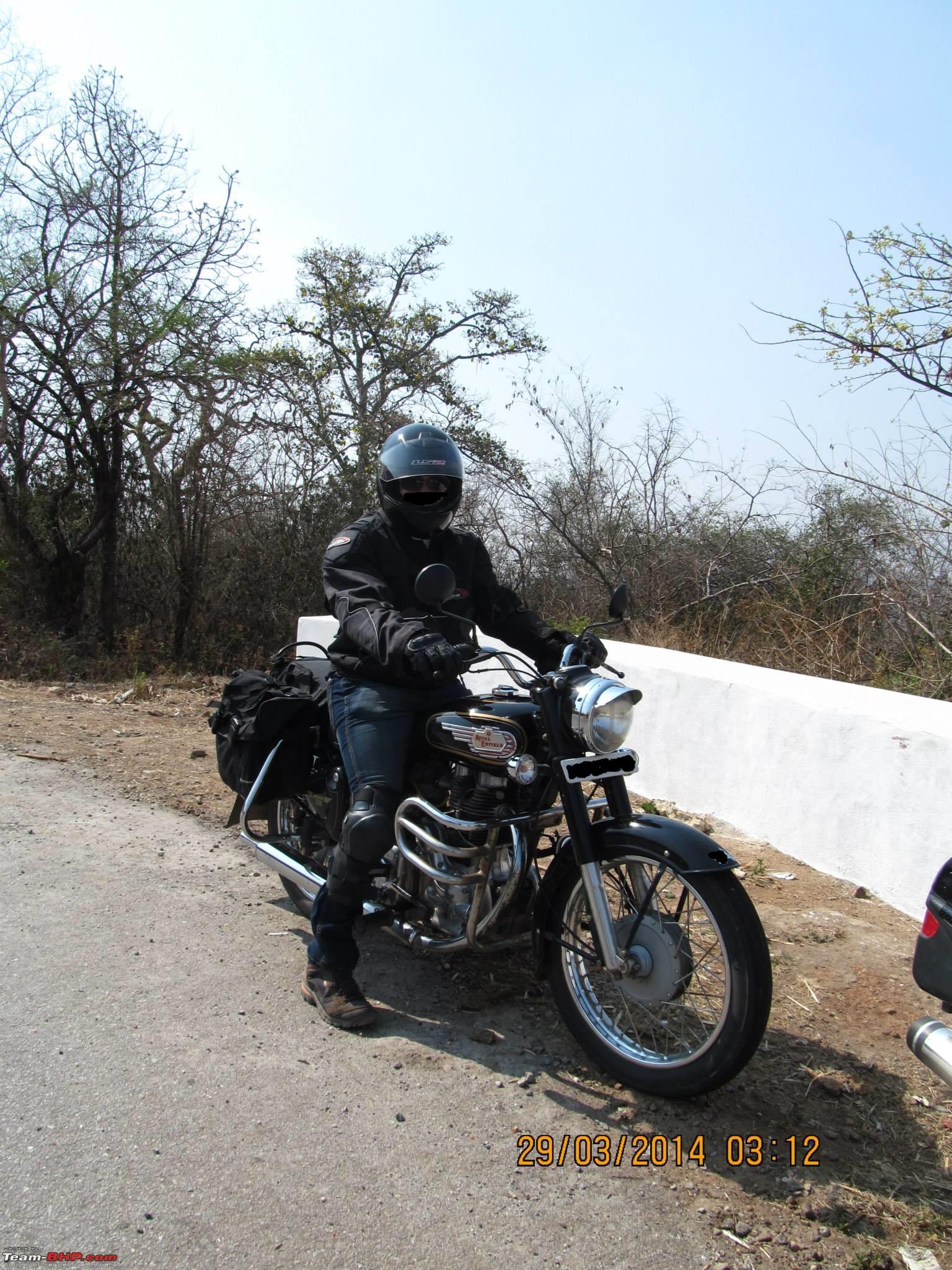

Once upon a time:
Resurrecting a Bullet Std 350 CI - Suggestions on the important work-967125_303558809769326_1094823124_o.jpg
Resurrecting a Bullet Std 350 CI - Suggestions on the important work-1415257_303560323102508_667673285_o.jpg
Resurrecting a Bullet Std 350 CI - Suggestions on the important work-1921208_338752639583276_1151743456_o.jpg
masterChief007 is offline   (9) Thanks
