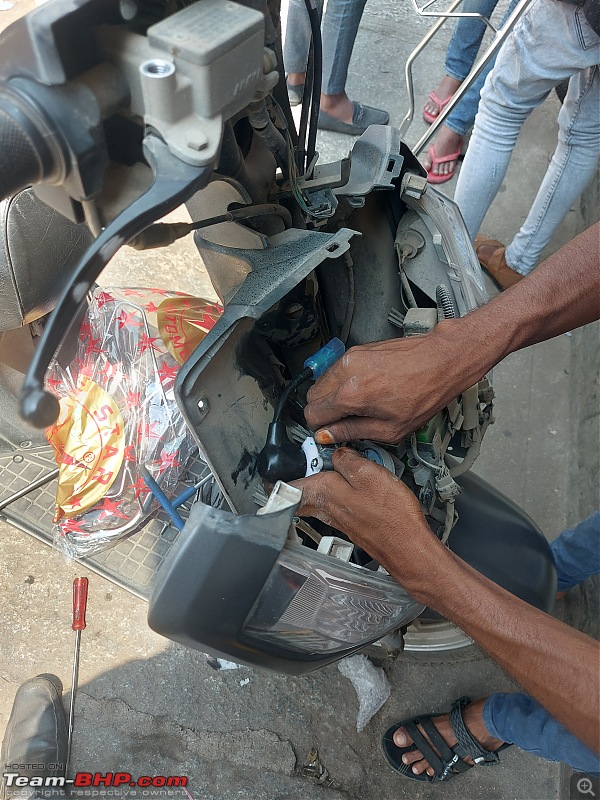

Replacing the ignition switch/lockset
Three Suzuki Access scooters in a row | Ownership Review-access_ignswitchreplacement.jpg
Easy to open front cover to inspect the battery and front cables
Three Suzuki Access scooters in a row | Ownership Review-access_inspectingbattery.jpg

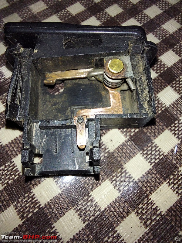

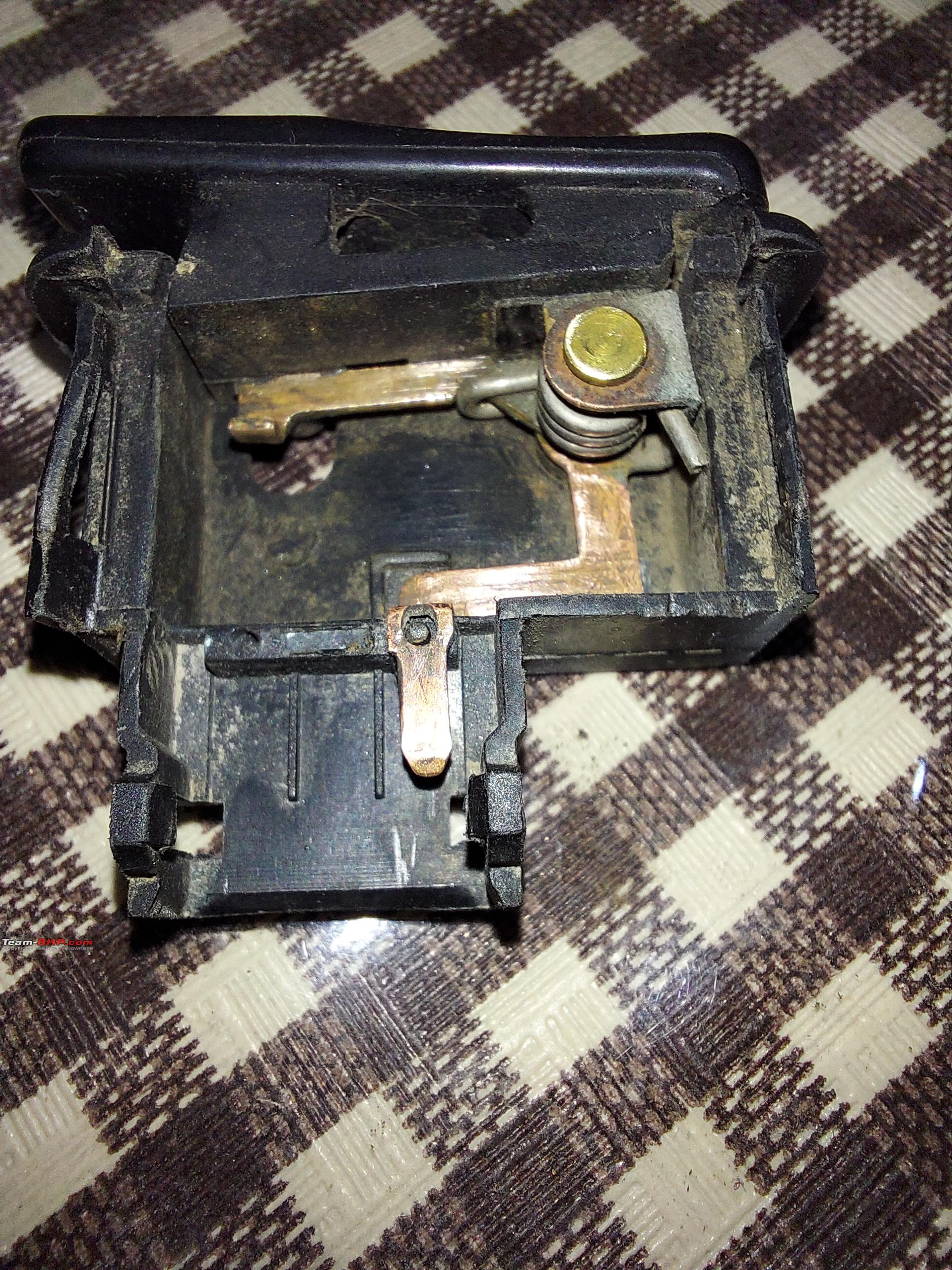

Starter switch all open
Three Suzuki Access scooters in a row | Ownership Review-starterswitch_open.jpg
Starter button contacts cleaned
