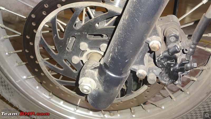

RE Himalayan front suspension - ₹ 11300
Below were upgraded because Himalayan forks did not fit into existing Thunderbird setup.
RE Himalayan front Disk brakes - ₹ 3250
Front Wheel Axle - ₹ 630
Front Wheel Rim - ₹ 950

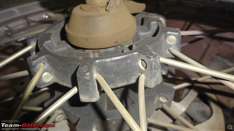

RE Himalayan Wheel Hub - ₹ 2600
Reflector on Front suspension - ₹ 500

Front Wheel Spokes - ₹ 500, along with rim was upgraded as Himalayan hub spoke fitment is forward/rear directions and not sideways like Thunderbird

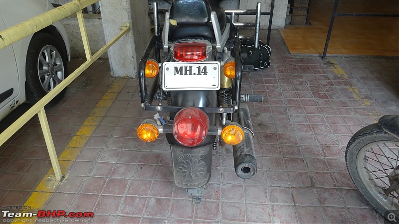

Extra Rear Tail Lamps and Indicators of old Thunderbird ₹ 1500 installed as existing tail lamp and indicators used to get hidden when rear top box was installed.

It has been almost 6 months and have rode the bike for 5000 km approximately including 2000 km of long ride.
Advantages
1. Ride is very smooth and don't feel small pot hole jerks.
2. Braking is improved might be because of tyres, front suspension & bigger front disc brake.
3. You don't feel suspension hitting the ground even if you have heavy luggage along with Pillion.
Disadvantages
1. High cost of maintenance if suspension goes bad or for replacement.
2. I feel that there is lots of friction in chain sprocket might be because the chain has extended a bit.
3. Have experienced rear disc brake failure couple of times, not sure if this related to upgrade.
P.S - Apologies for less quality pictures has bike was not washed after ride and please let me know if you have any queries regarding the upgrade.
Is that a 19 inch rim at front or 18 inch?
And were the spokes modified in any way?
Quite an interesting setup it is. TIA.
Rennjit is offline   (1) Thanks
Old 25th April 2020, 11:17   #70
rowonfield's Avatar
Join Date: May 2017
Posts: 20
Thanked: 36 Times
Re: Modifications - Royal Enfield Thunderbird
Its same size rim (19 inch) which is used in original setup, but has 36 spokes.
Spokes are different, which my mechanic found it in Pune market and are a bit short in size compared to original.
If you plan to use the original one's that should be okay as well but you need to cut it and then thread them which is much more work than getting a new one.
rowonfield is offline   (1) Thanks
