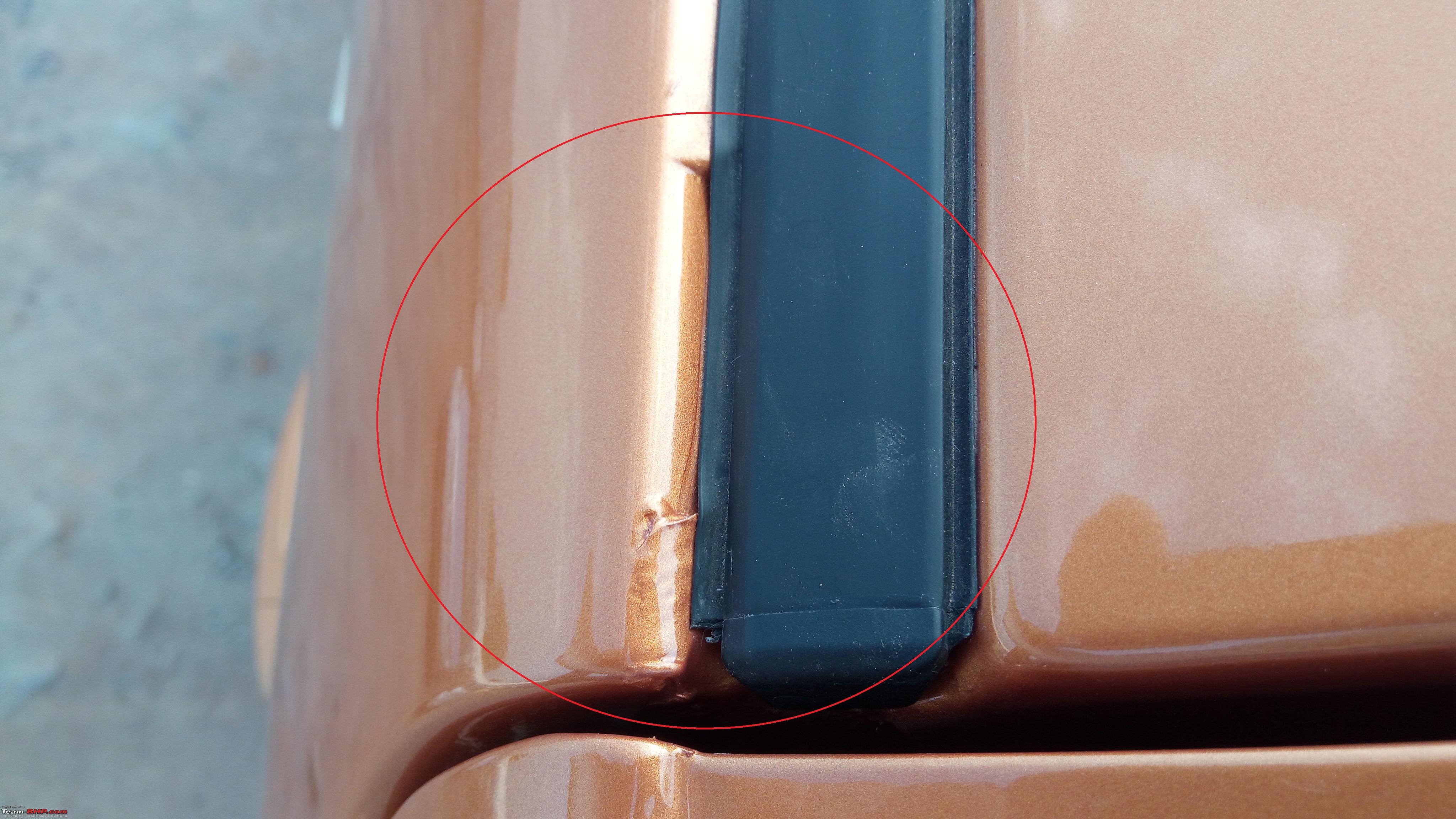

I was then taken to a Tiago and it was for me to inspect the car. First thing I noticed was the ill fitted rubber beading on front window. I was told this would be fixed before delivery.
Tata Tiago : Official Review-img_20170105_162312.jpg
The real shocker came when I was inspecting the exterior on the rear :Shockked: I let the pictures do the talking:
Tata Tiago : Official Review-img_20170105_165120.jpg
Tata Tiago : Official Review-img_20170105_170426.jpg
Tata Tiago : Official Review-img_20170105_165626.jpg
There was a clear inconsistency in paint job. Irregular surface finish, maybe due to error in spot welding ? It was easily visible for a reasonably tall person. I showed this to the SR and he in turn to the stock yard manager. Immediate reaction was to look for the same thing in other cars. None had this problem. Why TML? How did this pass your QA/QC? Now the SR and the yard manager had their discussions and I was told they could 'correct this'. I out-rightly rejected to take this car and went back home.

This is not a paint defect. It is a wrinkle in the side body outer panel during press work at the factory, during the earliest phase of manufacturing and is just not correctable by painting, robotic or not. Let me tell you what this guy will do:-
a.) Scrub the area, apply a putty on the fold area and paint. You may notice a slight bump here.
OR
b.) Scrub the area, grind the fold with a handheld grinding wheel, flatten the area. Be the need perform minor welding work and regrind the weld bead to a smooth finish. Apply putty and repaint the area, robotic or otherwise. In this approach you wont notice anything as long as its a proper paint job.
The car wont have any mechanical issues in either approaches or even if you don't do anything and take delivery.

As Aditya said, don't buy this car. This is not a paint job defect. It's a clear wrinkle in the sheet metal. Ask them whether they would take a part of the payment in cash in new 500/2000 Rs note which would be torn but taped and they wouldn't know whether the notes are torn. You are paying them in full, and you are entitled to a perfect car on day 0. Another months' wait is not much. You can also check with other dealers.

I agree with aditya, this is not a paint defect but a sheet metal defect. You should refuse to take this car.
Also, there was a defective or ill fitting beading that you found out. You can never know if the sheet metal in that area was also defective but painted over.
