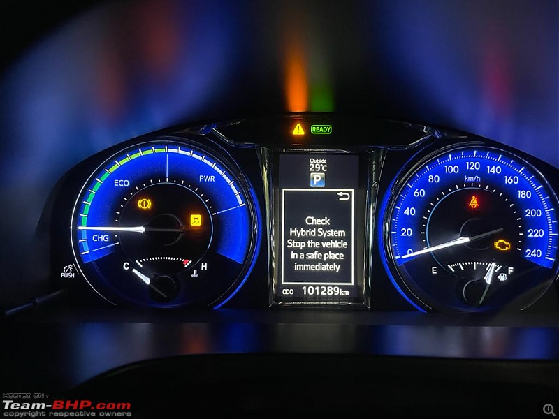

Unfortunately my August 2015 Camry hybrid battery failed last month at 1,02,000kms and I got it replaced recently.
I got this message while driving,"Check hybrid system Stop the vehicle in safe place immediately" After this the vehicle would'nt switch to electric mode,but could run only on petrol mode.I took the car to Lakozy toyota and after some diagnosis they confirmed my car needed a Hybrid battery pack replacement along with voltage sensor which costed Rs 2,60,000 incl taxes.
In India Toyota offers only 3 years warranty on hybrid battery packs,whereas internationally Toyota offers 10 years/150000 miles.
Since my car is 5 & 1/2 years old Lakozy said I will have to make full payment and it wont be covered under warranty.
After numerous emails to Lakozy and TKM India they agreed to pay 60% of total cost as goodwill warranty.I happily accepted their offer and paid 1,04,000 out of the total amount including labour charges.
After the replacement I have noticed the car is switching to electric battery mode more often and I am getting much better range.
With fuel prices rising every day,the Camry hybrid is a perfect car in my city with a constant average of 14 to 15 kms/ltrs.I plan to keep her for atleast another 1 lac kms.

Driven: Toyota Camry Hybrid-whatsapp-image-20210302-4.26.44-pm.jpeg
