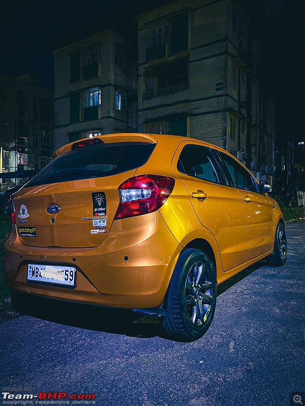

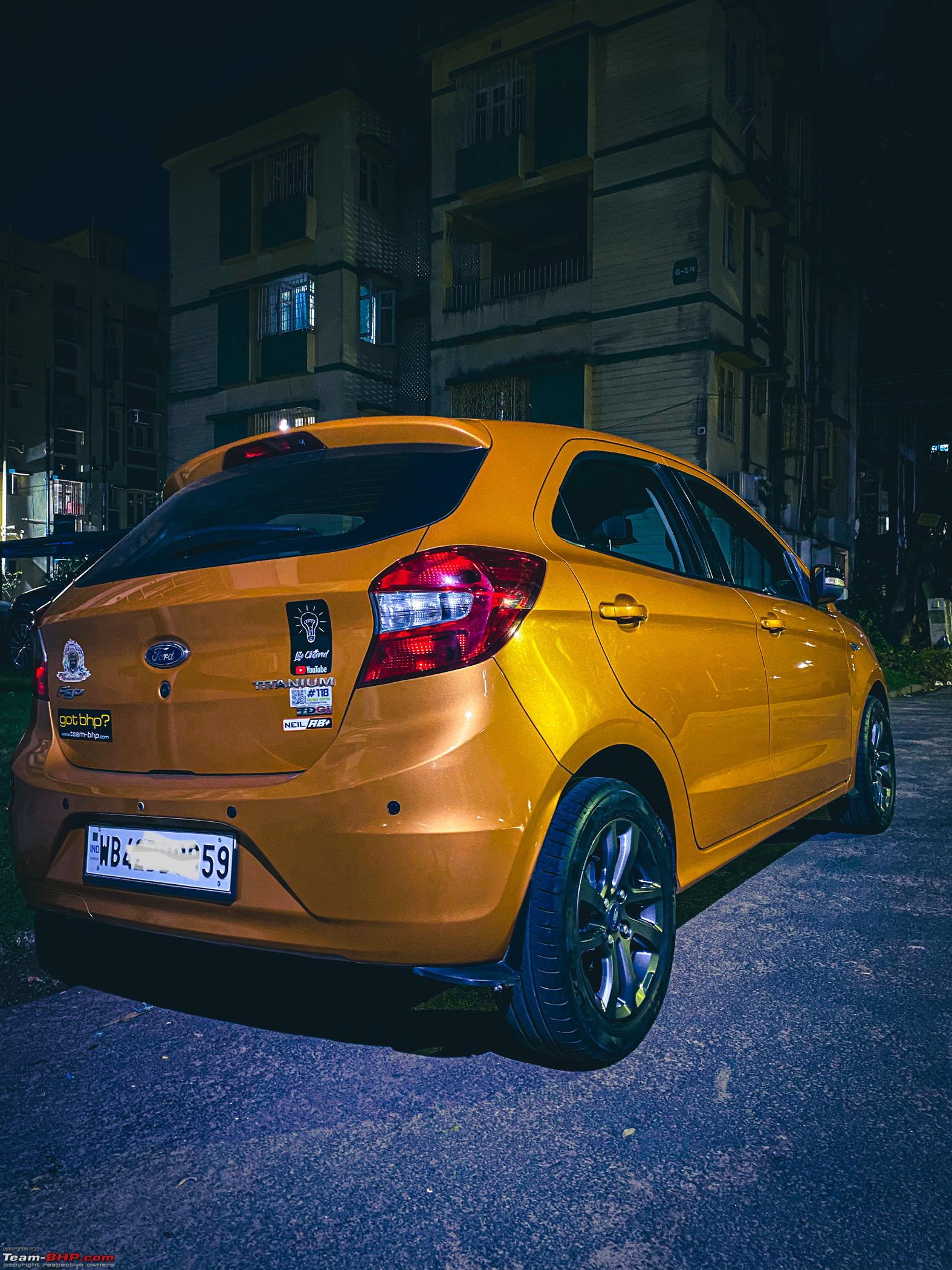

Recently changed some parts like all four struts, and some here and there changes, but the star of the show is the alloys that i got from freestyle. Great stance. Overall this car makes me fall in love over and over again. 6.5 years on, after driving other cars around in the sub 25 lacs bracket, i come back drive my car and think in disbelief why did this car not sell?
