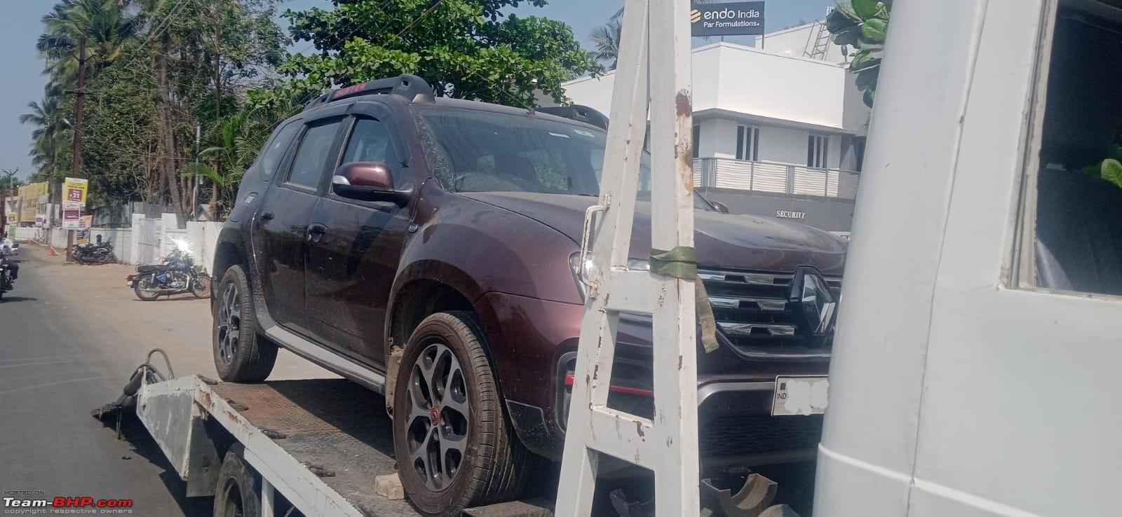

Our Renault Duster Turbo CVT (purchased on September 2021), has covered 43000 + km.
About two weeks ago, we noticed a recurrent noise coming from the vehicle as it was driving which was barely noticeable but still a point of concern.
Initially, we had assumed it was from the engine and during an appointment with the service centre, the sound had remarkably refused to make an appearance leaving us puzzled over its origins.
Yet the sound continued to show up on occasional drives.
While having the horns replaced at a local car mechanic, we decided to consult the mechanic for a solution to his problem to which he had pointed out that the wheel bearings needed replacement.
Soon enough the sound started getting louder and louder until the cracking sounds seemed to engulf the cabin every time the car moved...and this incident just so happened to occur on a drive.
Hence, we made our way to the nearest Renault service centre, where we were quoted a price of 6K per wheel and a waiting period of atleast two weeks. A quick call to the local mechanic and we were informed that this was too high a price and that he had the bearings in stock.
And so we made our way home with the noise elevating our blood pressure everytime we slowed down.
Upon parking the car at home, the right rear wheel emitted an immense burning smell and the alloy was much hotter than it was supposed to be.
(The other three wheels were warm, if not room temperature while this one was too hot to touch)
The next day we set out to the mechanic to get the bearing replaced.
However twenty minutes into the ride, the sounds kept increasing in intensity and volume ultimately concluding with the rear right wheel locking up.
We pulled over and waited nearly two hours for a tow truck to show up and watched our beloved Duster get loaded onto a towing bed for the first time.
(First time for any of the vehicles we've owned actually)
Its been two days and we haven't recieved a call back from the Renault Service Centre regarding the parts.
So my question is this -
Is it normal for a vehicle to have its wheel bearings in this condition at around 43K + kms?
Especially because we had owned a Ciaz for 55K kms prior to booking the duster and we didnt have any such problems.
So is it a normal occurence for Renault cars or is it specific to the driving patterns?
My uninformed assumption tells me that the front wheels (bearing the load, since the SUV is a FWD vehicle) might need replacement sooner than the rear wheels...so any specific reason why it might have happened to the rear wheel?
Your inputs will be of great value.
Thanks.
Attaching pictures of our Duster on the towing bed

I had my 60k service done - replaced belt and injectors as suggested in service schedule. There was shudder for first 500m to 1km drive from basement to parking after every start. The ASC claimed it's cos of low fuel. This didn't make sense as issue was seen with full tank as well. He said the injectors are new and with time it might get sorted. That was the joke of the year.
Even went on to say that's how all petrol cars are and his MD as well has same model and 60k service done (injector replacement) and similar issues are seen. Classic generalization by ASC.
After 60k service observed the crank struggling and now today morning after a run about Battery went dead at 3AM stranding me n my family. I could smell smoke in the cabin and figured it out by checking the engine bay where battery had smoke emanating from it. Rang Renault RSA and they responded quick but I didn't get a technician till 6AM.
The old battery had just 12 months warranty and looks like I need to buy a new battery. Probably the MLDIN70ISS that's suggested in thread purely for 30 months warranty. Will see if there is any more killer deals out there.
Fun facts about battery- Stock battery lasted for 2.5 years and 28k KMs. DIN70L (EFB) New battery lasted for 2 years and 34k KMs. MLDIN70ISS should last longer probably.
Fun facts about RSA - RSA takes call anytime of the day/night. But they wouldn't ensure someone is there to assist you. They'll just open ticket and will be on the assumption the assigned RSA technician would have taken care if it. On top they wouldn't give the technician contact and you have to wait till they call you. I was waiting till 4:45am and I asked for an update only to hear he hasn't even started. RSA is a joke.
Coming back to battery dead ordeal someone came around 6:00am jump started and suggested to idle for 30 minutes. Post that drove home for 30 minutes. Still the battery hasn't charged to crank.
Reached out to ASC which did the 60k service. The technician blames me I would have left the lights on so it battery died ! When I shared smoke emanating from battery when it went dead at 3AM he said I might have overcharged. I understood it's hopeless to engage him any further !
Smoke picture
