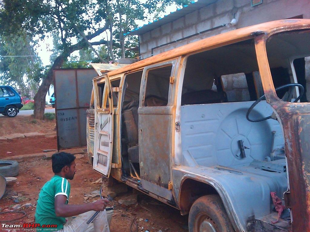

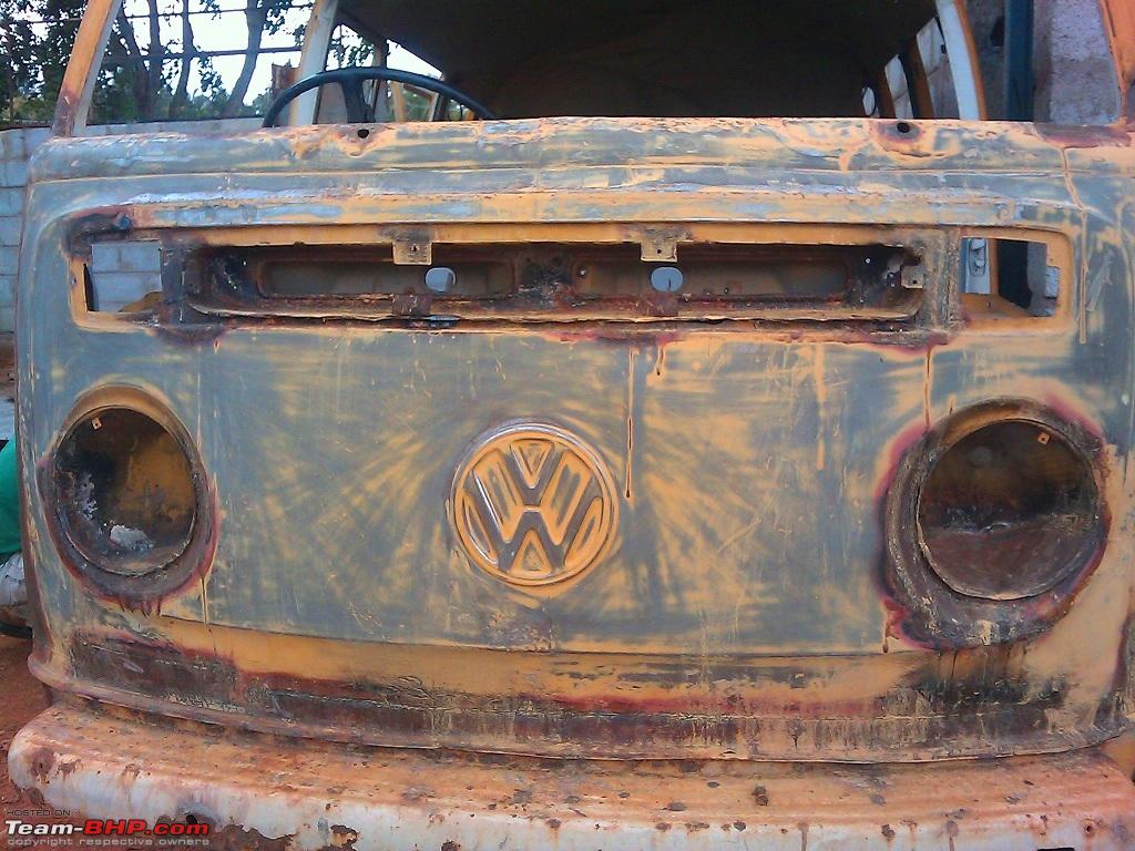

Did not understand, what u wanted to convey Nilesh Will put some more interiors pic so that its easy for you to decide.
The tinker has done a quick job on the rusted panels, hopefully we will also complete work on the rear tail light area by weekend, and that should END the tinwork

We have done 2 coats of Epoxy primer on the Bus, and covered almost 70% of the surface, should be scraping the interiors by weekend and having the Epoxy primer sprayed there too.
