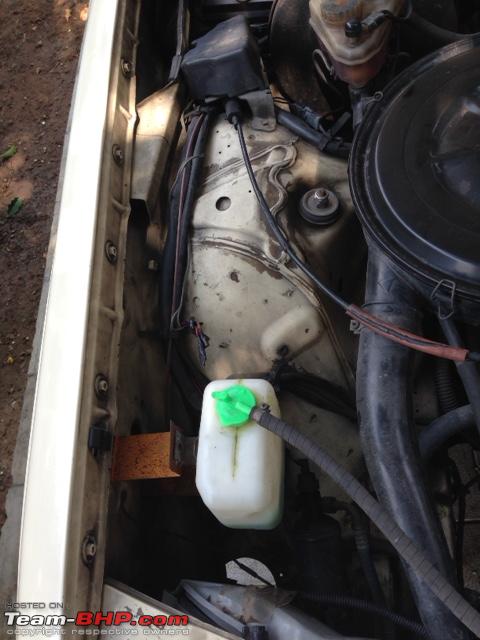

As September rolled over I was still in the process of doing the initial detailing. While one of the obvious reasons to detail her was to make the car as clean as possible and to address some of the obvious signs of neglect, there's another thing about which I will talk later.
I decided my next focus would be the engine bay area. The engine bay had a black sooty deposit in some places. The drainage cowls, particularly the driver side one, were blocked with dirt...30 years is a long long time
Here’s how the engine bay looked before I started. Like I said, not too bad but there is the soot and the patina.
Those who are familiar with a W123 240D will note the coolant reservoir bottle which is not original to the car filled with green colour coolant and some extra wiring. And the aftermarket battery tray.
I made myself a solution of dish soap and vinegar and got myself a lot of different size brushes and went over each and every nook and cranny of the engine bay with a brush and sponge and later carefully pressure washed everything taking care I do not get too much water in the wrong places. The last thing one would want on a old car is a short circuited alternator or water in the fuse compartment
And this is how she looked after I was finished with two days of hard work. I must admit I was somewhat satisfied with my work so far.

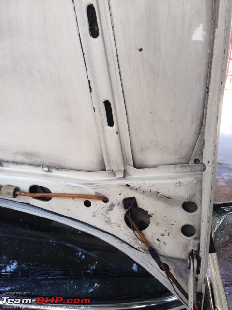

I dried everything with a blower and lubricated in places like the accelerator linkage, cables, hinges. This took me two days and after all that bending my back was hurting real real bad….ufff.
That hood which opens all the way up...It is another testament to how well thought out this car's design is. Not only did Mercedes Benz manage to think for the driver, occupants...but also the guys who would service them...brilliant!
While there I also cut loose this twisted wire that was perhaps evidence the car may have needed to be towed. It was simply an eye sore.
