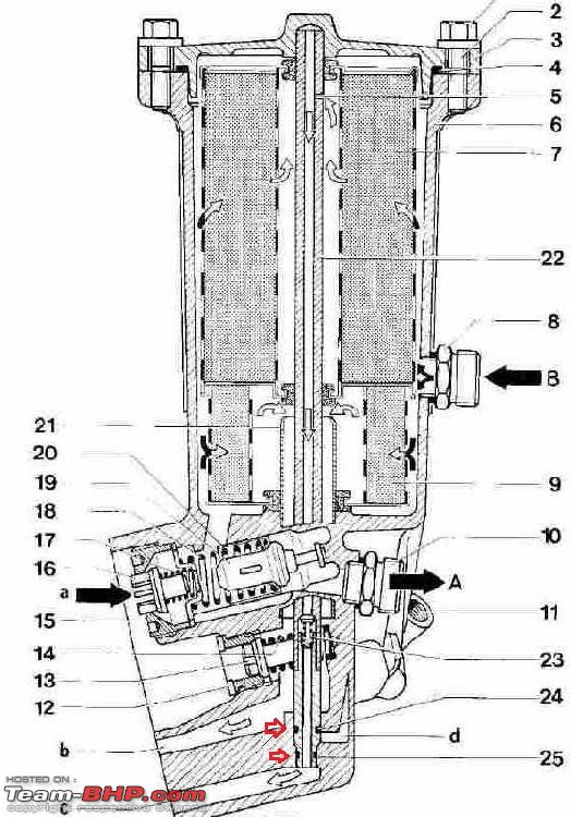

Good job!
Where do these O rings sit. Part of the pump or so?
Thanks
Jeroen
Like so at the end of Oil Filter Shaft, the two of them.
Name:  oil filter flow path post01rot.jpg
I believe when these go bad the bypass threshold drops and you leak clean pressured oil and instead of the oil reaching engine some of it drops into the oil pan. SOme more information here. https://www.benzworld.org/forums/w12...ft-o-ring.html
Attachment 1807822
This is the clogged oil filter by pass valve. If the filter clogs badly and thus creates too much back pressure this valve opens and the oil or parts of the oil are diverted around the filter. Better dirty oil going into the engine than no or too little oil.

That is what is labelled 23 in the above diagram. Here is a another one (where it is 19). The lower O Ring ( leads to 'c', 'fine filtered oil to oil pan' and the upper one leads to 'd' which is 'oil return flow bore to oil pan'.
When these become stiff and non-pliable the pressure release across these O rings stops. This results in a higher pressure across the check valve which then activates earlier in the crank cycle when there is a surge in oil pressure sending more dirty oil to the engine and more clean oil to the pan.
Another interesting feature of the design is the bypass mechanism is part of the filter housing and not the actual filter as in modern spin type filters. I'm sure there must be advantages of the newer design but to me it makes good sense for the car manufacturer to have a greater control over such specifications rather than filter manufacturers. I am aware that different filter manufacturers for the same applications will have slightly different pressure thresholds.
