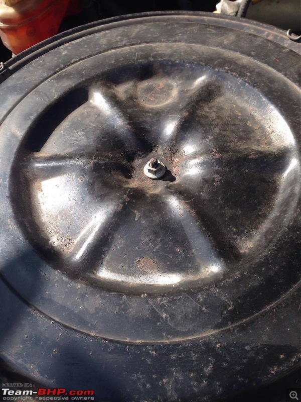

Some tools I have been collecting over the past few weeks. Few of these improvised from what is locally available and few ordered from Ebay. The 33 point spline socket seems to be difficult to find now in tool shops. But I saw one with a guy who specialized on these old diesels but he would not part with it. But he did make me this drip tube which is rather well because what I saw online was just unreasonable prices for this little tool.
'83 Mercedes 240D - My W123 Restoration Diary-15033839_1514861648540833_149219344_o.jpg
'83 Mercedes 240D - My W123 Restoration Diary-15052101_1514861165207548_860991242_o.jpg
'83 Mercedes 240D - My W123 Restoration Diary-14975696_1514861055207559_1266030986_o.jpg
'83 Mercedes 240D - My W123 Restoration Diary-15045311_1514860998540898_95904404_o.jpg
'83 Mercedes 240D - My W123 Restoration Diary-15034346_1514860948540903_1667692418_o.jpg
Any tips or hints from those experienced on this procedure are most welcome...by now it will be clear what I am attempting
