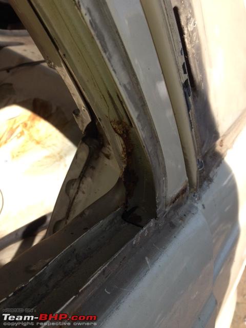

I would like to open up the next episode of my restoration diary with a big thank you for all your responses to my posts so far.
November 2014
By now I had detailed all the issues with my car. The list looked something like this described exterior most first.
Paint - the car had 80-90 % original paint which could turn out very well with some polishing. However on some spots the car had been resprayed and it was an extremely poor job...dull paint with almost no topcoat and poor colour matching (I’m not sure if Mercedes back then used top coat or was it just base coat?) . This was not something visible from a distance but could be seen on a closer inspection.
Rust - there was some rust under rear windshield screen and under one of the trim pieces (it is very important to keep the area under the exterior trim pieces clean of dust and grime else rust develops). I could also see some rust under the battery.
Body - there was one dent, about the size of a palm on driver side front quarter panel and one on the roof perhaps caused by a monkey.
Electrical/Vacuum systems - all fine except window regulator fuse which had a tendency to blow. Vacuum door actuators disconnected by owner after drivers side actuator developed a leak and replaced by electrical actuators.
Interiors - some cracks in the dash, worn out driver’s seat with sagging springs. Leak in oil pressure gauge fixed by replacing with a Mahindra oil pressure unit. Another example of sacrilege.
Engine - I had always noticed that the car had a rough idle. It could be caused by any one of these - clogged injectors, won out motor mounts, stuck piston rings, poorly adjusted value clearance, loss of compression in one of the cylinders and few more possible causes.
The first thing I checked was the motor mounts and though new recently replaced they were not in a condition bad enough to cause the rough idle.
I then tried to eliminate clogged injectors and ran injector cleaner through 2 or 3 tank full. I also ordered a set of feeler gauges and adjusted the value clearance to specs. But nope, no improvement. So by process of elimination the only explanation left was poor compression in one of the cylinders which was causing the engine to loose balance...hmmm.
By this time I had also pretty much made up my mind that I will fully restore my car and had started to research workshops. The three possibilities were

After I had delivered my car at the workshop in Nov very little was done on it. I paid almost weekly visit to the workshop and noticed that it was a very busy operation ran by the three brothers. For a few weeks they enjoyed the car and drove it around...'saab engine thoda weak hai par jab speed pakadti hai to pani ke upar jahaaj jaisi chalti hai' (the engine is a bit weak but when it picks up speed it glides like a ship on water). Obviously he was referring to one of the last great Mercedes that had that legendary wafting ride quality about it It is a car designed when Mercedes stood for itself. Now we have every car manufacturerr wanting to become every other, and so we end up with Mercs that drive like Bimmers and so on and so forth...
After finishing with his youngest brother's wedding (who is the interior and detailing expert) they decided to finally take up my car. One day I was at the workshop and the three of them were having lunch. I quietly waited for them to finish lunch towards the end of which I noticed the eldest nod his head to the other in the direction of my car. Soon my car was brought into the workshop and they started dismantling my car. When these guys work they work really fast. In less than half an hour my car was completely stropped of seats and all interior, all trim pieces...everything...
It was actually a bit painful to watch this.
The next stop for my car was the Denter.
January concluded the metalworking bits that were needed on my car and I was happily and eagerly waiting for the next station which would be the Painter's.

Ah! The dreaded rust...I was wondering when that would make an appearance in your post.
With surface rust, I've found a great solution in "Miracle Paint", an adhesive based rust treatment that bonds to the metal and hardens permanently, arresting rust forever. Check it out and you'll see that its great for areas that are less visible.
My W124 front and rear windscreen and wheel arches have been coated in this treatment as has my W123's sunroof frame. Rust has never returned.

All warts, moles and tags that I discovered will feature on my narrative Sir
