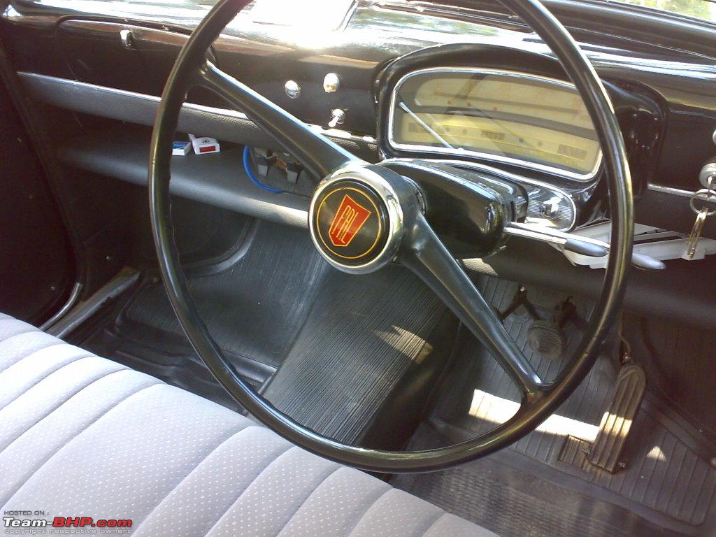

Interior of the super select.

Everything looks to be in place, switches and jewel lights too. Thats a President horn button, and the ignition switch should be in the centre of the dash, not the right.

The bent balljoint above the accelerator pedal is not original. This one has pins sticking out which results in lost motion, the original one had a black spring. Very rare to get one in not worn out condition these days. And Karlosji and JayD, the tyres are not Goodyear, they are not Ceat Safety Drive, they are Ceat C800, supposed to be a premium product. In the Goodyear as well as in the C800, the treads wear dis-similarly (up and down, more so in Goodyear), that's why I do not use them. By their looks, I think ride will be harsher. JayD please ask your friend and let me know.
