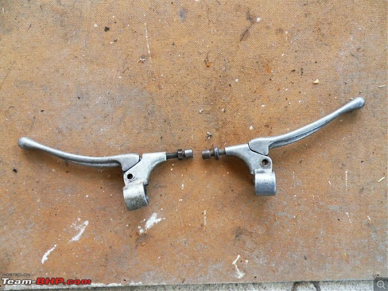

6) Lever Yokes: Found 2 sets in black powder coat. Will polish to bare aluminium like original.
7) Levers: Only found ballend black powder coat. Looking for the ones in the attached picture. Otherwise will have to grind and polish to aluminium.

Here are close up pictures below of the correct lever/yokes, the tail light lens, and the original Polish mudflap. On Rajdoots this came in black with Escorts logo but similar shape. Would prefer the grey one though, it's prettier.

6) Lever Yokes: Found 2 sets in black powder coat. Will polish to bare aluminium like original. Is another set available at the shop you bought it from, wouldn't mind in having a spare set.

Regarding your Air Control Lever
Pictures by insaneinsaan - Photobucket
Hi ,
What guessed was right
The Air -control Lever you were talking all these days was a a " Choke Lever" for Amal Carburetor fitted Rajdoots, Many Rajdoots pre '66 had Amal Concentric Carbs ( yes the same British carb)
Few pages from Rajdoot parts manual ( which you sent me) shows the Choke lever details....Just go through the manual carefully ( we couldn't see since its cropped).
I have sourced a H/L glass also in addition to the Tail light lens,..as your friend to collect it, here is it...
Rajdoot 175cc 1969 (Cekop/SHL M11)-sdc12832.jpg
Rajdoot 175cc 1969 (Cekop/SHL M11)-sdc12834.jpg
