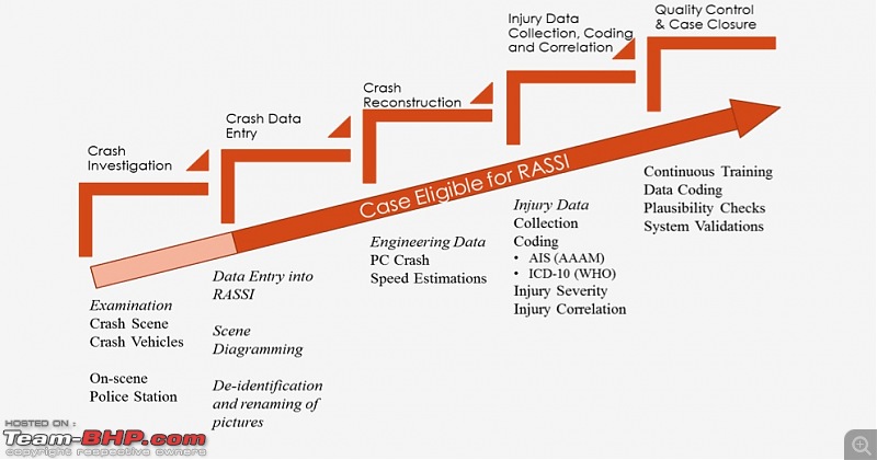

Did some Google search and found RASSI - check if they can help. However, the website implies that they "help" automakers develop safer models. So its quite possible that they might use this incident to snag Mahindra as their client. Honda and Maruti is already there in their client list.
XUV500: Severe crash, but not a single airbag deployed (driver injured)-jpresearch.jpg
http://www.jpresearchindia.com
http://www.rassi.org.in
https://www.rushlane.com/jp-research...-12139542.html

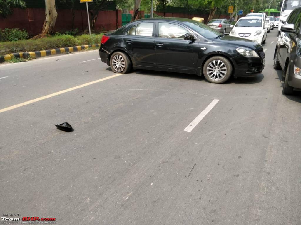

Recently my dad (black kizashi) was in an accident where the other car driver (Grey optra) just slept off on the wheel. He bumped straight into the rear right wheel. The impact was quite strong (told by my dad) and the curtain & shoulder airbags (which opens from inside the seat) deployed immediately. My dad said that had those not deployed, his head could've smashed right into the driver side window. Optra's both front airbag also got deployed immediately.
This is 100% a case of manufacturing defect and Mahindra should be held solely responsible for it.
