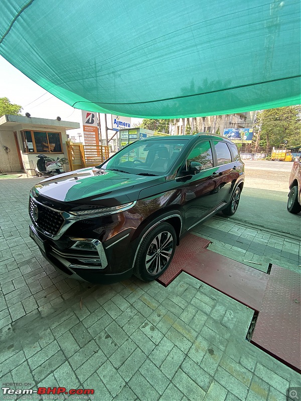

I picked up my Hector yesterday from MG Nagpur.
I had informed them about my plan to reach showroom by 9 am and to take car back to Pune same day. They were ready with all paperwork, after signature, payment, inspection & test drive I was off to Pune by 10 am. This was my first experience with there service centre outside Pune and it was positive. Additionally car was clean inside out and shining which is usual benchmark of MG service.
Service centre had moved new Conti”s along with new alloy wheel to front and the two Goodyear tyres (including one new from January burst) to the back. They also mentioned that all four wheels are thoroughly reviewed by them (including the remaining oldest Goodyear) and no issues are observed, however I plan to switch the old Goodyear with Conti soon. The relatively newer Goodyear tyre which was bought by me in January without insurance, plan to keep it for 10-15K KMs unless tyre dealer offers some deal for it. All four Continental”s will be peace of mind.
I drove back home to Pune without any mishaps. As already have gone through 3 tyre bursts of Goodyear so I had some stress back of my mind before the drive as two tyres in rear are still Goodyear. Before starting the journey, filled in Nitrogen in all four tyres at 35 PSI. My eyes were glued to TPMS for most of the journey on Samriddhi expressway and drove around 90 Km/hr till Karanja (200 kms from Nagpur where the two bursts had happened) noting every PSI and degree increase of tyres.
Note that I was driving through the day and it was very hot. Eventually observed that temperature of tyres have stabilised maximum around 49 degrees for front and rear around 45. Tyre pressure max reached to 37.6 PSI among all four.
As soon as I got off from Samriddhi to tar roads in Shirdi, I could notice temperatures of tyres reducing, well my speed had also reduced substantially given the vehicular traffic.
Insurance claim:
One alloy and two tires changed, 100% cost covered by insurance and I had to pay 2K as mandatory payment for insurance claim as written in policy. 100% claim approval was positive surprise given vehicle is 2 year old and tyres were 30K run. My car insurance policy through MG has tyre and rim cover included which was saviour. I wish I should have gone for first tyre burst replacement also through claim as anyways NCB is nullified now.
Goodyear quality
I keep a close eye on my cars every vital detail which includes tyres. They didn’t had any bulge on sidewalls, always had manufacturer recommended cold tyre pressure and ride was also smooth. Most of the bursts were either at centre tread of tyre or started or lead to centre.
The only benefit of doubt I can pass on to Goodyear is that car did went through potholes/speed breakers during 30K kms cross country given the way they sometimes suddenly appear. But those cases were not frequent & never led to bulges, punctures or rim bends.
In any case I am done with Goodyear and will recommend folks to change them straight out of showroom.

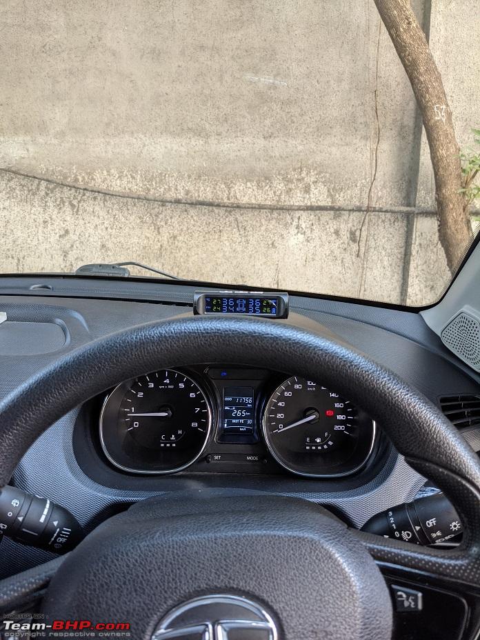

Thank God that you and your family were able to get out of the mishap of tyre burst unscathed and kudos to keeping cool when it happened and the way you steered gently to safe stop. Also the kind of support that you got from MG RSA is something difficult to expect in these days, especially in our country.
I would have bought a Hector just for the RSA support
My cars are humble ones and came with humble shoes - Apollo for both WagonR [2011] and Tiago [2018] The OE on WagonR lasted 5 years without much degradation ( visible cracks etc.) while the ones came on Tiago have been with fine cracks since 2021- even though its only 12.5 K on odo since it has mostly remained parked due to pandemic. I upgraded Wagon R stock tyres 155/65 R14 to Yokohama 165/65 R14 in 2021 and it was a world of difference in terms of grip, braking performance and tyre noise. The reason I am saying all this is because I am no expert on Tyres but the below video from Top Gear in 2013 opened my eyes on the money that I was wasting on filling Nitrogen in the tyres. Please see for yourself and draw conclusion.
I also invested in TPMS on both cars that transmits pressure and temeperature at real time - something that is a must have for safety while driving on concrete roads.
I hope that your car TPMS also provides data individually for all the tyres in real time.
Happy Safe Driving.
2 tyres of my MG Hector burst on the Samriddhi Expressway-pxl_20221226_053208893.jpg
javageek is offline   (3) Thanks

Yes, after two incidents, I really thank my stars to have opted for MG RSA and kind of excellent service they provide. While talking to MG RSA team at the time of incident they also mentioned that just in case of flatbed arriving late to pick up vehicle, they will arrange a custodian for vehicle to whom we can handover the vehicle and proceed to destination in taxi. I liked the way they brainstormed all possibilities while handling the incident, keeping me posted almost every 15-20 minutes with updates and adhering to time commitment.
I think I paid 50K for MG Shield for 5 years which includes RSA and vehicle service cost’s including consumables for 5 years/ 75K kms. While I get Rs 0 invoices for every service, I had never thought RSA will be also professionally managed with Rs 0 cost to me with no cap on distances.
Yes TPMS provides data for all 4 tyres individually, post these incidents have switched to better tyres for good.
2 tyres of my MG Hector burst on the Samriddhi Expressway-9c4ab4c4c95d4b07971715ef2d5e5c65.jpeg

Tyre Inflator + TPMS = Best combo for tyre safety during touring.
Thank you, I already have them in car, root cause seems to be defective tyre as TPMS never signalled warning.

In your case, TPMS should have shown if tyre pressure were high before burst.
