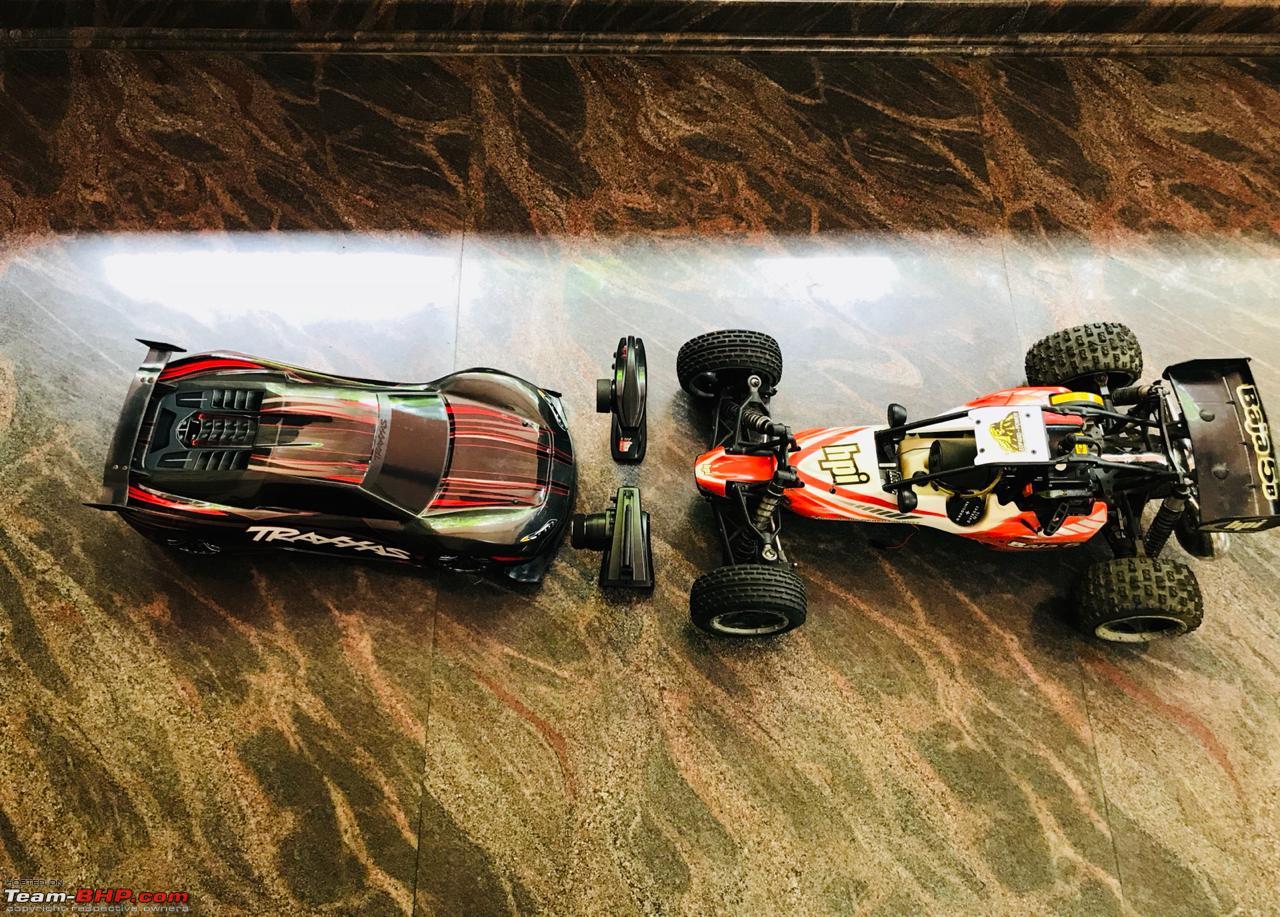

Posting the pictures of my toys.
HPI Baja 5B (Petrol), Traxxas XO1

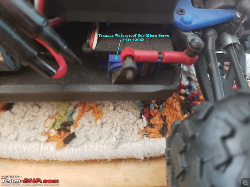

Steering servo gears fix.
The stock steering servo [Traxxas Part #2065] that comes with the little Teton is waterproof but it has plastic internal gears.

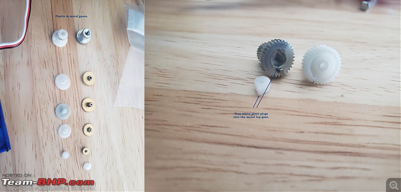

These are prone to break & considering the environment that this vehicle is meant for, Traxxas should have offered a metal gear servo as part of the package.
They have introduced a newer servo with metal gears [Traxxas Part #2065X] that can be swapped-in but they also have spare metal gears for the same servo.
This metal gear set [Traxxas Part #2064X] is an exact fit into the stock servo. Since I like fiddling around I decided to explore that option.
FYI, you can also choose to get a replacement plastic gear set [Traxxas Part #2064], if you so choose. Or a servo from a different manufacturer.
This is what a servo with broken gears (looks &) sounds like:
Has to be fixed or this thing isn't going anywhere.
You just need a couple of tiny Phillips head screw drivers, namely a size #000 (1.5mm) and a size #00 (2mm), also a needle nose (long-nose) pliers.
It's an easy job. I tend to take a lot of pictures when I'm working on something to make it easier when I put everything back.
Here's the little servo that needs to come out:

Plastic & metal gears compared. The one tiny plastic plug that comes with the replacement set goes into a slot under the biggest metal gear:
