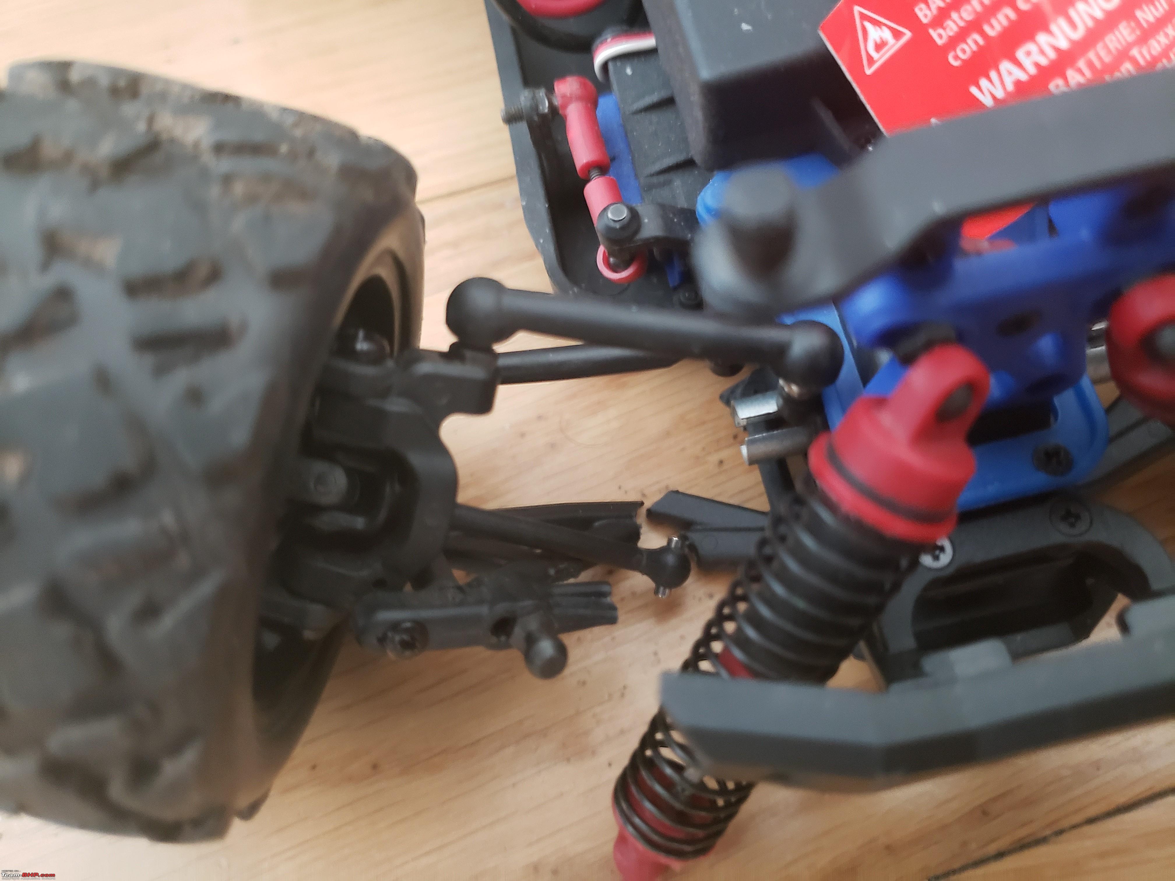

After fixing the issues, we were elated & went a little bit wild:
This, & a little jump off a small concrete block unfortunately resulted in a broken suspension arm:
The Radio / Remote Control Cars Thread. (RC)-01.-20200422_115815-edited.jpg
The Radio / Remote Control Cars Thread. (RC)-02.-20200423_125430-edited.jpg
The Radio / Remote Control Cars Thread. (RC)-03.-20200423_125440-edited.jpg
Needless to say, replacement parts are available [Traxxas Part #7630] but the replacement parts are also plastic and as this is now an older model, they're getting difficult to find. So I am looking for some aluminium (sturdier) replacements.

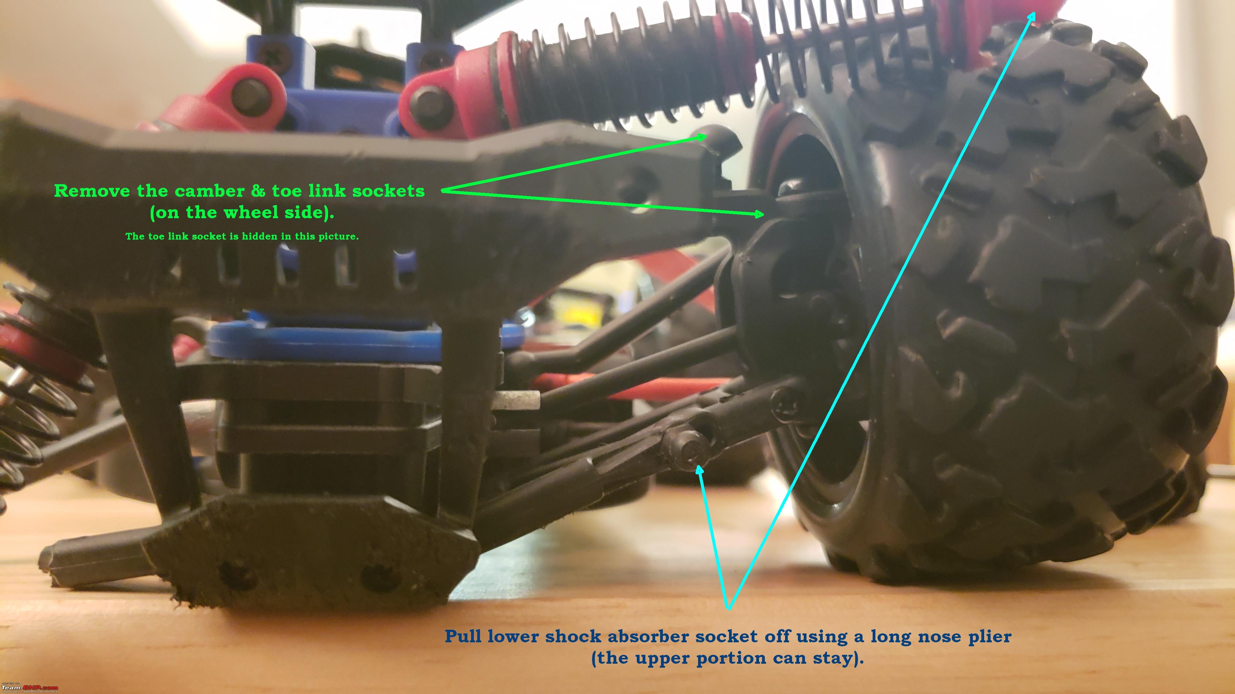

Begin disassembling.
Remove the camber & toe links from the wheels. A long-nose pliers will help & you can use a bit of force on them. If you break any you can of-course get replacements [Traxxas Part #7636].
Pull the shock absorber off the lower ball mount. Later on you'll also remove the ball mount & transfer it to the new arms:

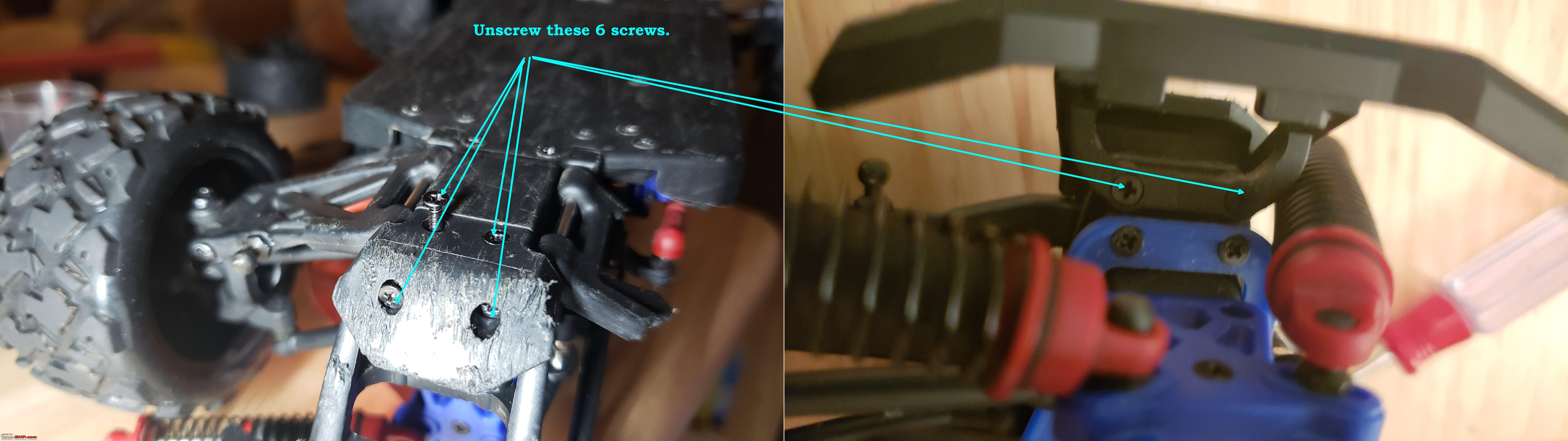

Unscrew 6 screws to remove the bumper:
The Radio / Remote Control Cars Thread. (RC)-06.-20200427_205635_205825-edited.jpg

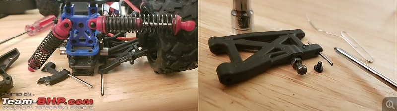

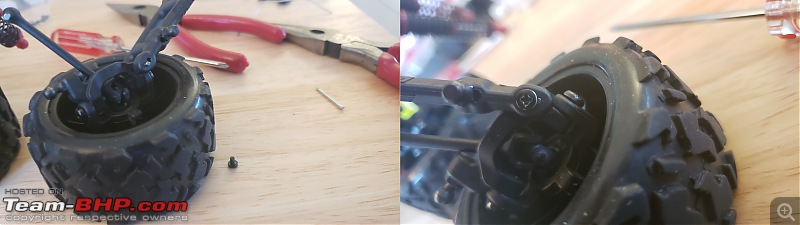

Removing the small screw uncovers a steel pin that holds the arm onto the wheel.
Some times these pins will slide out with little pressure from a paper clip.
Remember to take the ball joints out using a 3/16" or 5mm hex head bit:
The Radio / Remote Control Cars Thread. (RC)-07a.-20200427_205021_205050_205302-edited.jpg
Other times the pins are stubborn & you'll need to hammer them out with a nail & hammer:
The Radio / Remote Control Cars Thread. (RC)-07b.-20200430_182832-edited.jpg

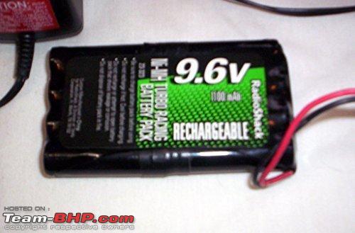

Hi Team, require your help finding a battery for my old RC Car.
I recently found my old toyish RC Car which was lying in the storage room. It is a RadioShack Desperado and it doesn't hold a candle to the amazing stuff on this thread. However, for nostaliga sake, I was trying to get it back to life.
The issue is that it uses a 9.6v ni-mh battery which I am unable to find online. It can also be powered by 8 AA batteries however the same would require a battery holder. The battery holders that I have seen online do not seem to come with the adapter which can fit in the RC Car.
Request your help to guide me where I can find something which would bring it back to life.
Attaching some photos of the RC Car and the original battery and charger for reference.

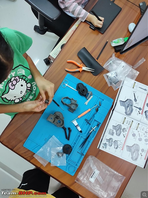

Waiting to kick off the assembly this weekend. I will involve my 13-year-old daughter in this project, and hence it may go a bit slow, as we go through a session on 'why' each component or module is required in a car, and then assemble it. Yesterday was the differential day
Attachment 2321263
