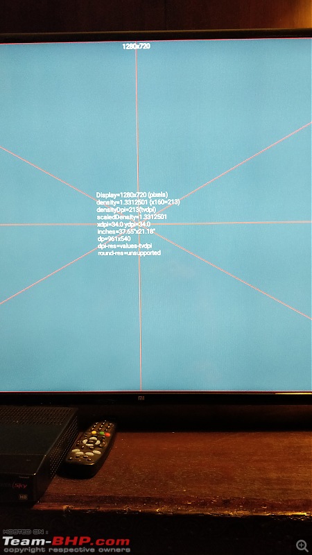

Recently bought the Mi 4A Pro 43" Full HD LED TV as a 2nd TV.
I so happen to check the resolution of the content playing on Hotstar. While the video content showed 1080p feed. The screen resolution remained at 720p!
I even downloaded resolution app to check called "Wear ScreenInfo" on the Mi playstore which confirmed the 720p screen!
Mi helpline, chats etc have no answer.
Shocking how Mi can do this! Pl check your own TVs..

I suggest you run the test by using some external full HD content played through HDMi and not some app. Some reviews suggest that the firmware locks the OSD screen resolution to 720 when using an app for this model.
Please check and report so that we can clear the air around it.

This is a well known issue and the solution is as per below
Yes, that's true. The OS in the TV is locked to 1280x720 and there is a reason for that. The processor onboard the TV is not powerful enough to run fluidly on 1920x1080. I was too frustrated initially by this letdown. But I anyway went ahead and forced my TV to run on 1920x1080. Things don't run super smooth on Full HD but yes it may be worth the switch for many people. You can follow the steps below to force your Mi TV Pro to 1920x1080 (Full HD).
1) Go to settings-about. Scroll to last and hit 'Build' multiple times to enable Developer options.
2) Go to settings-Developer options. Enable 'MiTV Adb Debugging'. Your TV will restart and that is normal.
3) Grab a PC/Mac/Linux with Android Debug tools like 'adb' installed.
4) Connect adb to your Mi TV using: 'adb connect YOUR Mi TV IP ADDRESS'
5) Then give the next command 'adb shell wm size 1920x1080'
6) Wait a few seconds and your screen resolution will change but this will also make everything small on the screen.
7) To fix this, you need to change the DPI. Do that by using the command 'adb shell wm density 300'. You can use any density you like. The bigger the number you choose, the bigger things will get on the screen.
How else can I test? Do you mean through a Firestick? isnt the purpose lost? why buy a Smart TV?
Tested live with Hotstar - FAILED.
Tested with app - FAILED
If it is locked to 720p means it cant play 1080p! then why advertise as 1080p. If a smart TV cannot play full HD content then it is cheating us by calling it a smart TV! I would not have bought it just to play 720p.

You can try connecting the TV to a laptop/desktop with HDMI cable & then check the resolution reported in the laptop/desktop.
That would be pretty accurate IMO.

The app I used is correct. It displayed 1080p when I used it on my phone.

The TV can run at a lower resolution than what it is capable of. What the app seems to be reporting is the resolution currently set, not what the TV is capable of.
To check what the TV is actually capable of, please use the method suggested by pkulkarni.2106.

There's 2 possibilities that could cause hotstar to run at 720p.
1. The TV does not support 1080p streaming via inbuilt option as the graphics can't process it. Only way to confirm is to play 1080p content through the HDMI port and see the resolution.
2. The TV supports it but the hotstar app is only licensed to 720p. This is common for cheaper phones and TV. Hotstar/Netflix needs DRM license for enabling full resolution.

You seem to misunderstand. What is locked in 720p is the On-Screen Display - like settings, volume display, etc. The TV need not display, for eg., your volume settings in full HD. It's not needed and they're downsizing it to save CPU usage.
You should be worried if your TV is not playing 1080p videos which is not true I guess. You can test it by playing a 1080p video from USB. I have a HD Ready 32" TV which means it can't play Full HD videos. It doesn't play 1080p videos from USB. So if your TV plays Full HD videos you can stop worrying.
HD ready TVs can play and process 1080p videos in 720p resolution. OP is concerned that the 1080p videos being played at 720p resolution in his device.

The TV has no option of changing resolution. If it was capable of running at 1080p, no reason why it shouldnt. I may have tested this if the TV was not a smart TV.
1 . I bought the Smart TV to run apps like Netflix, Prime & Hotstar. Doesnt solve my purpose even if it does play 1080p through a USB.
2. I use the same Hotstar login on my 10 year old Samsung LCD (via a Firestick) and it played at 1080p.
