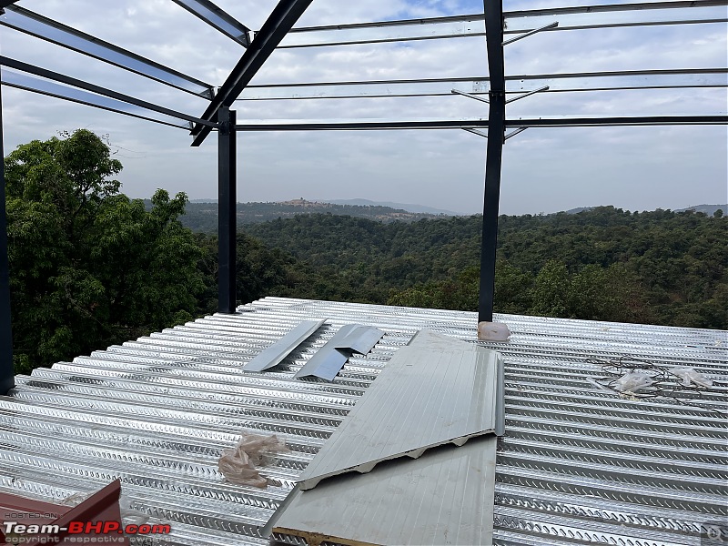

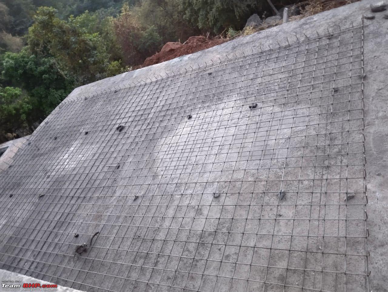

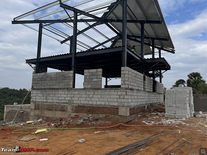

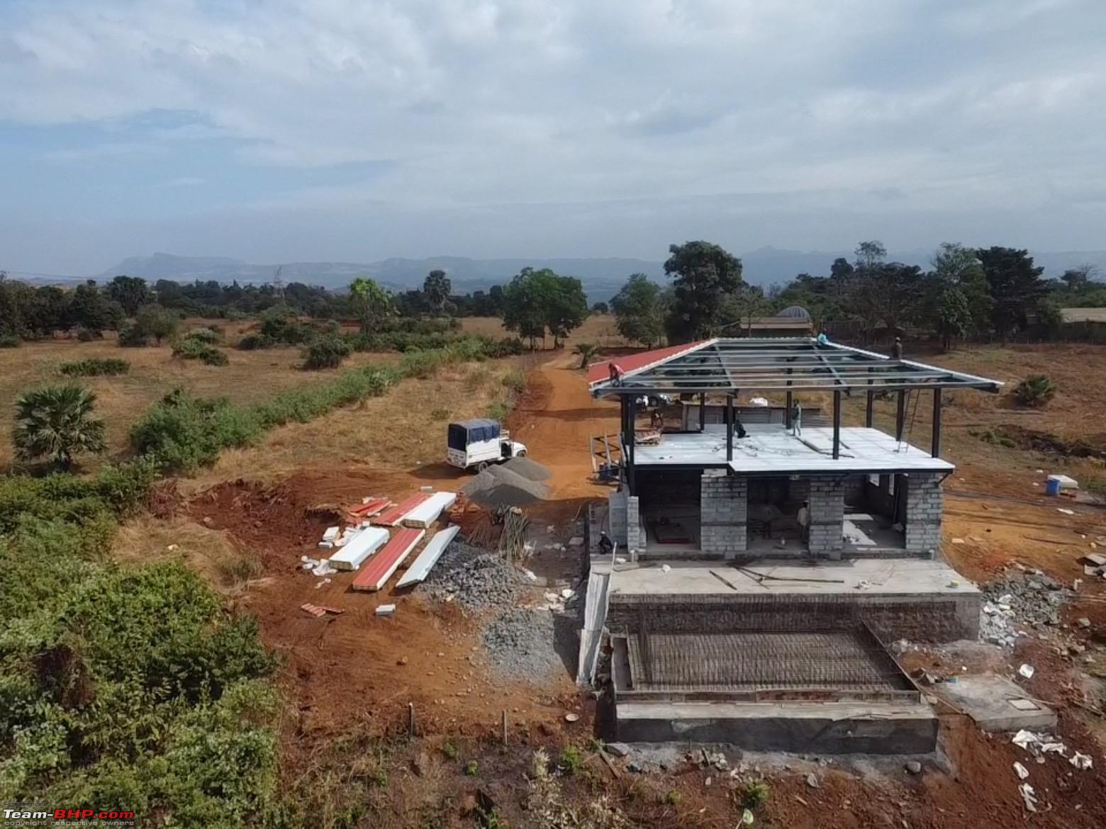

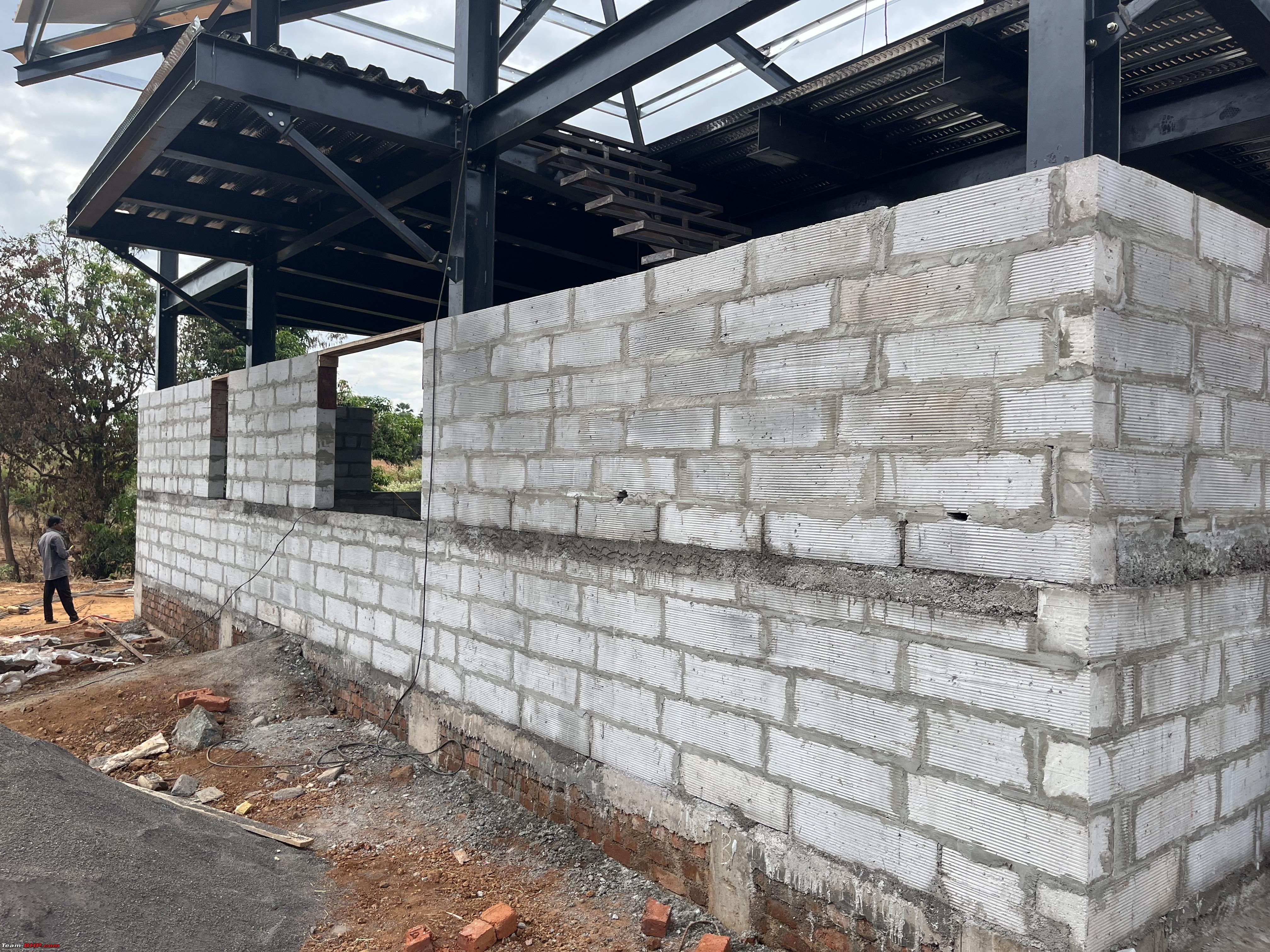

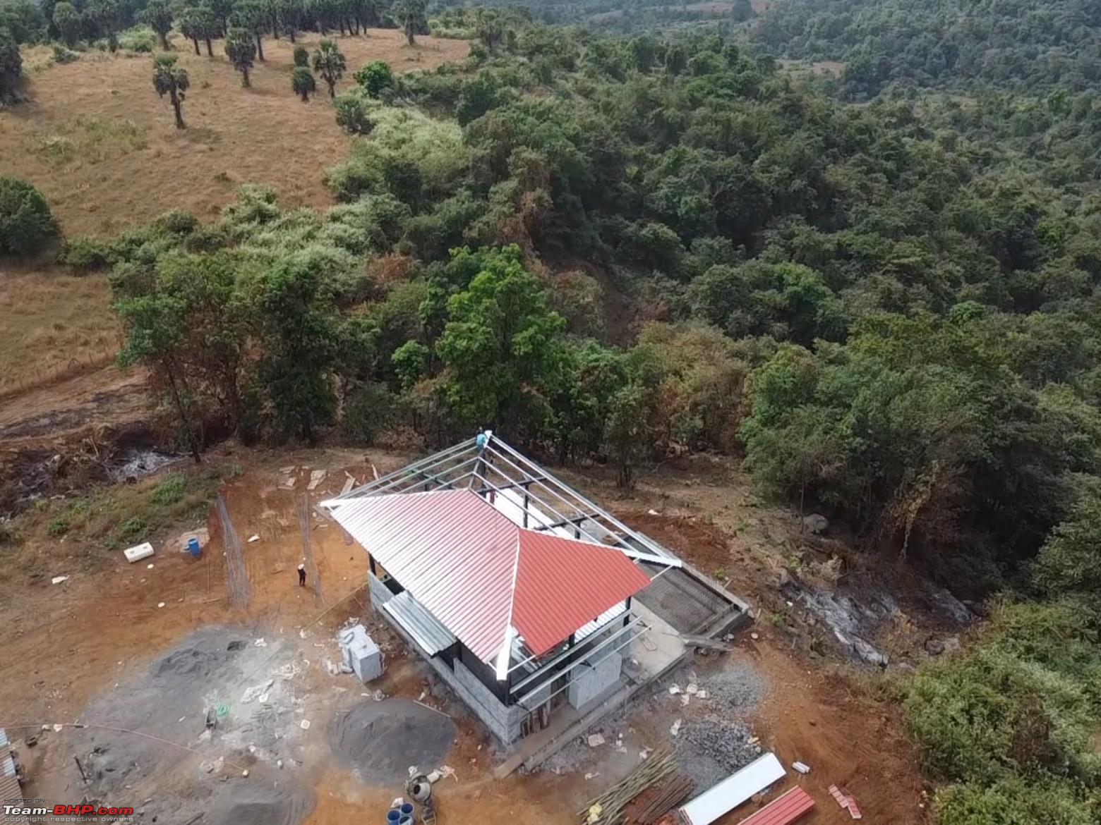

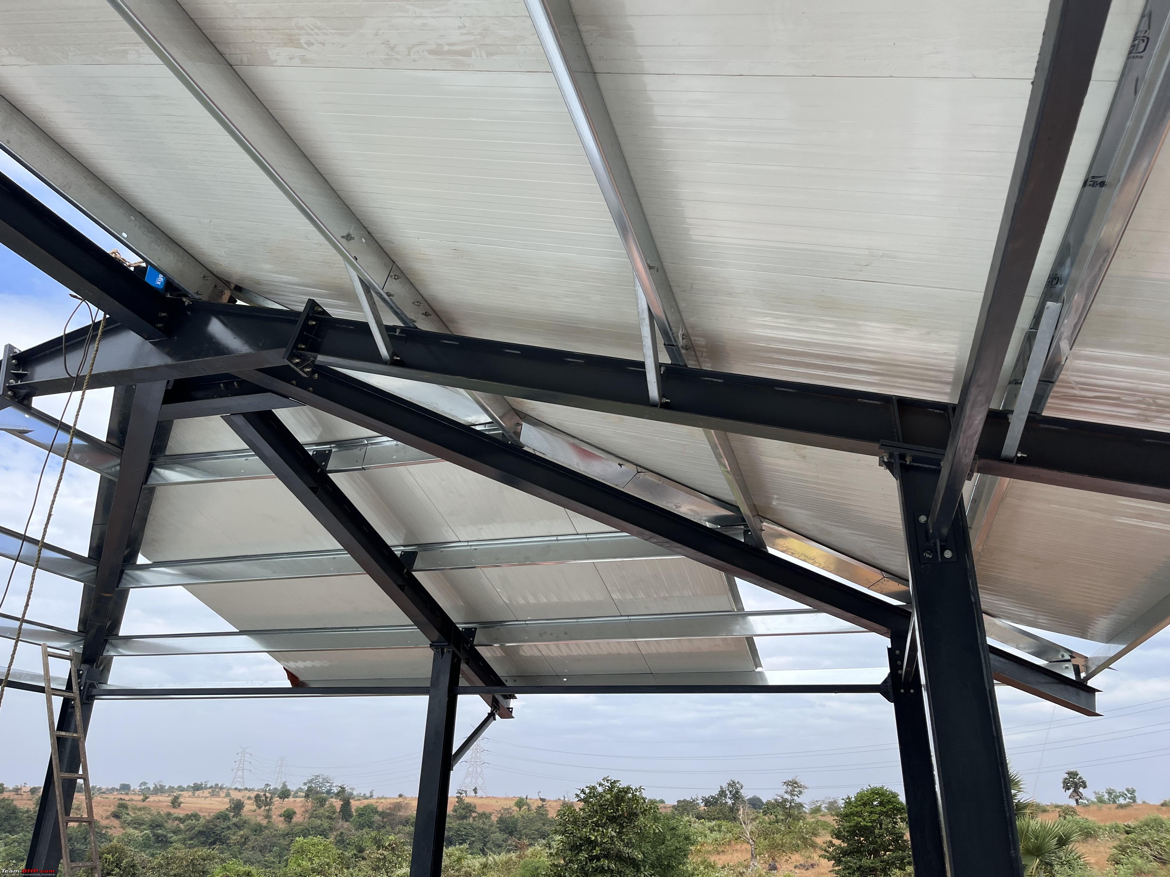

The work is progressing well. Exterior walls have started taking shape and the staircase is complete. The Swimming pool work is on, waiting for the vendor to lay the plumbing so that the raft and the walls can be cast.
The roof sheet is taking time due to four sided slope and sandwich puff panel thickness. The wastage is also very high.
Some Work in progress pictures
Swimming Pool
Constructing a new farmhouse | Complete greenfield project-swimming-pool-stone-bird.jpg
Constructing a new farmhouse | Complete greenfield project-swimming-pool-steel.jpg

Exterior walls

Roofing work
Whole building with swimming pool
Constructing a new farmhouse | Complete greenfield project-birds-pool-roof.jpg

A small video of the Roof work. The video covers process of installing 30 mm insulated puff roof sheets. The top color is terra-cotta and bottom is white finish. Being a 4 sided roof there was a lot of wastage but the end result is worth the extra penny. The roof is cantilevered out of the building by 5 feet on all four sides. The last drone video is pixelated need to work on the settings.

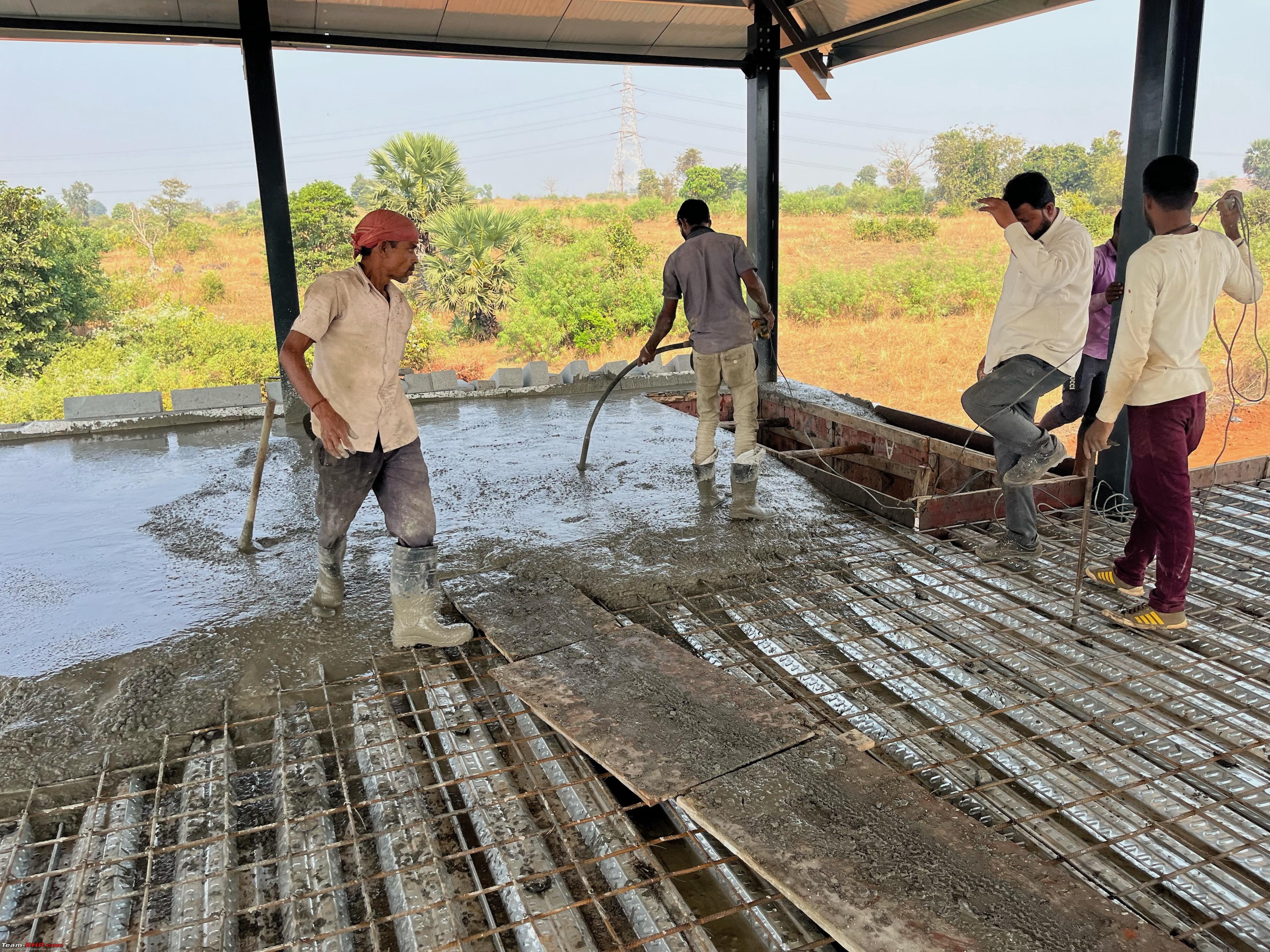

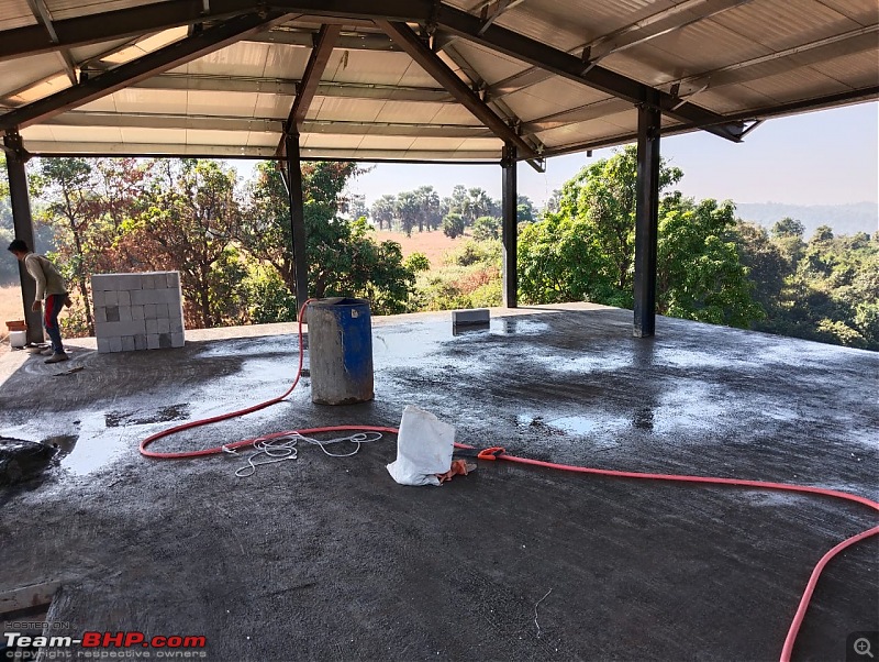

Latest Update,
The first floor Slab is finished and the brick work for the first floor has started.
Swimming pool RCC casting is finished.
The Ground floor walls are complete and concealed electric piping has started.
Marble window frame first stage is complete for ground floor.
Plumbing and internal plaster will start soon once the concealed AC copper piping is installed.
Short video of the Slab
Attaching some pictures.

Concrete work

Finished Slab
Constructing a new farmhouse | Complete greenfield project-slab-finiished-4.jpg
Constructing a new farmhouse | Complete greenfield project-slab-finished-1.jpg
Constructing a new farmhouse | Complete greenfield project-slab-finished-2.jpg
Constructing a new farmhouse | Complete greenfield project-slab-finished-3.jpg
Ground floor wall
Constructing a new farmhouse | Complete greenfield project-ground-wall-1.jpg
Constructing a new farmhouse | Complete greenfield project-ground-wall-2.jpg
Constructing a new farmhouse | Complete greenfield project-ground-wall-3.jpg

Swimming Pool
Constructing a new farmhouse | Complete greenfield project-swimming-pool.jpg
