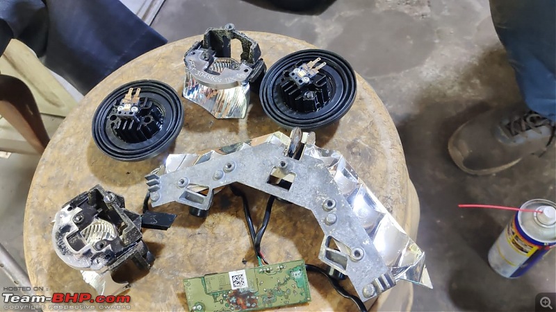

Now that we had eliminated the last of the gremlins on the 1199R, we went into overdrive. We opened the headlight casing and realized that water had entered into the circuit and the 2 headlight Leds were spoiled. So a new headlight was sourced from Ducati Italy.
Old headlight with damaged circuit board
How I saved India’s only Ducati 1199R | An unlikely find, revival and restoration project-img20230707wa0008.jpg
How I saved India’s only Ducati 1199R | An unlikely find, revival and restoration project-img20230707wa0013.jpg
New headlight from the mother planet
How I saved India’s only Ducati 1199R | An unlikely find, revival and restoration project-img20230728wa0050.jpg
