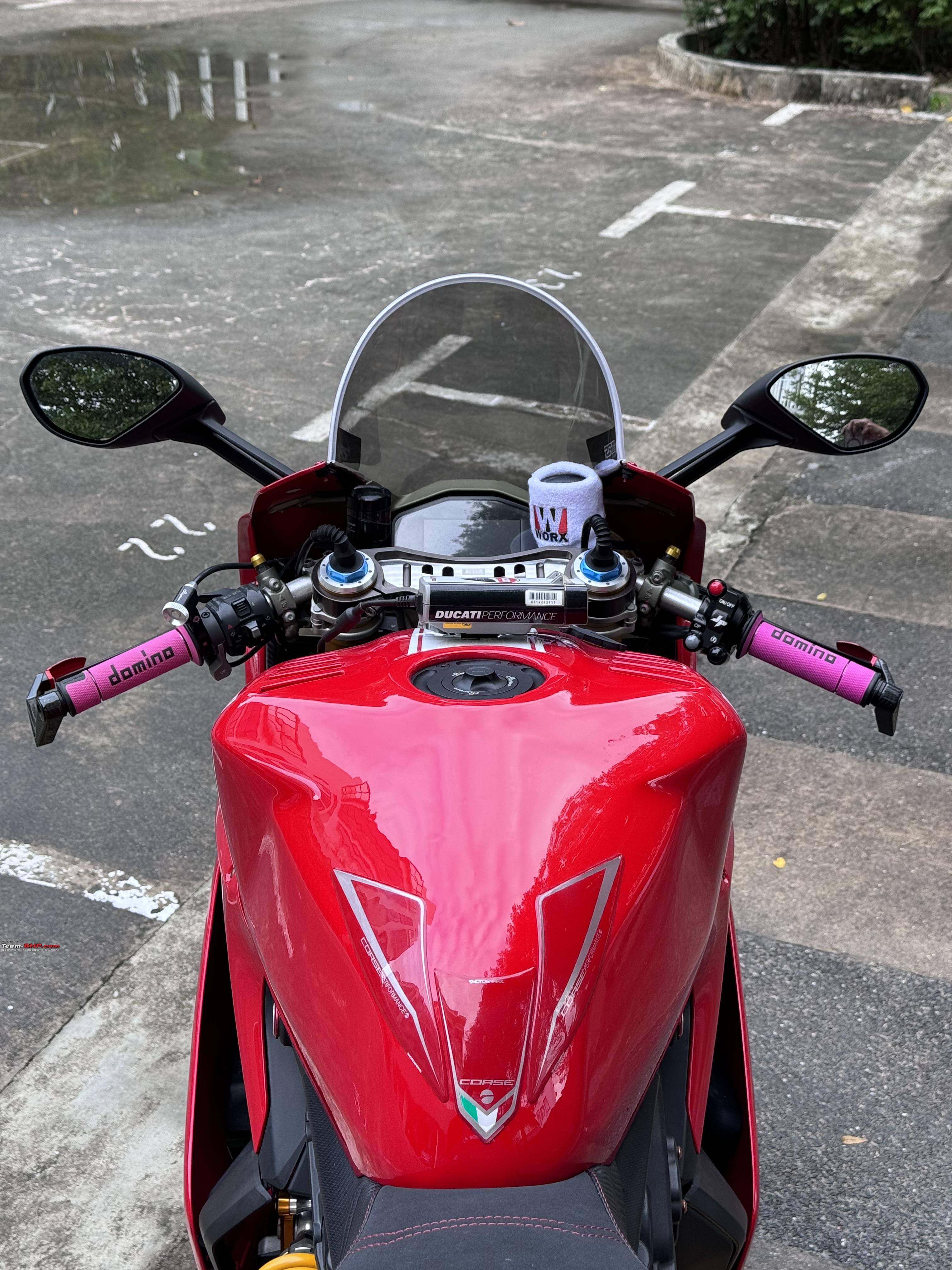

2024 - time to grow.
It is now exactly one year that the 1199R was torn apart and rebuilding commenced. Now that the bike is up and running, I decided to mod it a bit more. I was brainstorming ideas with my brother and wanted to add a few bits and pieces to keep myself sated. Well, I was steamrolled over. I am sure there are many of you who have an older sibling who listens to you and then decides to do whatever they think is best, taking you along for the ride and turning you into a spectator
Well, to keep matters short, my brother produced his aces and went overboard on this 1199R project.
He teamed up with a very famous design house in Italy that works with Ducati and sent out sketches of the front and rear fairings he penned for the bike. He sketched it out in MS paint and then worked with the designer to craft the fairings in carbon fiber and get them custom painted. Concurrently, one of Japan's biggest aftermarket parts maker heard of this 1199R story and decided to throw their hats into the ring. Over the past 6 months, after several iterations, everything was manufactured and then shipped. After all the pieces were installed, I am glad to say the 1199R has turned out to be something far more crazier than I ever expected. Let the pictures do the talking. I will comment on each picture and explain the rationale of the mods.
Working up from the bottom
The first thing to get updated was the entire tail section of the 1199R. The ABS plastic fairings were in good condition but needed a fresh paint and clearcoating. My brother simply got rid of everything and installed brand new carbon fiber fairings. When I mean everything - I literally mean every plastic bit.
Rear tail cowl, fairings, and air vents removed. Carbon fiber rear vent attached.
How I saved India’s only Ducati 1199R | An unlikely find, revival and restoration project-2.jpg
Carbon fiber tail ends and seat rest cowl attached.
How I saved India’s only Ducati 1199R | An unlikely find, revival and restoration project-1.jpg
Rear seat cowl attached The whole tail section is now custom carbon fiber. It's manufactured by Fullsix and custom painted in Italy. The number 23 inscribed on it signifies the rebirth of the bike in 2023 and also my brother's favorite number. You can see my brother is a controlling egomaniac . The fit and finish is perfect to the nearest millimeter. Designing decals on three separate pieces which are not mounted on the bike speaks volumes about how crazy good Italian painters can be.

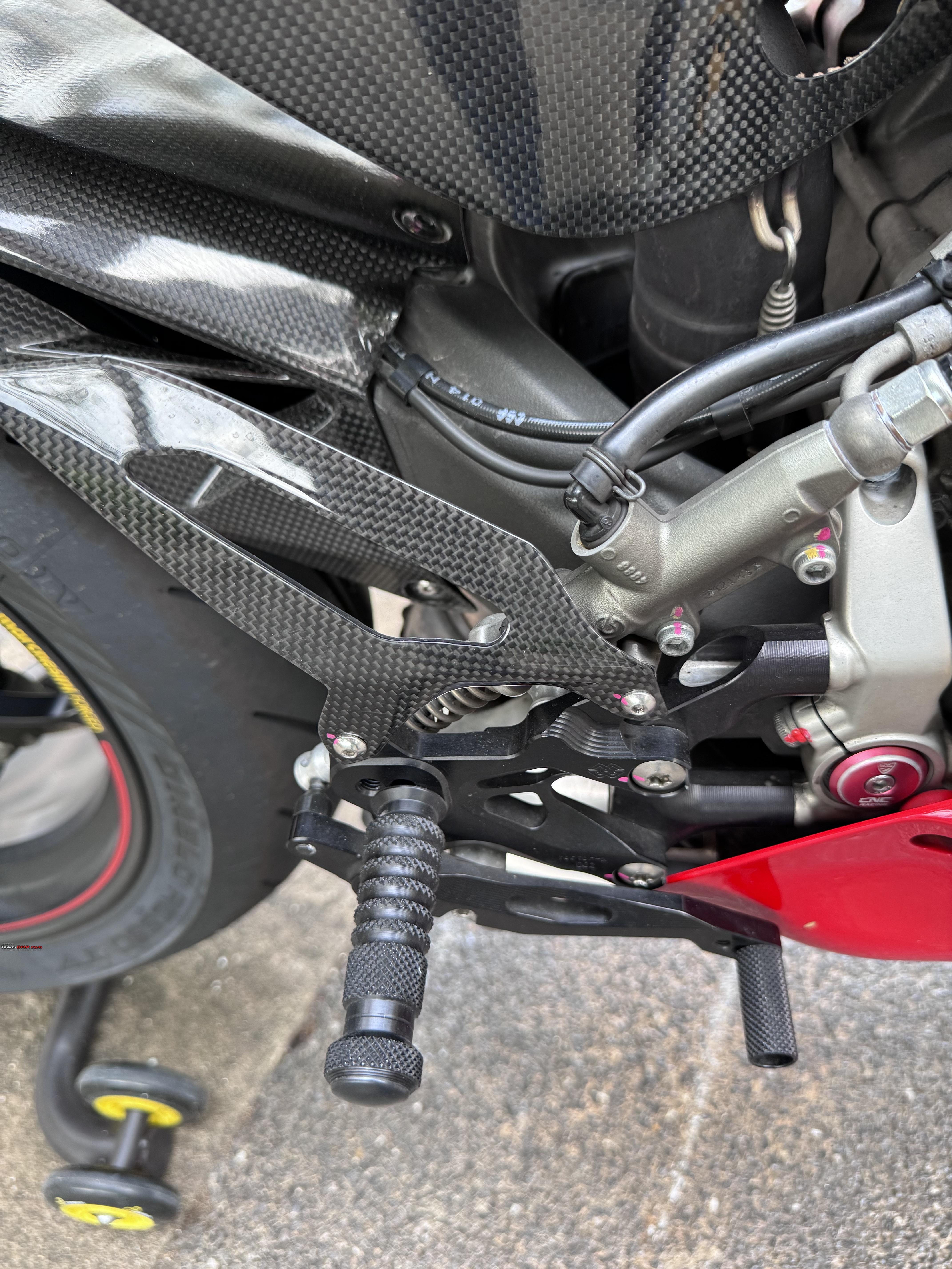

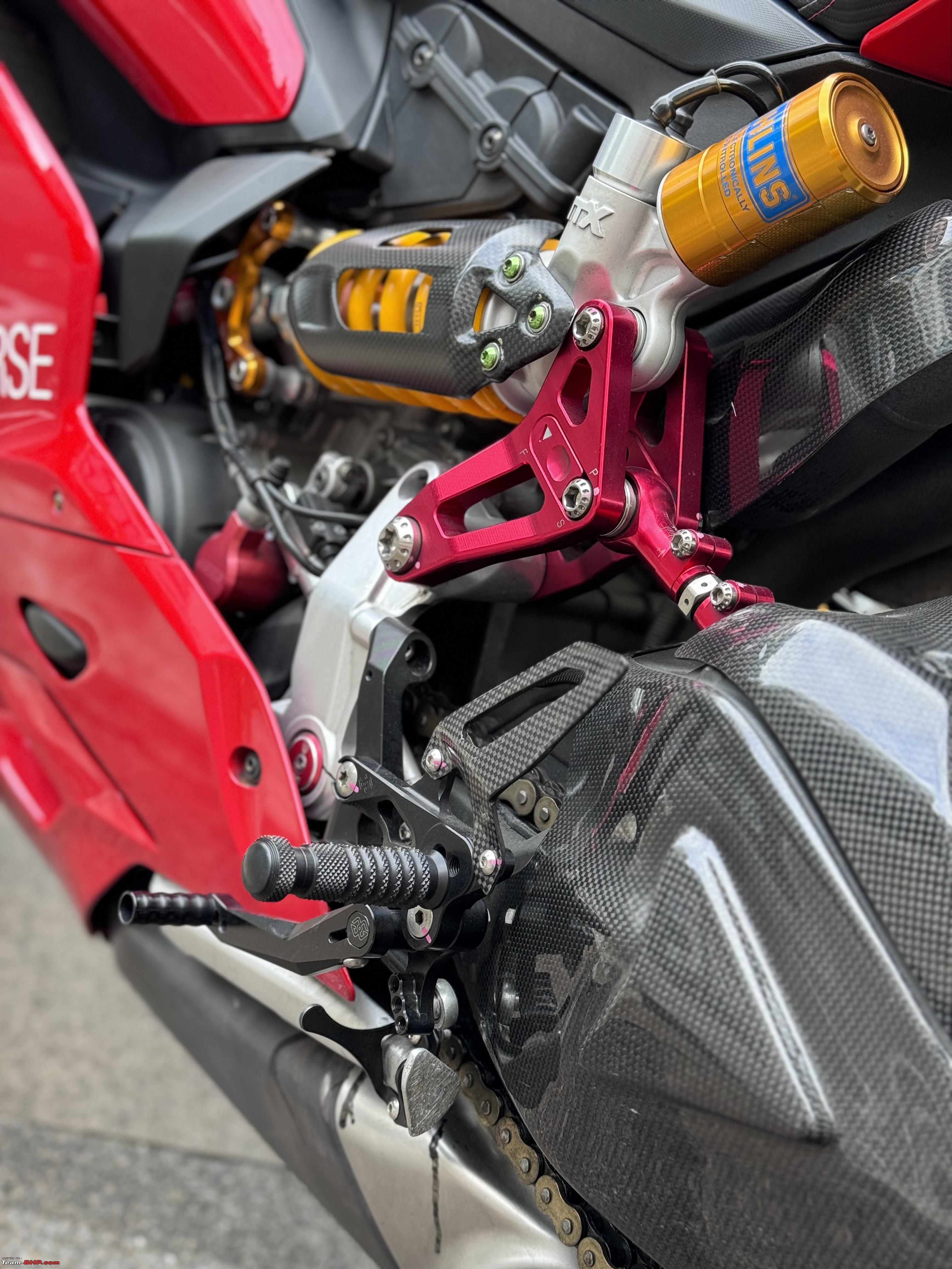

Next on the list were the rearsets. Years of abuse on the existing pegs meant they were in need of a serious upgrade. I have covered rearsets before in my V4S thread and always liked the Italian makers. Well, my brother proved me wrong. There is one company in Japan that does sublime stuff. They are the true godfathers of customization and each part they make is the stuff of dreams if you are into machining, lathing or cnc. They were piqued about this bike, and decided to collaborate a one-off piece. The red color on the rearsets comes from "alumite" which is anodic oxidation of aluminum that is done in Japan. The stuff is just droolworthy.
Aella - a company in Japan that makes manufacturing magic
How I saved India’s only Ducati 1199R | An unlikely find, revival and restoration project-4.jpg
How I saved India’s only Ducati 1199R | An unlikely find, revival and restoration project-10.jpg

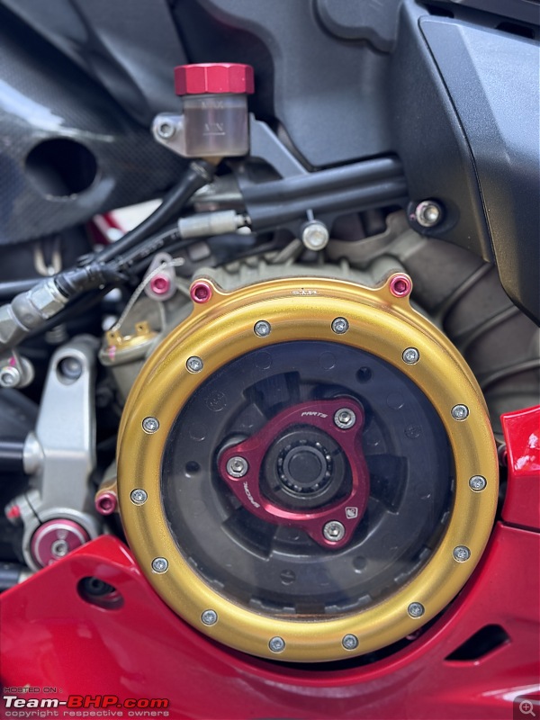

Along with this - small bits, like the oil filler plastic cap was swapped with a CNC Racing aluminum cap. Ducabike frame plugs were also added.
How I saved India’s only Ducati 1199R | An unlikely find, revival and restoration project-16.jpg

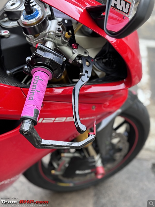

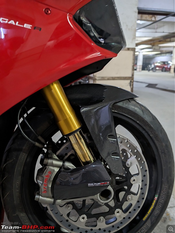

Brake caliper cooler ducts
I personally think brake caliper ducts prolong brake life plus they look super cool. This was something I wanted and got them.
How I saved India’s only Ducati 1199R | An unlikely find, revival and restoration project-22.jpg

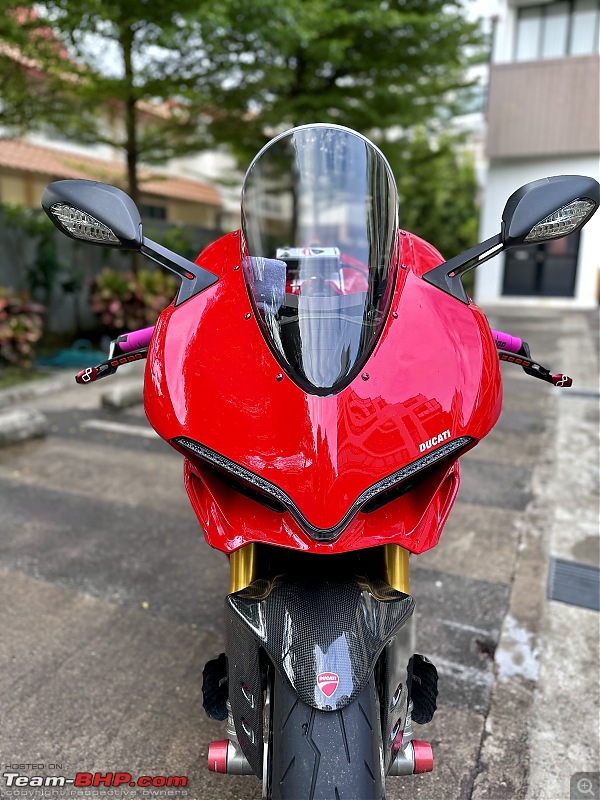

The final flourish for the 1199 was the front fairing. The OEM one had too many swirl marks, scratches and again needed a full repaint and polish. Also it looked dated. I wanted something that kept the element of 1199 back in 2014, but would be modern and reflect 2024. The design was meticulously chosen and created by my brother who has worked on the fairings for both my V4S and V4R. Well, after many months of ideas, the final product was created.
Front fairing removed
How I saved India’s only Ducati 1199R | An unlikely find, revival and restoration project-6.jpg
New custom carbon fiber fairing attached.
How I saved India’s only Ducati 1199R | An unlikely find, revival and restoration project-20.jpg
How I saved India’s only Ducati 1199R | An unlikely find, revival and restoration project-18.jpg
How I saved India’s only Ducati 1199R | An unlikely find, revival and restoration project-9.jpg
The decals signify the WSBK paint scheme used by Ducati back in 2014-18. It flows with the rest of the bike, creating three sections - a white fairing, red body, and black tail. The color combo breaks up the monotony of a red Ducati but keeps the looks of the 1199R exactly the same. You will not mistake it for any other bike.
How I saved India’s only Ducati 1199R | An unlikely find, revival and restoration project-12.jpg
How I saved India’s only Ducati 1199R | An unlikely find, revival and restoration project-14.jpg

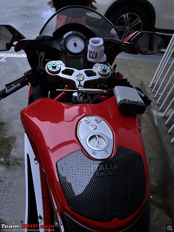

Wanted to share the story here. During Covid lockdown in 2020, he bought a 2006 Ducati 999 in Singapore and spent 2 years stripping down the bike to its basics, and then rebuilding it to the specs of a Ducati 999R. A bike that was last sold in 2003-2006, 90% of the parts are unavailable, and everyone knows 20 years ago Ducati was not really known for its reliability or its supply chain management. Anyways I digress. My brother shared pictures and videos of this rebuild and I decided to post it here, as an anecdote.
Backstory - 2006 base Ducati. The bike belonged to an older gentleman who used it seldom. Bike was mechanically ok, but needed work done.
Work done - Complete teardown and rebuild. New engine head and headers, gaskets, camshafts, Ohlins front and rear supension, STM EVO WSBK dry slipper clutch, monoposto aluminum rear frame, Bonamici rearsets, Brembo M4 Monoblock custom calipers, Matris steering damper, full custom painted Fila fairings and pretty much a whole boatload of mods and carbon fiber parts that I have lost count of. It took him 2 years to track down the parts, including a Ducati Performance Race ECU to couple with the Termignoni 57mm race exhaust that he installed. This is his road + track bike and it is one of the rarest bikes in Asia.
Enjoy the pictures of this rebuild.
The original bike
How I saved India’s only Ducati 1199R | An unlikely find, revival and restoration project-20211016_103038.jpg
Teardown commences
How I saved India’s only Ducati 1199R | An unlikely find, revival and restoration project-img20221008wa0011.jpg
M4 Monoblock calipers - custom made by Brembo
How I saved India’s only Ducati 1199R | An unlikely find, revival and restoration project-20230406_181350.jpg
Header work
How I saved India’s only Ducati 1199R | An unlikely find, revival and restoration project-20230406_181414.jpg
Rear aluminum frame for converting from a pillion passenger seat to race cowl
How I saved India’s only Ducati 1199R | An unlikely find, revival and restoration project-img20230406wa0001.jpg
STM EVO WSBK Dry Slipper Clutch
How I saved India’s only Ducati 1199R | An unlikely find, revival and restoration project-img20230615wa0029.jpg
The finished product
How I saved India’s only Ducati 1199R | An unlikely find, revival and restoration project-whatsapp-image-20231230-00.56.37_970c098d.jpg
