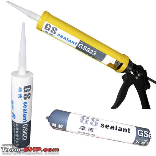

Undoubtedly a bad job in sealing the corners.
Originally Posted by m_upreti (Post 2821850)
Pls advise the solution / quick DIY which will solve the issue.
Since I do not have time to visit the A.S.S. due to work commitments this morning I did a DIY of sticking strip of double tape masked by black electrical tape (will share the pics tomorrow) over the beading on the outside in the hope that it will hold for some time.
Get some silicone gel and the gun.Something like the one in this picture, usually available at local hardware stores. Will set you back by a few hundreds and yes you can use it at home for other DIY jobs. So doesn't go waste if you are left with some of it.Apply and seal the leak ensure you don't over do it.
Thanks a lot, let me try this out. But it is not only the corners, the issue is the entire top portion of the windshield, in the last nights heavy rain there were 5 streams running from the top on the inside.
