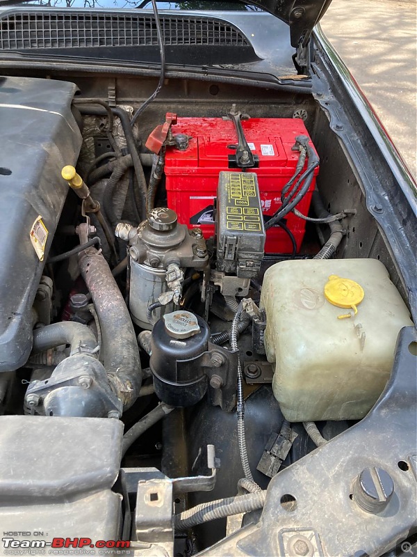

I have one issue that has been troubling me for the past few months. Yesterday (5/8) while on my way to office, I noticed the overheating needle go towards the red light area and the blinking started. As I was in the middle of peak traffic I had to drive in the same vein by switching off the AC and reached office parking. I let it cool and then opened up to see that the radiator and aux tank had gone dry.
I always keep a coolant can in the car and I topped it up with 1L coolant and then added mineral water for the rest as I had suspected that it would leak somewhere.
Today morning, I checked the levels once again and drove it to the service center. While the temperature was maintained, I noticed some kind of pressure blast inside the engine bay. My suspicions
1. I had initially though the hoses have gotten old, so it is leaking off. The hoses were changed 6 months back and it seemed to work well But,
2. Engine head gasket is still the OEM part and haven't been changed (nearing 1L KM ad 15 years). Maybe my suspicion is that this is the reason why the coolant levels are dropping.
Could it be a bigger problem?
Car is in the service center now, I hope I don't get a big bill. Fingers crossed.
If there was coolant sprayed in the engine bay that generally means that there is a leak in the hoses.
If the coolant is leaking into the cylinder, then the coolant will get mixed with fuel and is thrown out of the exhaust. It will not be in the engine bay. So from what you are describing, it seems like a simple case of a broken hose. Let's see what the workshop says.
