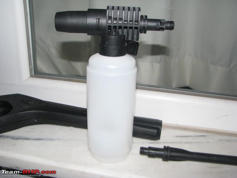

@Sagar -
Here's the attachment I use to generate foam - (pic property of original owner! I just borrowed it from the web as I'm currently not at home so couldn't click the pic of my unit)
It works great with any car shampoo, but it really produces some serious foam when a car shampoo that is formulated to produce excessive foam is used(available especially for foam cannons!!!)
But its still a bit behind what foam cannons can achieve

Sohail,
Can you explain, how do you use this blower. I tried, but could not get the foam.
Also which blower do you use ?
You have to try different soap:water ratios and make sure you use soft water/drinking water to dilute the shampoo in the foam gun bottle.
I use like 1.5Oz of GC car shampoo and take a little water (approx. the same qty as the soap or a lil more, mix it up and attach.)
What happens is, when you're using the foam gun, the mixture is pulled up, mixed with the water at pressure coming from the pressure washer unit and then aerated with the help of vents around the opening for the foam. The amount of foam can depend of various factors(hardness of water being most important, ratio of shampoo/water mixture etc.)
I always use soft water in my aquatak unit as it produces more foam + possibility of water spotting is reduced quite a lot.

Nice one.Are you able to achieve that level of foaming with your foam gun?I too have a bosch aquatec with a foam gun and use sonax gloss shampoo but not able to produce that much foam.its not even 30% of what is shon in pic
Also should we wash the car before using foam gun to spread foam over the car?
QUOTE]I too have a bosch aquatec with a foam gun and use sonax gloss shampoo but not able to produce that much foam.[/quote]
The case is same with me too. But i think the idea here is to use the proper Car washing foam to get the desired foaming (As in the picture by Sohail)
We cant get the desired foaming with Sonax. Other thing is to get the right level of mixing. I see that more water gets mixed to the shampoo, further diluting the shampoo. We have no control on the amount of water getting mixed.
However a proper foaming agent is always desired.
That pic of the foam is of what you can achieve with a foam cannon!
Foam cannon and foam gun are different. foam canon uses much less water, less soap but requires an additional air compressor to make the foam thicker and more fluffy)
The one run solely with a pressure washer like aquatak is a foam gun.
Less foam is normal for a foam gun. But you should try tweaking the shampoo/water ratios in the bottle and stick to the ratio that gives you max foam.
