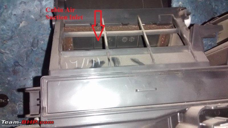

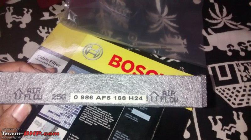

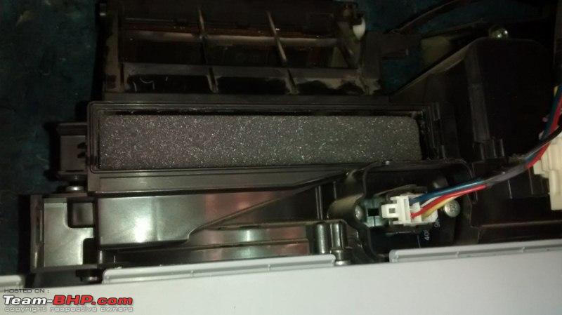

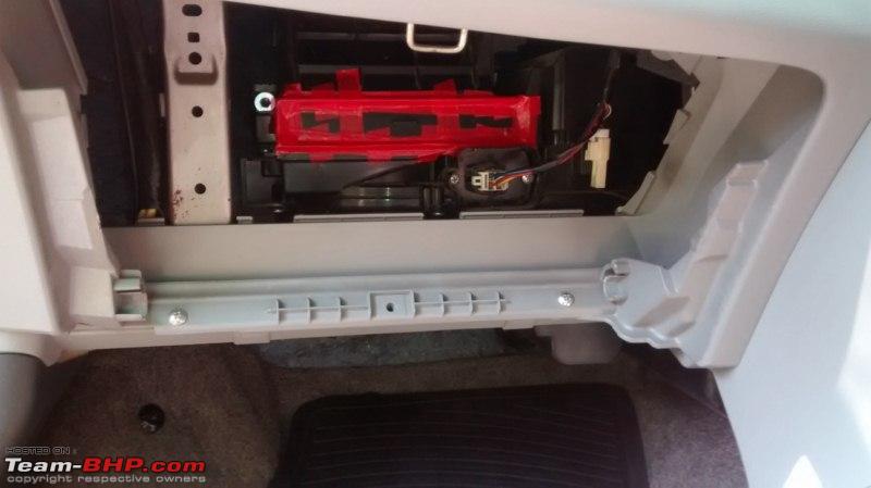

I spend two hours in grinding, crawling and long term killing traffic between office and home everyday on my dusty yet trusty Discover 135. With the aim of not shortening my life considerably I bought myself a NeoMask - mask with activated carbon cloth. The mask works flawlessly in cutting out dust and smoke while making the wearer look and sound like an intimidating baddy from the batman series at the same time. It has been a lifesaver and I will swear by it.
While sleepily browsing through the forum at around 1am I came across this thread and was super excited to learn about the activated carbon cabin filter.
On my way back from work I picked up a Bosch Activated Carbon Cabin Filter from Om Sai Motor. Their store is behind Total Mall on ORR, close to EMC2 office. The filter is meant for the Swift and it set me back by Rs.1300 but if history is anything to go by this product could well be worth its price.
In order to remove the glove box in the AStar push the stopper area in-words. This requires some effort since the glove box is pretty thick. The weight of the glove box surprised me. The small curved part at the hinge is delicate and can break while refitting the glove box so it pays, by exactly the same amount as cost of an AStar glove box, to be gentle.
Source of above image : http://www.kpauto.in
This is what it looks like in there :
Fortunately the plastic around the groove is thin. I was able to get through it with a pen knife. After making a wide enough opening I pushed a hacksaw blade in and cut along the length. Repeated the same on all four edges.
Out came the supposed-to-be openable lid :
In goes the filter. I was able to insert it with the foam pointing outward. The filter would not go in with the foam facing sideways. It is a tight fit and requires some shaking and coaxing to get in.
Placed the plastic back and taped the edges. A perfect factory finish fit isn't it?
Post fitment the blower air volume has reduced by around 30% at speed 1, 20% at speed 2, and 10% at other speeds. On the bright side the blower speed is same when blower is off.
At speed 1, I can hear the blower motor whine faintly. This wasn't the case earlier though.
I am yet to take the car out to notice any difference in air quality.

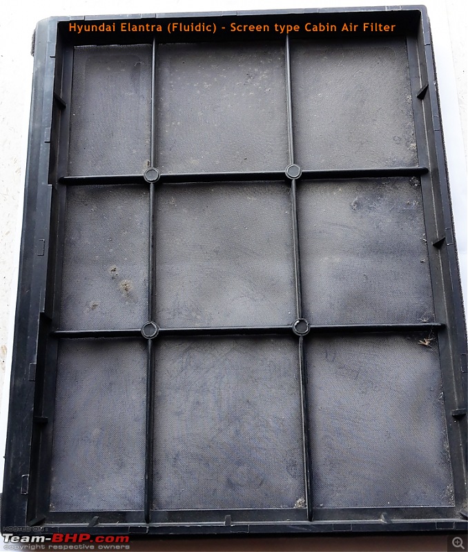

I recently changed the Cabin Air Filter on my Fluidic Elantra (ca. 2015). I noticed a lot of dust on my dash and was wondering why the ac was putting this through since I always drive with the windows up and climate control on (I alternate between re-circulation and outside air modes). I never noticed this amount of dust in my Skoda Laura, which I have driven for several years in a similar fashion.
I followed instructions in the Elantra Owners Manual to access the cabin air filter. I discovered that in India, Hyundai fits a screen type plastic air filter. This is possibly because it is more durable & cost effective since it can be cleaned and used for several years; however there is no way this large pores of the plastic (nylon?) screen can trap dust. It only traps small bugs/insects, leaves etc. This explains why my dash always seemed to get dusty. Odor was not a problem with me since the Elantra's Cluster Ionizer is quite effective.
I bought an Activated Charcoal HEPA type filter from Amazon (US) which is compatible with the Elantra and installed it in the car. Initial impressions are that the cooling & air flow continues to be good as before and it does not seem to put out fine dust. I will post an update after using it for a few months.
Pictures attached below of the OEM plastic screen type filter and the upgraded filter I installed. This is a relatively easy DIY job. The manual has instructions on how to access the cabin air filter and there are also a few videos on YouTube. YOu I would recommend such an upgrade if you live in the city or dusty/polluted locations. Retain the plastic filter so you can replace it temporarily when you give the car for service for e.g.
Thanks.
