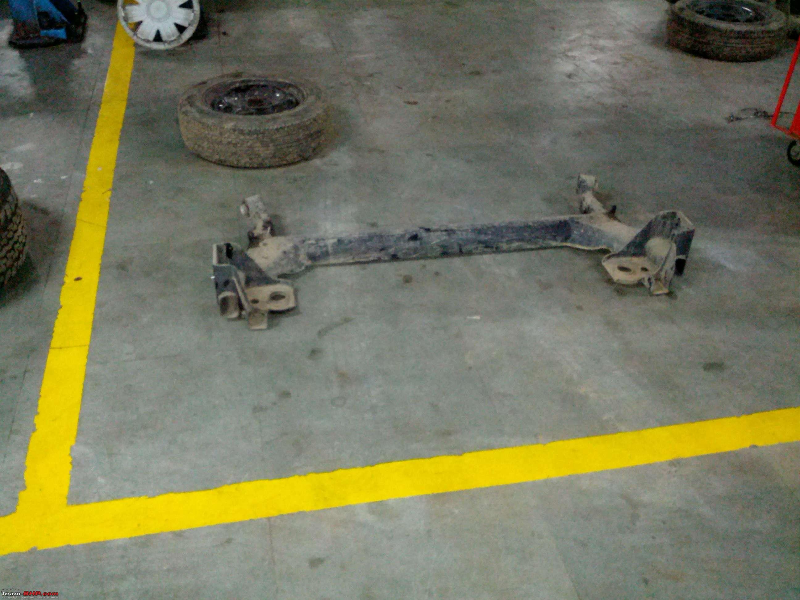

Got my RTB fixed yesterday at MPL in Perungudi.
Fixed an appointment on Tuesday for Thursday 2.00pm. But when I landed up there, they said they were FULL. I went into an argument with them because they ought to keep up the appointment. But they said they were helpless because people just drove in and they could not turn them away.
But after a lot of argument - I got them to take the car for replacement. And they offered a drop to my Office nearby.
I then called at 6.00 and asked if was completed - the guy paused and said he would return the call. He then called back and said that it just went for replacement and would be completed by 7.30pm.
When I reached the service station at 7.30, they were in the last stages of the repair. They did a 2 min test drive and handed over the vehicle.
If you want your replacement done, just drop in early in the morning and get it done. Else they will hurry up your job and it may not be perfect.
