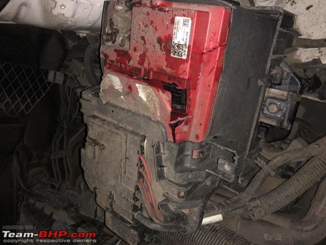

Stuck up in a live situation
Switched off my Vento Petrol on a 3 minute signal. As the timer subsided, cranked the car with the AC and Headlights off and bang comes an exploding sound. Opened the bonnet to see my battery ripped from the middle with acid leaking. Have towed the car to the side of the road with the help of police. The battery guy is on his way with a new battery.
What are the do's and don'ts before installing the new battery.
Attached pic for reference.
Car Battery: Dos and Don'ts!-8fbc1f2263a24edbb75756f1cda7b847.jpeg

You should be worried about the acid spill more than anything else. I hope you got the entire under hood neutralised with some alkaline wash!! You might want to do that many times over and keep a close watch for emerging signs of corrosion even at "unlikely" locations. An explosion can cause the droplets to travel to nooks and corners. You might also want to also escalate this to the manufacturer of the battery... it may have caused significant damage. However the situation is entirely recoverable with multiple washes and neutralisation. Wish you all the best and please update.
I think you were very lucky there was no fire! Looks like only the battery casing got ripped apart there. A fire would have caused much more grief.
I think you should evaluate a few things -
1) Where did you purchase that battery? Any history that place might have? If so, you'd be doing a great service to others by reporting it here and else where.
2) Is there any electrical issue with your car that might have caused this? Would be good to get some expert evaluation lest it happens again and they discover something faulty in the electrical regulations.
Any further update on the situation?

So an update after a week. The battery was three years old and under warranty. The culprit was found out to be a fault with the Alternator which was overcharging the battery and caused it to explode. Got the battery replaced and alternator fixed. The car is working fine now after multiple readings from the alternator.
Want your advice as to how can I neutralise the acid spill in the bonnet.

Few weeks or so back there was a mini discussion in one of them threads/posts about this very topic - acid neutralization. Don't recall exactly where it was - a brief search should bring it out.
That case had to do with someone that had put a battery in the trunk and the acid found it's way all the way to the rear seat and floor eating and corroding its way along.
The fundamental principle for acid cleaning is pretty much the same every place - do not touch with bare hands; do not inhale any fumes; let any wash through not spill on anyone's skin/eye etc; use a weak base to neutralize the acid; wash is thoroughly to dilute down or wash down any remnants.
I presume the service center guys have done something? After all, an accident from a faulty alternator ought to have been their complete responsibility. If not done already, you should also check/follow-up with them.
Miyata is offline   (1) Thanks
I HEARD from someone knowledgeable, that commercial "laundry soda and soap" diluted with water and pressure wash of the engine bay is what is usually followed. The "soda" part is important! He had a similar case, where the battery filler cap had cracked/leaked/cross thread, and there was spillage over days....from the earlier generation batteries. Car was a Qualis.
A good wash with regular water and maybe some soap and rinse should take care of this. Do it ASAP and ideally don't use too much of pressure and a top-down wash. Once done dry it off with compressed air and leave the hood open for a day you might want to do two wash cycle if the spill is bad.
