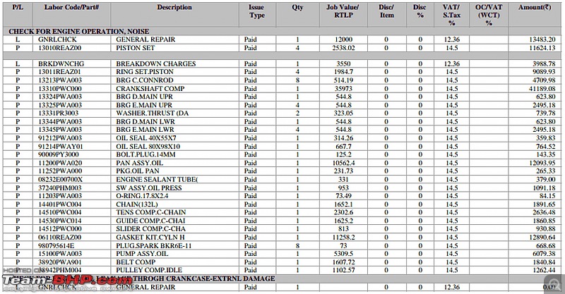

I just got the estimation with and without the engine block.
With new Engine block:
Without the new Engine block:

Why does the bill of materials say 8 spark plugs?
lapis_lazuli is offline
Old 19th October 2013, 14:51   #25
Posts: 98
Thanked: 21 Times
Do you have an iDsi engine? If so, then it had 2 spark plugs for each cylinder. Hence the 8 spark plugs
Is your engine an iDsi? If so then it has two spark plugs for each cylinder. Hence 8 spark plugs for 4 cylinders
