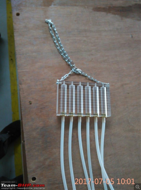

Saw these aids used in our campus to check the leak rate from the injector. These are being developed for OEM's and are prototypes for the moment.

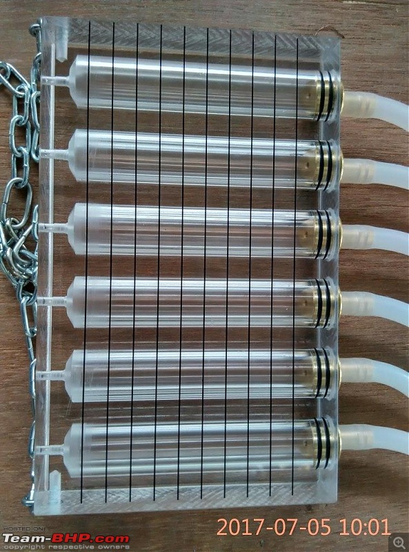

The below ones are more accurate than the above apparatus. The hoses are all calibrated ones and the cavity itself have been marked accurately. I could not see the actual way in which the leak rate is measured. If I have anotheroppurtunity, I will share here.
