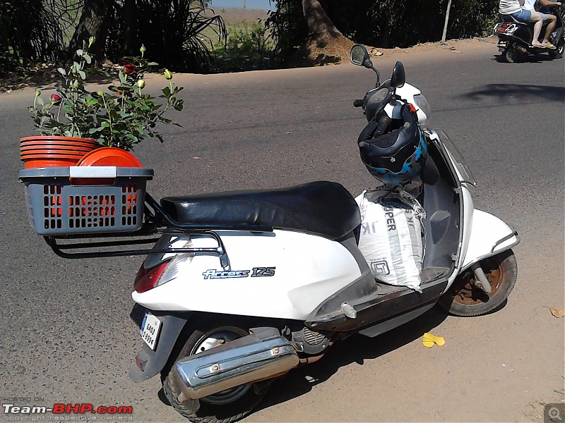

Stay safe. Hoping to get to India soon for up to 4 months (an escape from our winter). Flights and visas are starting to open up. Then its back to my trusty 8 year old (modified) Suzuki Access 125.
ECU Remaps : About Tools, Software & Tuners!-access-125.jpg
