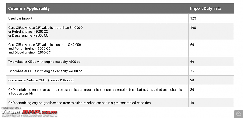

They must be importing the strut of the RS as a complete package and its very likely that the strut ships with these already inserted from the factory.
Or who knows they are importing kits in assembled form, I don't think they are producing/ assembling this engine in India so there will be no duty benefits, they must be Importing complete chassis and Engines which must be getting assembled here.
http://www.siamindia.com/economic-af...8&pgidtrail=20
Yes, it makes sense to import CKD the numbers are low, and the import duty too.
