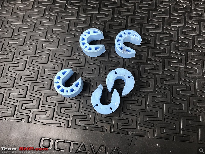

I know they had installed spacers in the suspension in some cars and forgot to remove them. I had received pics from a friend who took delivery from TAFE in Mangalore.
However, since I had gotten used to my car's harsh ride, I thought my car didnt have these spacers since the ride wasnt unbearable.
However, after another friend got his car 2 days back and checked and sent me details of how they have installed these spacers, I started having doubts.
I had already driven 4600 kms in total and I was in Calicut.
This morning, I went to my car, used the supplied jack, jacked up the front wheels and looked for the spacers. I found 5! 2 on the right side and 3 on the left side!
Skoda forgot to advise dealers to remove vRS suspension blocks (used for transporting)-img_8291.jpg
I found only 2 on the right side. So, where is the other one? Has it fallen off? Was it never installed? Falling off is unlikely as it is held by the strut boot there. Given it's a Skoda, it's highly likely that that half brained idiot who was supposed to install this, just installed 2 and forgot about the 3rd one.
This is how Skoda treats their customers who spend above 30 lakhs on their flagship sports sedan.
Absolutely appalling and atrocious. No other way to describe it.
Looks like I am in for a world of pain. It's been just one month and I'm already being reminded of why I avoided Skoda for as long as I did.

I found 5! 2 on the right side and 3 on the left side!!
Maybe he was supposed to install 2 on each side and decided since he had an extra one in his pocket he'll give you MORE!

Yes those are suspension blocks for shipping. Images from the third link i posted previously.
Skoda...

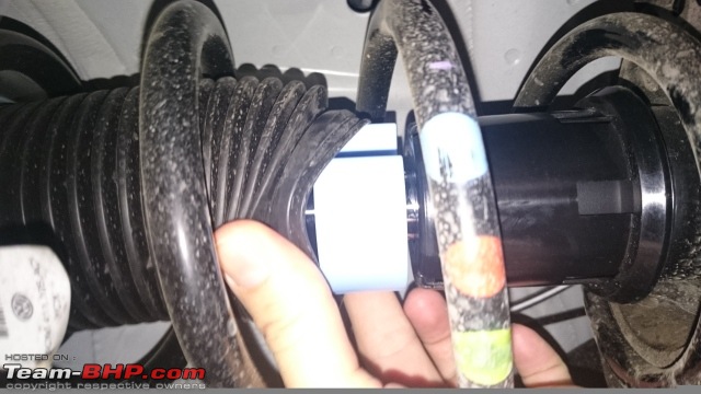

Sharing this screenshot I came across on Facebook (I believe from one of Nikhil's friends, via Jaggu):
Skoda forgot to advise dealers to remove vRS suspension blocks (used for transporting)-22221576_10155092967469211_2021006208475863205_n.jpg
Attachment 1682755
The strut dust cover/bellow should not be pulled down instead it should be pushed up to remove the blue buffers. Some jiggling and even the top one should fall down. Patience is the key. Reason is the rubber dust cover is held on tight at the top and not secured at the bottom. When its pulled down from its seat there is a very good chance that the cover won't fit properly and eventually falls down exposing the top part. When assembling the strut the cover is put after the bumpstop and cover put after it. Here the dude has pulled it down right over the bump stops and taking the buffer out through the top enlarging or maybe tearing the hole on top of dust cover.
What a bunch of idiots! When at Skoda
This is the order it goes on and comes apart*.
Buffer/spacer should be removed from below the cover. 3 shouldn't slide down 2!
1) Strut
2) bump stop
3) Dust cover
*Image just for reference. Install order is the same for parts 1 to 3 in almost all mcpherson struts
Edit: Haha just read whats written in the pic above. Ok so its not Skoda.
