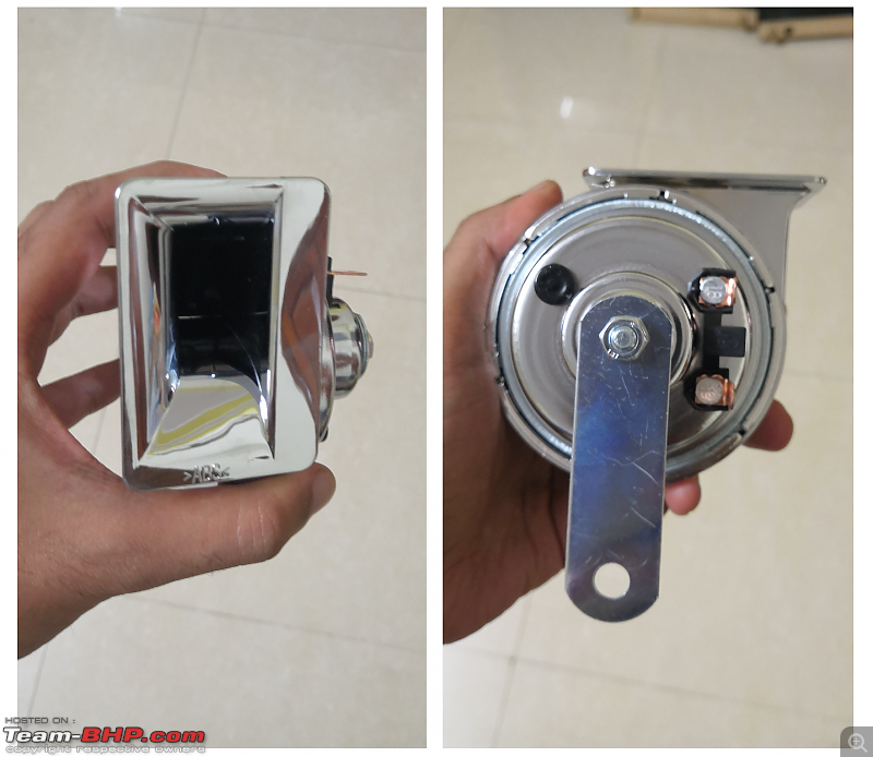

Review: Hella Chrome Trumpet Horn Set-mounting_bracket_trumpet.png
Left: View of the Trumpet and Right: Horn with the Mounting Bracket

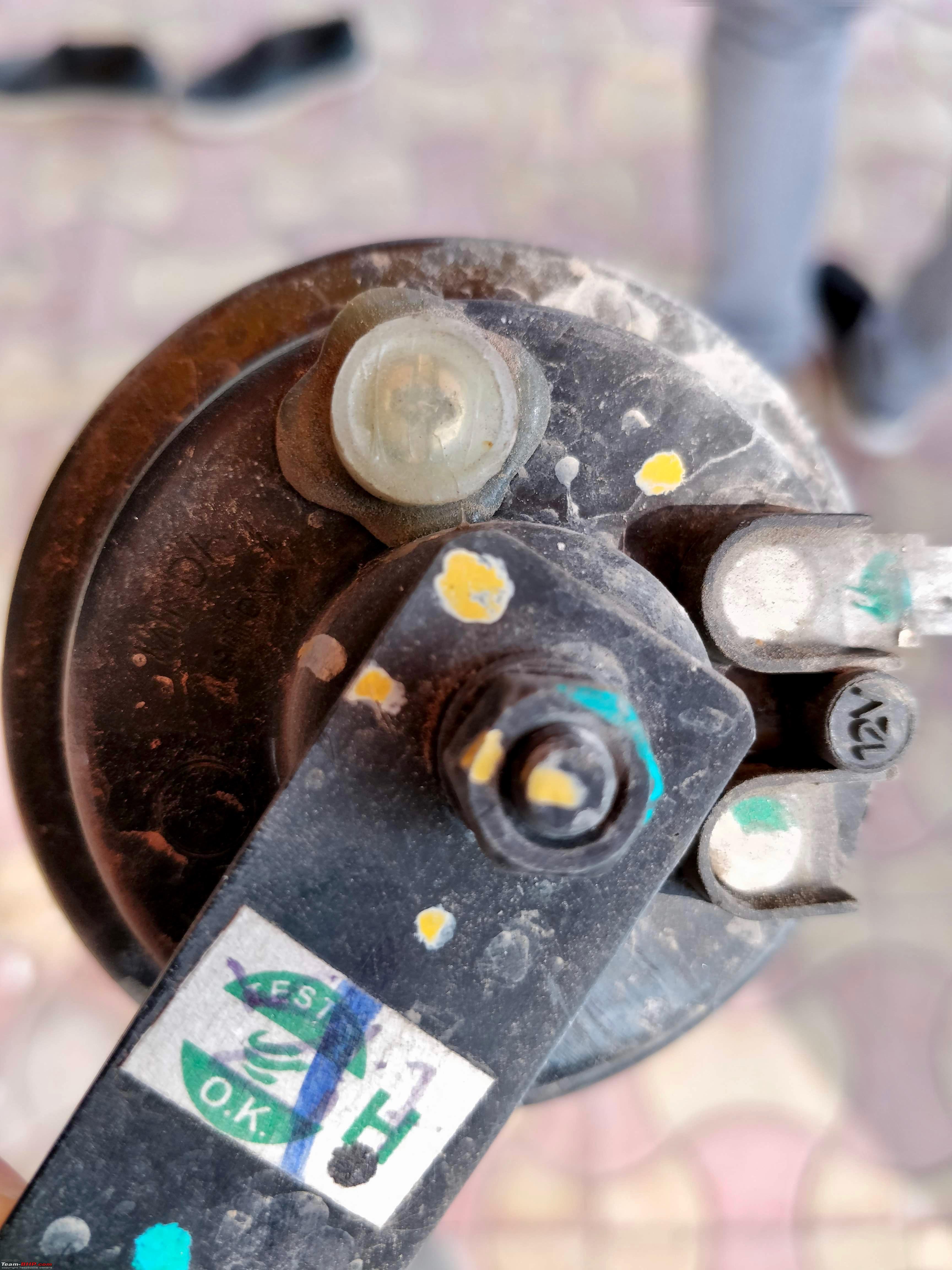

Review: Hella Chrome Trumpet Horn Set-stock_horns.jpg
Stock Horns After they were removed: Hella S70
Review: Hella Chrome Trumpet Horn Set-stock_horns_reverse_view.png
Stock Horns - Addl. View with Low and High marking shown
After this, we checked in the box packing but no other cables were provided. Realized that we did not have the wiring needed for connecting the horns. So, the technician from Neptune Carz had to step out and bring the required wiring.

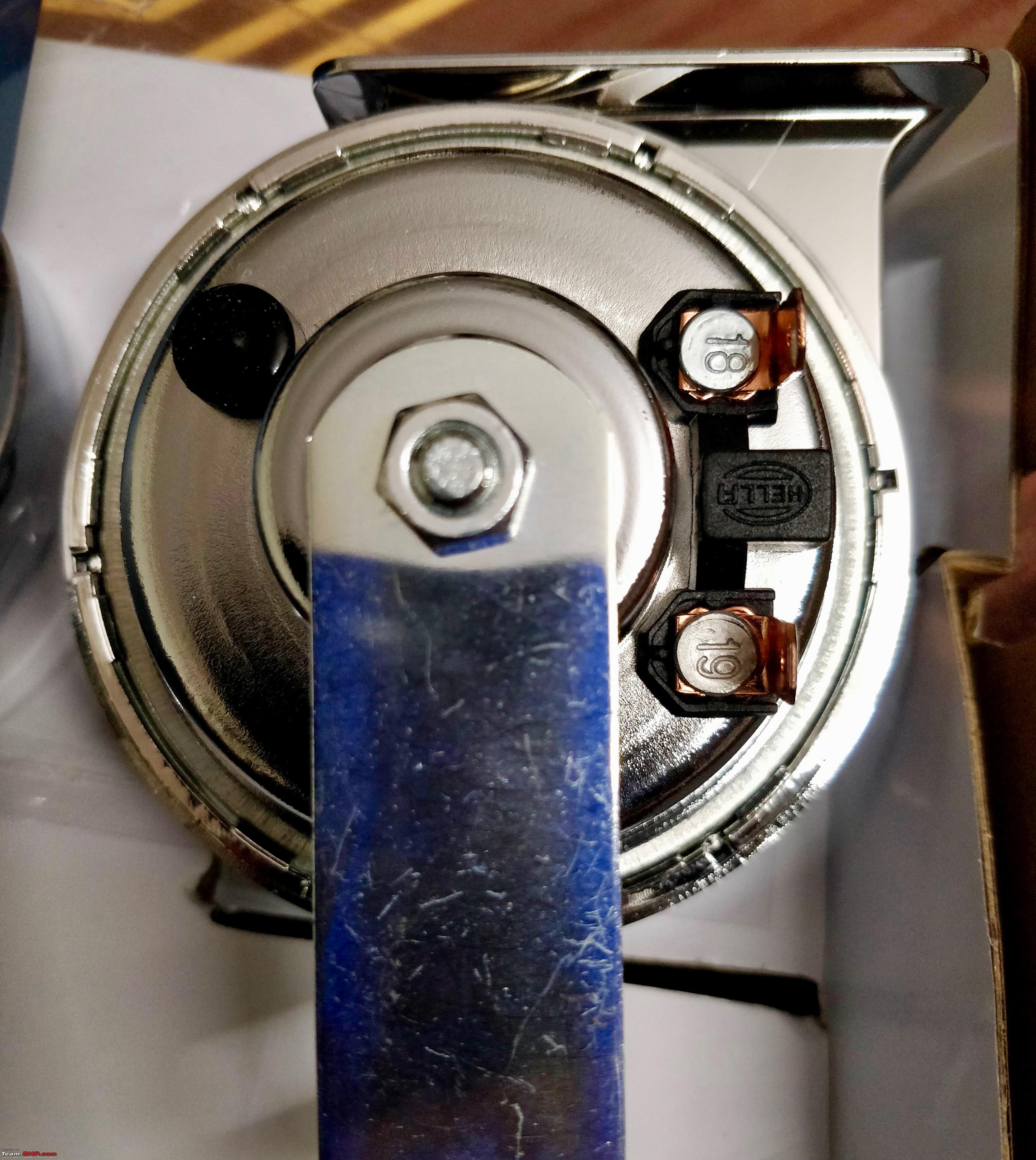

The only confusion was around the "Honda Socket" and required connectors.
Got those installed on 15th Dec and to my surprise the installation was not as cumbersome as I thought it would be. Looking at the stock horns of VSRIVASTA in the first post, I was under a huge dilemma on how to deal with the socket.
Placed an order for the socket suggested earlier in the post #2 ( https://goo.gl/6BE9ar ) just to cancel it before it was processed.
Enquired at few car accessories shop nearby and everyone (but one) acknowledged the special socket for Honda City and mentioned that they would need to splice the wire to get the job done . The only shop that didn't specify the same told me that they have the required sockets available with them and if needed they would be able to use that to avoid any splicing as well. On getting this assurance from them I cancelled the order and decided to give it a try with them once. I went there with a mindset that if the shop owner later tells me that the connectors are not compatible and they would need to cut/splice, I will just take a good look at the stock socket and try to procure the necessary connectors first before giving it a 2nd try.
Called up Ilyas from Top Gear Car Decors in Kondapur, Hyderabad ( https://goo.gl/MqC6bz ) and fixed an appointment for Saturday afternoon. At the outset he looked very confident and appeared to be knowledgable about what he's doing. He heard the horn a couple of times and mentioned that the bumper need not be removed and he will first try without removing the bumper & he managed to do so.
I was curious enough to see how that infamous Honda Socket (that I always read about in posts and seen in videos or photos) looks like. I was due for a disappointment as the current generation of City does not have a similar socket as the 2014-2016 model. It looked like a horn with universal sockets. Also unlike post #1, the stock horns were not Hella S70 horns. It was a Minda made pair of horns.
Review: Hella Chrome Trumpet Horn Set-09.jpg
Review: Hella Chrome Trumpet Horn Set-10.jpg
One of the horns (I guess the Low one) was a direct fit.

However, the other one in the stock horn had just 1 pin.
Review: Hella Chrome Trumpet Horn Set-11.jpg
Review: Hella Chrome Trumpet Horn Set-12.jpg
Ilyas connected the other pin to the ground to make it work. There was no cutting / splicing done and the entire process was complete within 10-15 mins. They accessed the High tone horn by removing the fog lamps, which resulted in a decent amount of time and effort saving.
