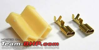

Hi,
As we are struggling with low sound horn, I am posting some picks for ease out this. We have to remove bumper (), mentioned link will help you to get the feel of it.
First you need to remove bumper and you can see the pics for location of horns. It has single pin socket as mentioned in pics. I didn't clicked pics for fitment. you need to take wire from output to back of horn and tie it up with bolt and another one you can use scotch lock and tie with this socket.
Honda Jazz : Official Review-20150902_122408.jpg
Honda Jazz : Official Review-20150902_122419.jpg
Honda Jazz : Official Review-20150902_122415.jpg
Honda Jazz : Official Review-20150902_123602.jpg
Honda Jazz : Official Review-20150906_171809.jpg

Thanks for the great help bro. Can you please help me with the process of connecting wires? i.e, from the horn socket to the new horns? Is any wiring harness available for that? Please advise.

You need three things along with horn.
1. Connectors.
2. Scotch Lock
3. Wire.
First use connect connector to wire and make set of Four. Connect one set to one connector of each horn. Now tie this wire on nut bolt (which is being used to hold the horn), this will give earth to horn.
Now connect second set to horn and push the sleeve of horn wire a bit, you will see the wire. You need scotch lock and insert your wire which you connected to horn on hole marked as black lines. Its a dead end portion of scotch lock. And another side marked as blue in pic, but our horn wire (where your horn was originally connected) which you got after moving sleeve a bit. And keep the wire on blue marked side and close the lock.
Now press the horn button and check.
