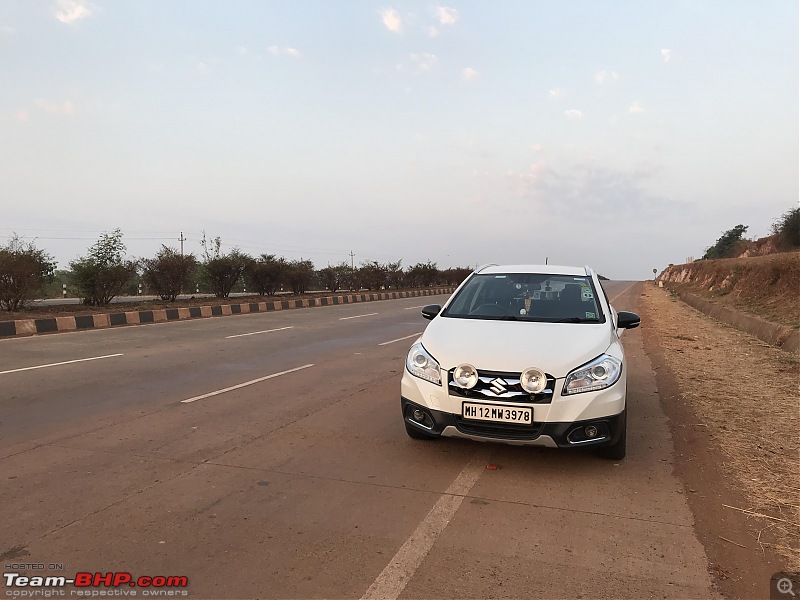

I have an S-Cross 1.6, comes with HIDs. Was never Impressed with the headlights. I did replace the fog lamps with an HID with Projector set up which somewhat helped me out. I went ahead and Installed aux lights (Driving type) which houses a 100W halogen bulb. Pretty happy with the setup. Planning to upgrade to Hella Rallye 3003 (Pencil beam).

I I went ahead and Installed aux lights (Driving type) which houses a 100W halogen bulb. Pretty happy with the setup. Planning to upgrade to Hella Rallye 3003 (Pencil beam).
Among 500FF and 700FF driving lamps, it's the 500 that's more useful as the 700 feels a bit too narrow for highway use although it is a driving lamp. Will pencil beams help?
The reason for opting for a pencil beam is, the stock headlights along with the projector fogs on my car take care of lighting up the near periphery, Pencil beams are ideal for longer throw especially on highways.
