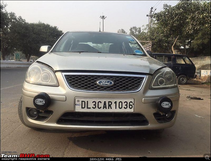

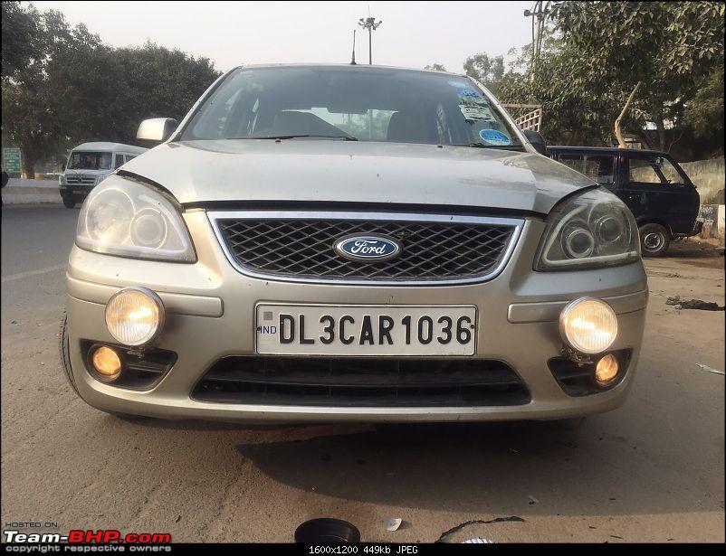

Thats what I meant. The sheer headache of of the 2-3 months it takes to get the lights just right is pointless. I tried multiple sets of projectors, and settled on these aux lamps, 35w each.
However, the fiesta had very good stock lamps, just that mine were completely screwed by age as well as me. The best solution came with a set of brand new headlamps. In the meantime, the aux lamps served me sufficiently enough.
No issues with cops.
To the OP: you could buy 27w LED lamps as well from amazon.
