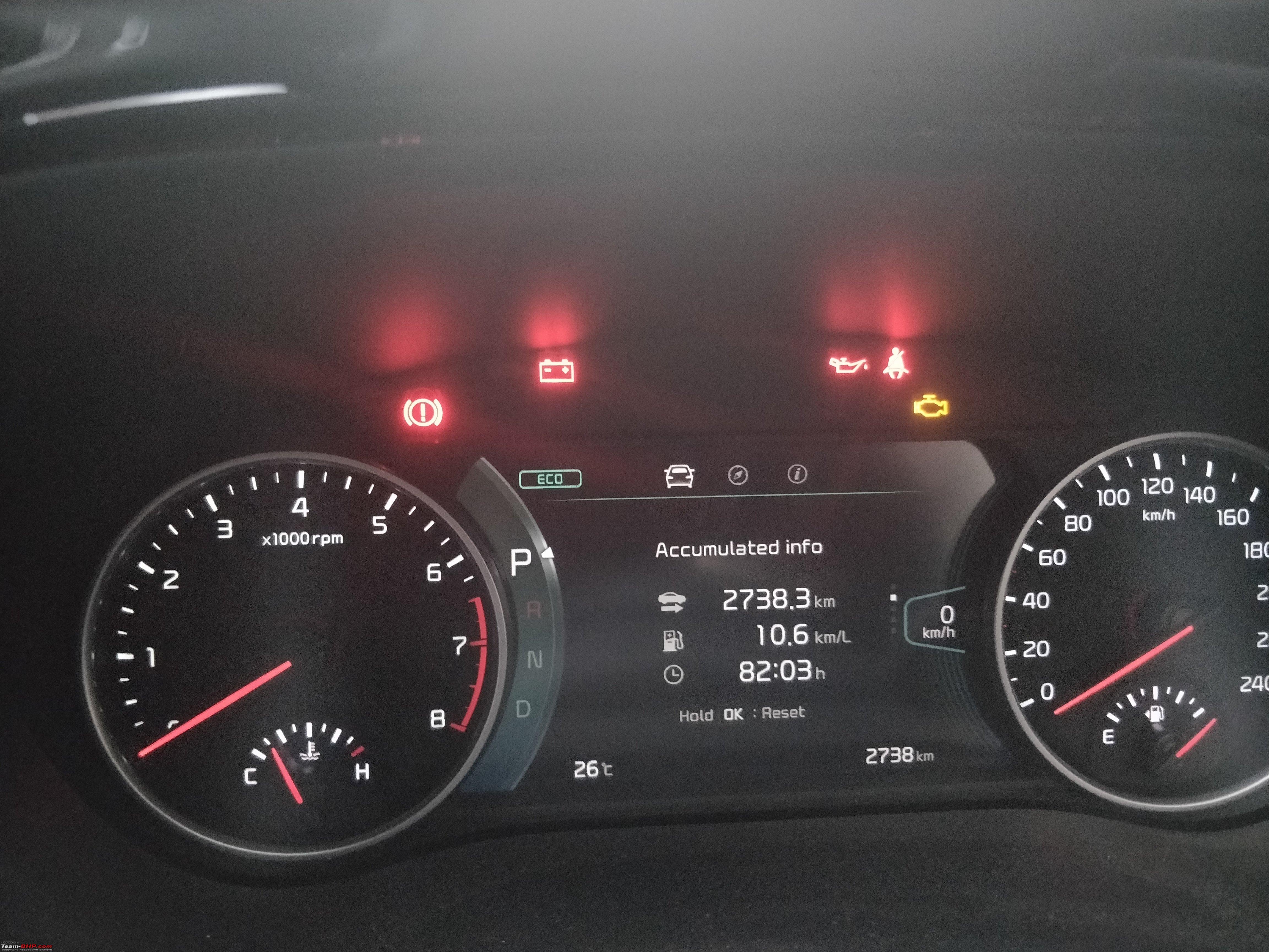

Sorry about the delay, here are the steps with pictures.
1. After the software update, when you toggle between the tyre pressure/compass you will see this "Accumalated Info" as the third option.

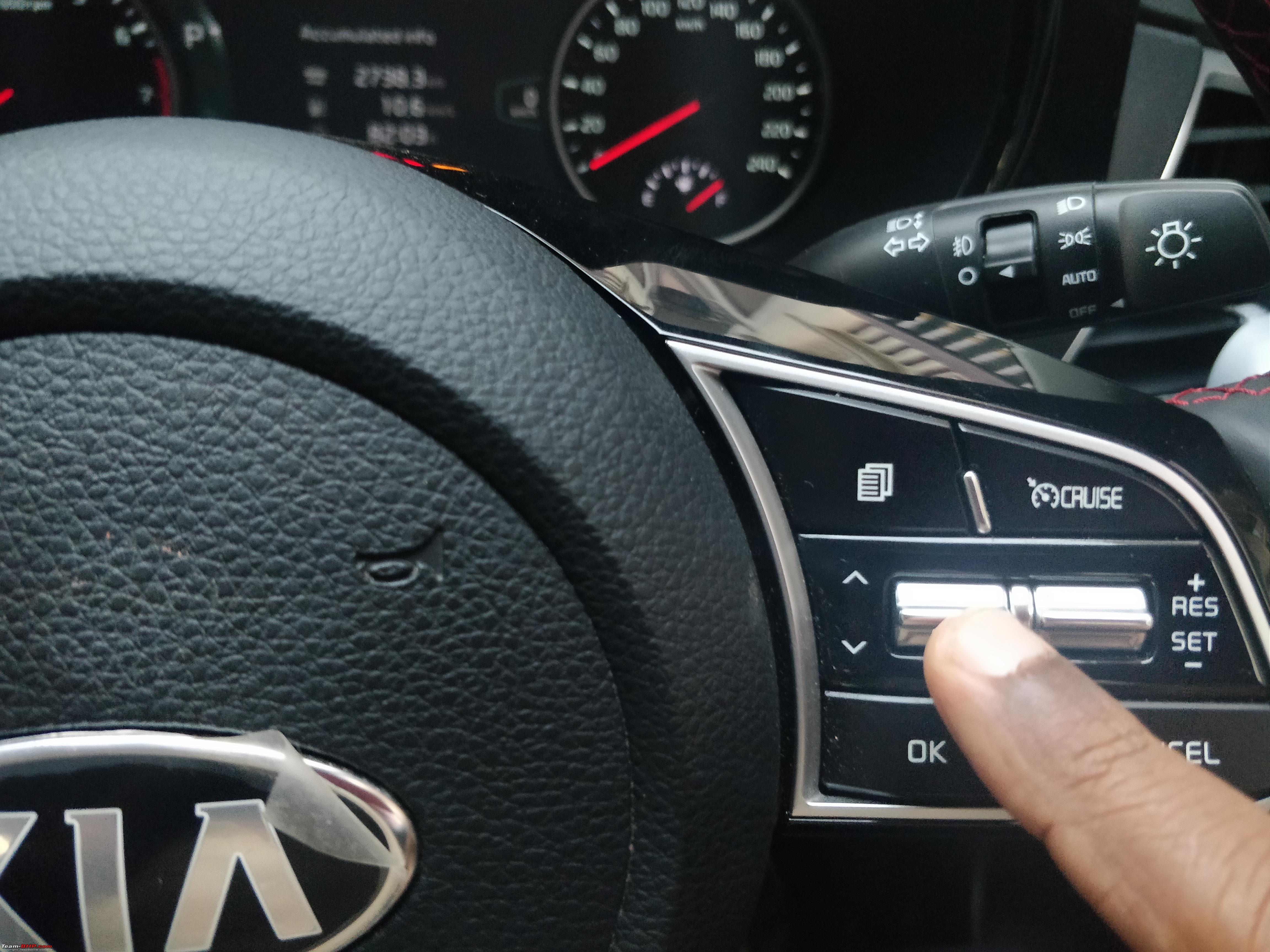

2. While on this screen (the third option), down press the silver knob shown here.

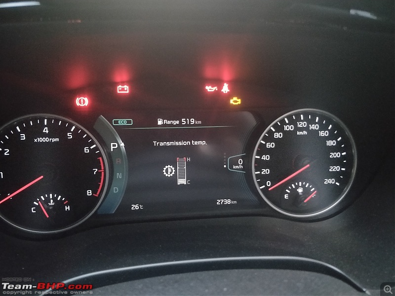

4. Last option is the "Transmission Temp.".
5. When on the "Transmission Temp." screen , press the 'OK' button as shown in the picture.
Now when you toggle, you will see the Temperature Guage.
