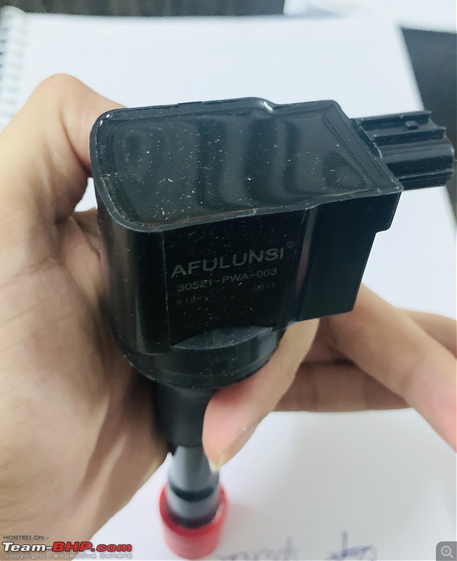

Hi everyone. My 2008 Honda City ZX i-DSi CVT had been giving jerky acceleration on rare occasions till a few months back, which have now become very frequent. Checked my ignition coils and 3 of 4 are showing signs of misfire. The A.S.S. quoted for Rs 5,500/- each. I contacted my local ones and they are not able to obtain them. So I placed an order for genuine Hitachi from China using AliBaba and throughout the shop representative had been in touch with me. Today, when I got the delivery, I checked that it was some local Chinese. I had asked the representative to make sure that genuine Hitachi’s were sent and now he is being all innocent about it.
Luckily I’d ordered just one, but it was disappointing for me. So, I’m not willing to place more orders from him.
Since the OEM would set me back by 15k on a car with 3 years’ life remaining I wouldn’t wanna spend that much especially when other running parts are due as well.
1.) What options do I have? If any Hitachi, Delphi or Denso seller is known anywhere in India, then let please me know. I have also checked BoodMo etc.
I dropped the idea of procuring scrap from Maya Puri (Delhi) as the coils can easily be polished to remove its misfire signs.
2.) How do I know that this particular chinese coil would be of any use to me? If I replace one faulty coil with this one, can I expect some change in misfire?
: One coil is perfect, two are misfiring at times and the fourth is this chinese one.
HONDA OEM part number : 30521-PWA-003
Jerky acceleration - Is it the Ignition Coils?-751e370172d8431fb28c2f89004a450e.jpeg

Here’s a pic of the chinese product I received today :
Jerky acceleration - Is it the Ignition Coils?-b2d4a699235e46c8abbf7ab062269229.jpeg
