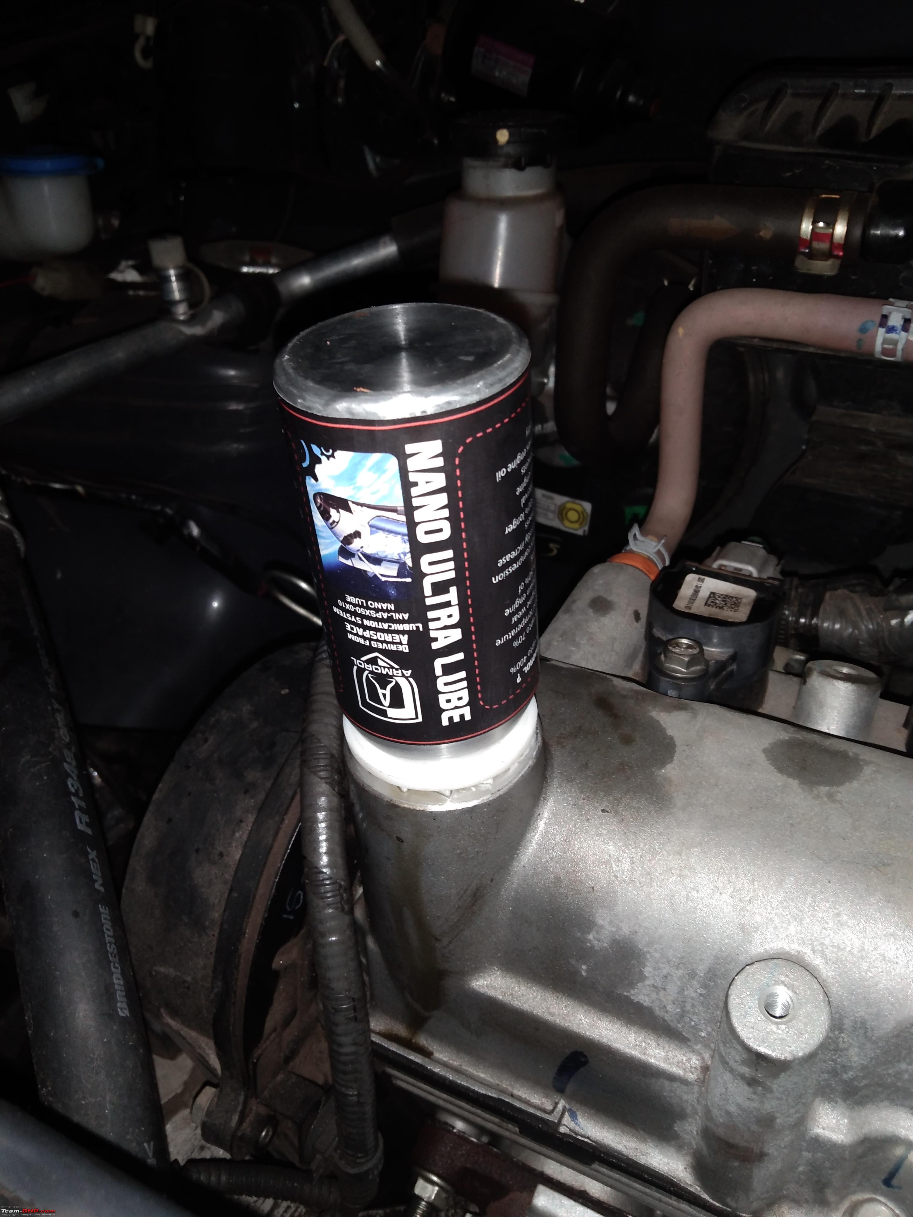

In short, all this company does is make some tall claims about the product, without substantiating anything. I say snake oil all over again.
Agree, completely nonsense. The silliest of their claims is about compression. Compression on any engine is fixed. Because it is directly and only related to the stroke and diameter of the piston. Nothing else.
I am getting tired of all these people claiming to have successful results without doing any proper measurements before and after.

As planned, completed the 20,000 km service today and tried the additive I mentioned earlier.
Drained a 100ml bottle into the warm engine.
Went for a 10 km drive to mix it in. I have a long drive to airport tomorrow. Will post if I notice any difference. As of now, the knocking when ridden in slow speeds with higher gear has reduced.
