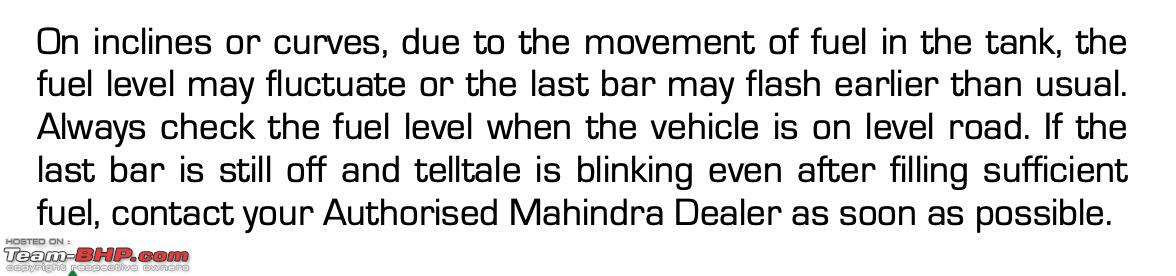

My October 2021 Thar Lx P MT has been giving me a headache regarding the fuel meter since the day of delivery. On partial fills(for eg ₹2000 or ₹3000), I get a little more than half a tank and DTE goes up to 250-300kms range but if I park my car on an ascend or a descent, the fuel meter goes up OR down depending on the way the car is parked and DTE has a mind of its own. It can go from 28 to 300 when it wants :Frustrati
Given that I am from a hilly town, we have traffic on slopes and even mid-traffic my low fuel warning starts chiming away after a fill up. I strongly believe it has something to do with the fuel sensor but I had it replaced during the first service and it still did not fix the issue.

This is what the manual says:
2nd-gen Mahindra Thar | Niggles, Problems & Solutions-screenshot-20220630-22.56.59.png
Attachment 2327657
Wow, didn’t think I’d get an answer so quick lol:
I need to make sure to go through the owners manual of every car i purchase. But it’s odd since I have never faced this with any of my other vehicles. Thanks anyway :Cheering:
