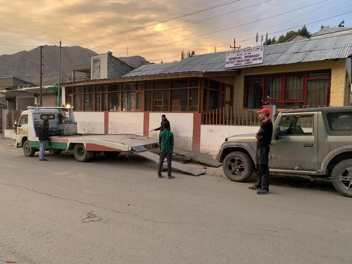

So our epic trip to reach Leh through Zanskar comes to an end prematurely. Why? Bhpian Slipstream11’s Thar choked up it’s DPF.
We completed the route (Shinkula- Kurgiak- Purne- Padum- Rangdum) but reached Kargil with the DPF sign and Check Engine light on.
After waiting for around a day and half Mahindra RSA sent a flat-bed to Kargil to pick the car up and send it to Leh. Thanks to them for at least arranging the truck.
But the overall experience has left a bitter taste towards BS 6 diesels and Thar in general. We have been planning this trip since 2020 and the Thar could not make it till the end. It’s like the 2020 Thar is not made for these terrain or rugged conditions. Perhaps it’s better to buy a petrol Thar and use it as a mall crawler.
Now the wait begins to get it fixed at Leh. Fingers crossed.
